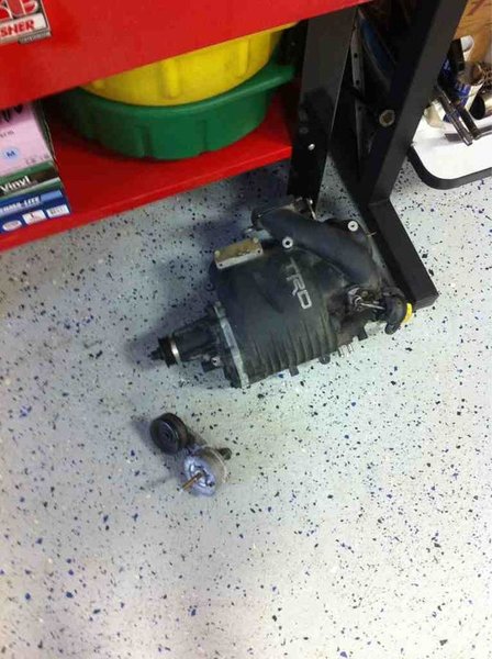

    i have a 3.4 supercharger for sale for 1,500 it has 40k on it perfect conditon

    couple more pics man, I'm actually interested in that

    I'll take more later for you. Pm me
