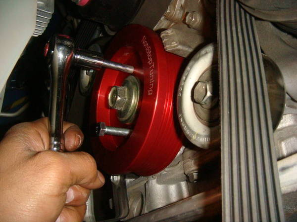

    This is a sweet Mod. Quality craftsmanship, about 50% lighter than the stock pulley, and install is some what a breeze with the right tools.
    Thanks to Mike from NST, and also Taco skim I was able to get under my Taco and wrench away.
    Install went like this:
    1) Remove OEM skid Plate (4 12mm Bolts)
    2) Counter tourqe the Tentioner (14mm Bolt turn Counter clockwise, and slide belt off. Place out of way from crank but keep it so that it's easy to route back into place).
    3) Thread 2: 8 x 1.5 x 50mm bolts into crank prepositioned holes. (This helps keep in place so that you may remove crank bolt).
    4) Use a 1/2" Breaker bar to loosen 22mm Crank bolt. (This was the toughest part. I actually broke my 1/2 socket adapter. That bolt is on their good. Had to go buy an actual socket that would fit the breakerbar, but oh well $10 @ Lowes and back in businness).
    5) Once bolts out, stock pulley slides right off. Clean surface, and prep for NST pulley. Apply a little grease, align key notch to key on crank, and start pushing. (It was tight, but with lite tapping w/rubber mallet, and a little ambition, it will get in just enough to thread in the crank bolt. Apply a little locktite, and thread in the bolt).
    Note: The Key notch is very hard to allign since it's inside the crank case. What I did was use an allen wrench as a guide. Also made a mark so I could line up. If done correctly the pulley will start to turn when contacting the case and will eventually slide right on to the knotch. You will know it worked once the pulley stays set.
    6) You will then feel the crank starting to turn. (Install the two bolts from step 3, and this will help give just enough resistance to tourqe down the crank bolt. There are a few different torque specs being thrown out there, so I went w/200 ftlbs).
    7) Next you retorque that tentioner and reroute the belt the way it was stock. Check to make sure nothing was missed, belts are alligned, and hell; Crank it up.

    Nice Pic, How did you find the space. I barely had room to seat the crank in, but i gots to say, Get Er Done...

    Once we removed the fan and the shourd and the grill we had plenty of room
