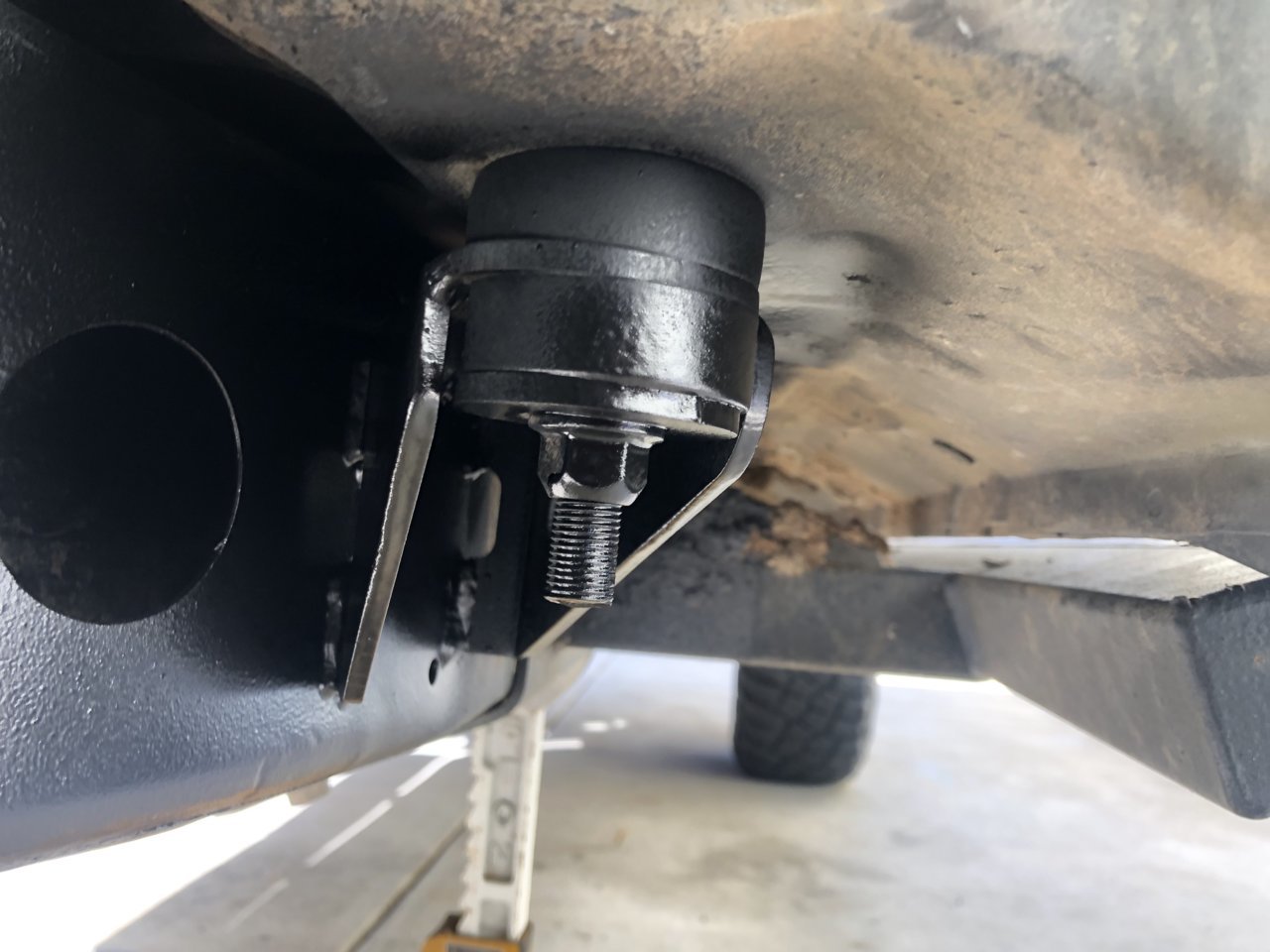

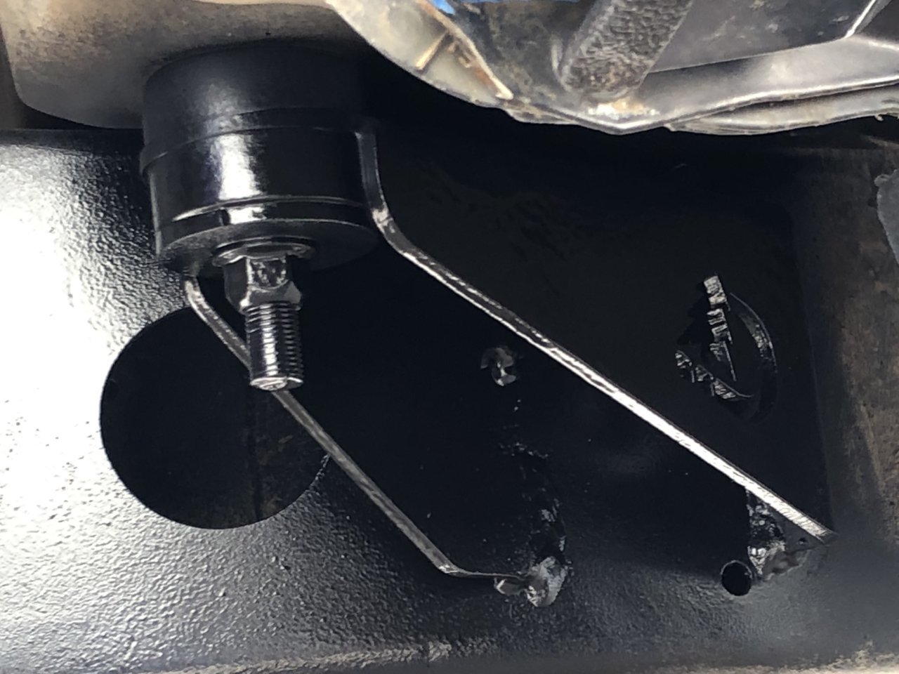

    Needed to go back and trim the cab mount again and ended up just relocating it. Figure one less thing if I go bigger than 35's. Tim over at Heavy Metal Offroad and Alpine relocates.
    20190323_173329388_iOS.jpg 20190323_175354935_iOS.jpg 20190323_231150478_iOS.jpg 20190323_231321669_iOS.jpg 20190325_190255000_iOS.jpg

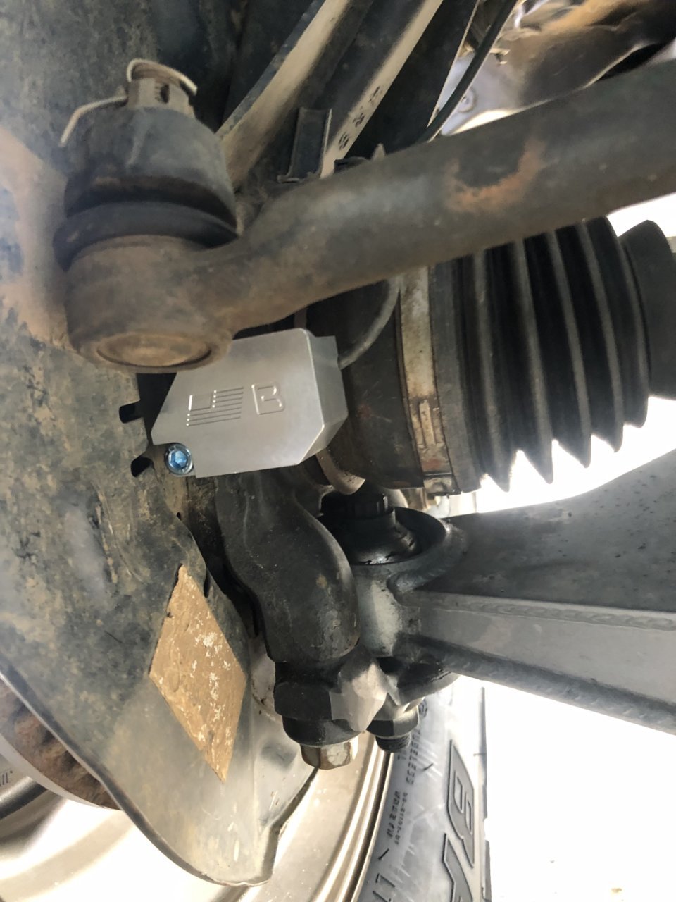

    Added some sensors covers from SDHQ. One less thing to worry about.

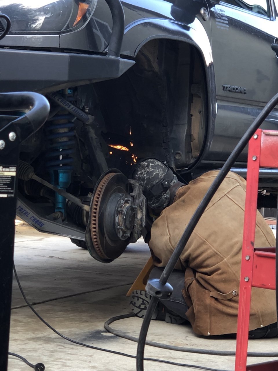

    Finally got the hoops installed and bypasses added. Milo with the welding skills

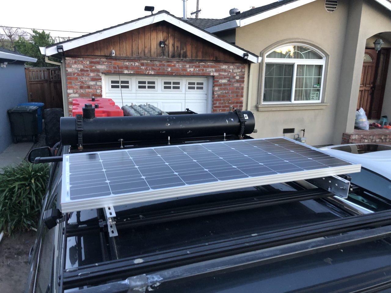

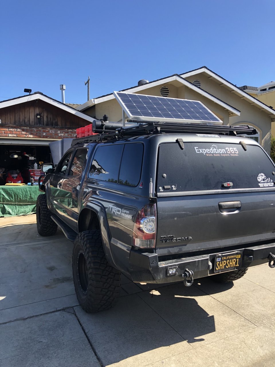

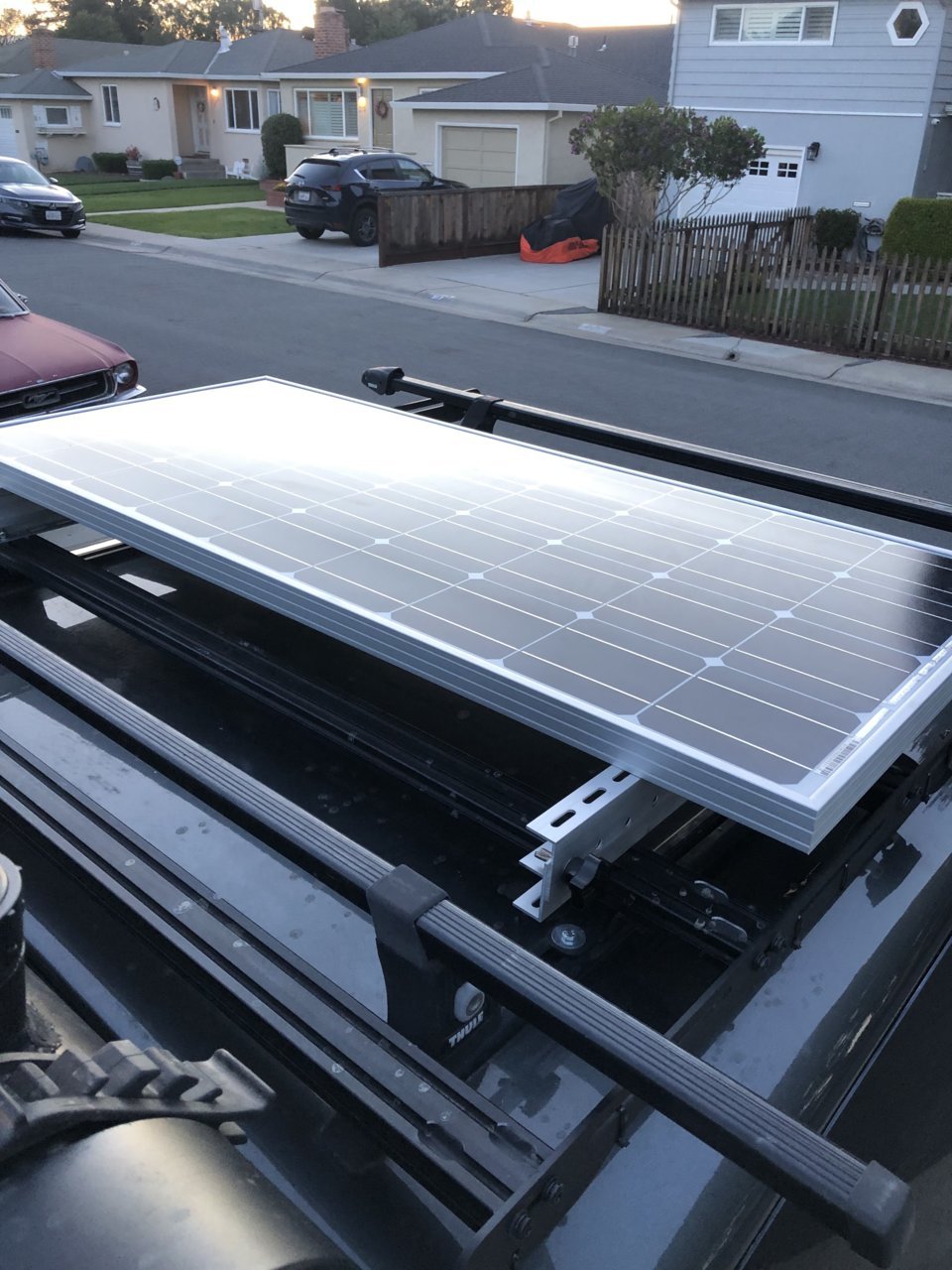

    Switched gears on my solar setup and went with a Renogy panel instead of the flexible panels I previously picked up. With the rack on the back the panels would be covered most of the time. Added mount to angle either side depending on the sun if needed.
    20190417_024422785_iOS.jpg 20190417_024431417_iOS.jpg 20190417_024447547_iOS.jpg 20190421_230755249_iOS.jpg

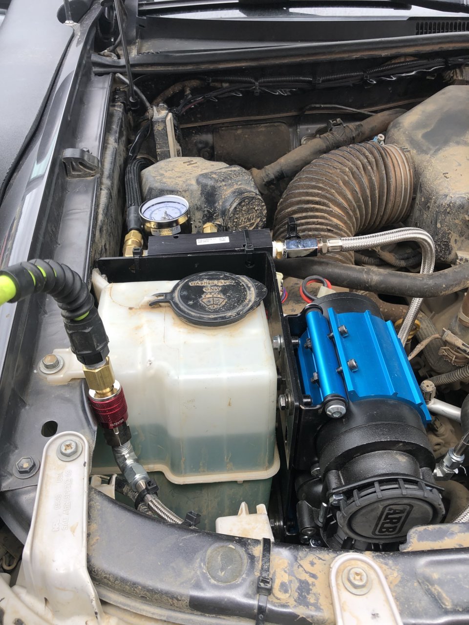

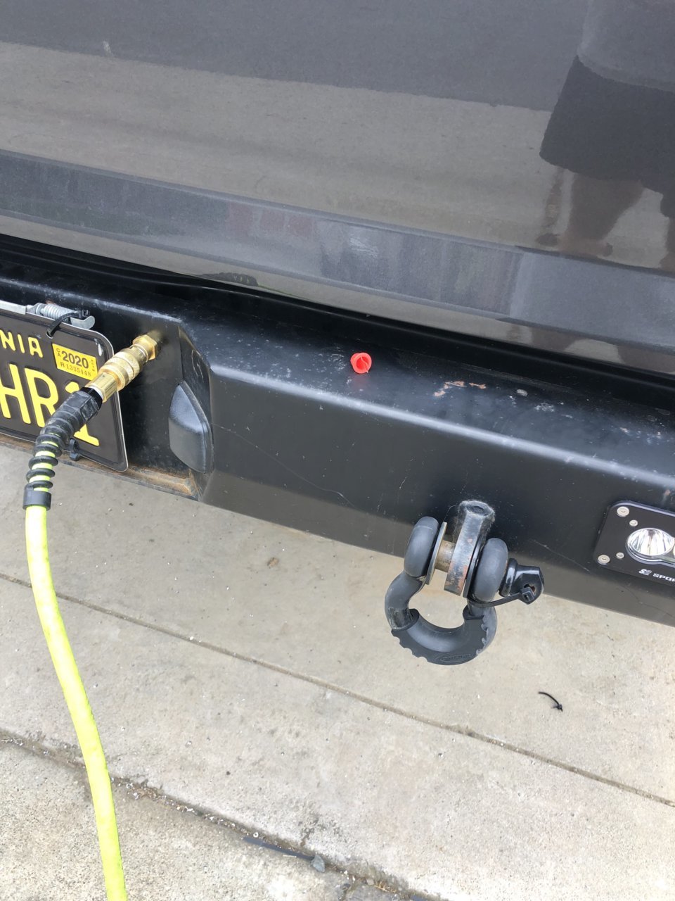

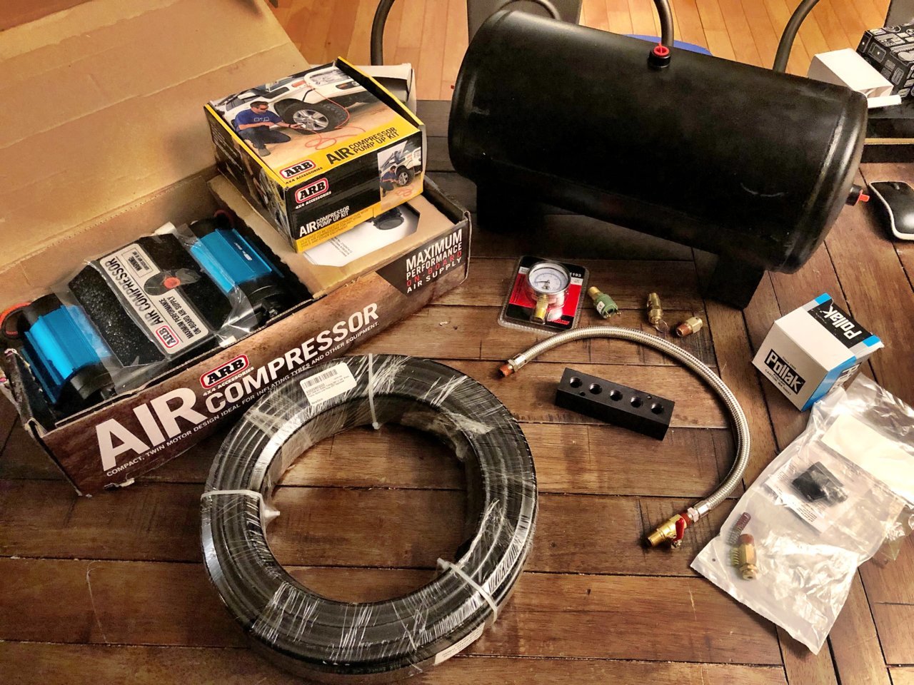

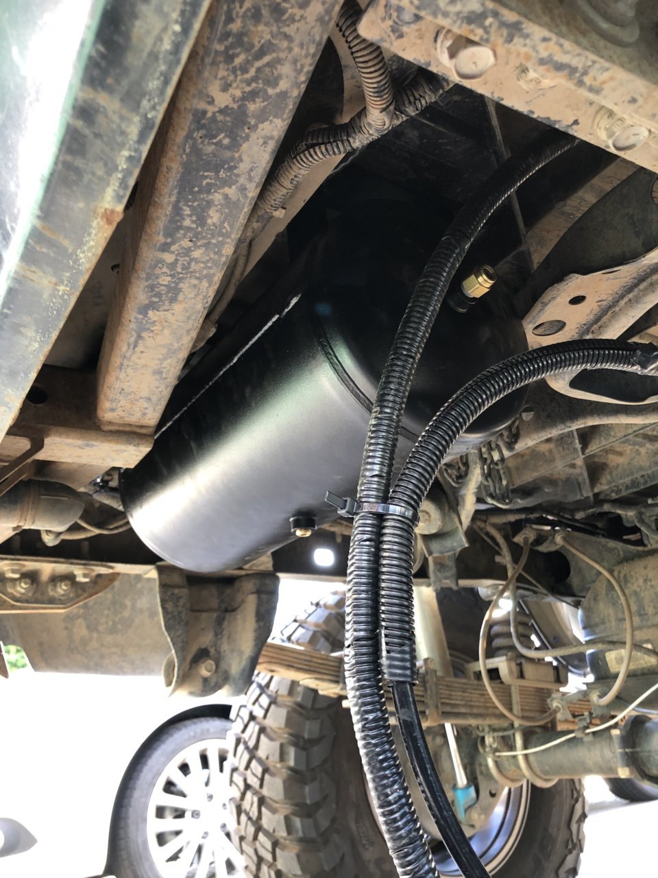

    Mounted compressor and 5lb tank setup with bumper mounted hookups. Able to access front or rear. Ran manifold additional options. Was going to go with a home build wifey setup but changed it up.
    20190425_061030197_iOS.jpg 20190510_153745375_iOS.jpg 20190511_000328516_iOS.jpg 20190511_011524928_iOS.jpg 20190514_191543255_iOS.jpg 20190514_191801275_iOS.jpg

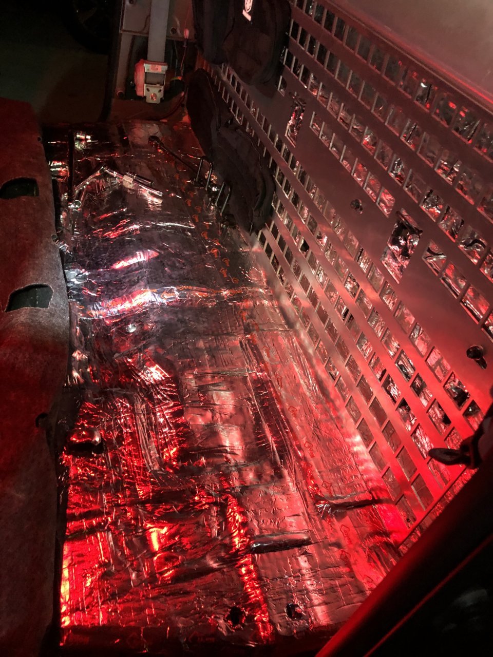

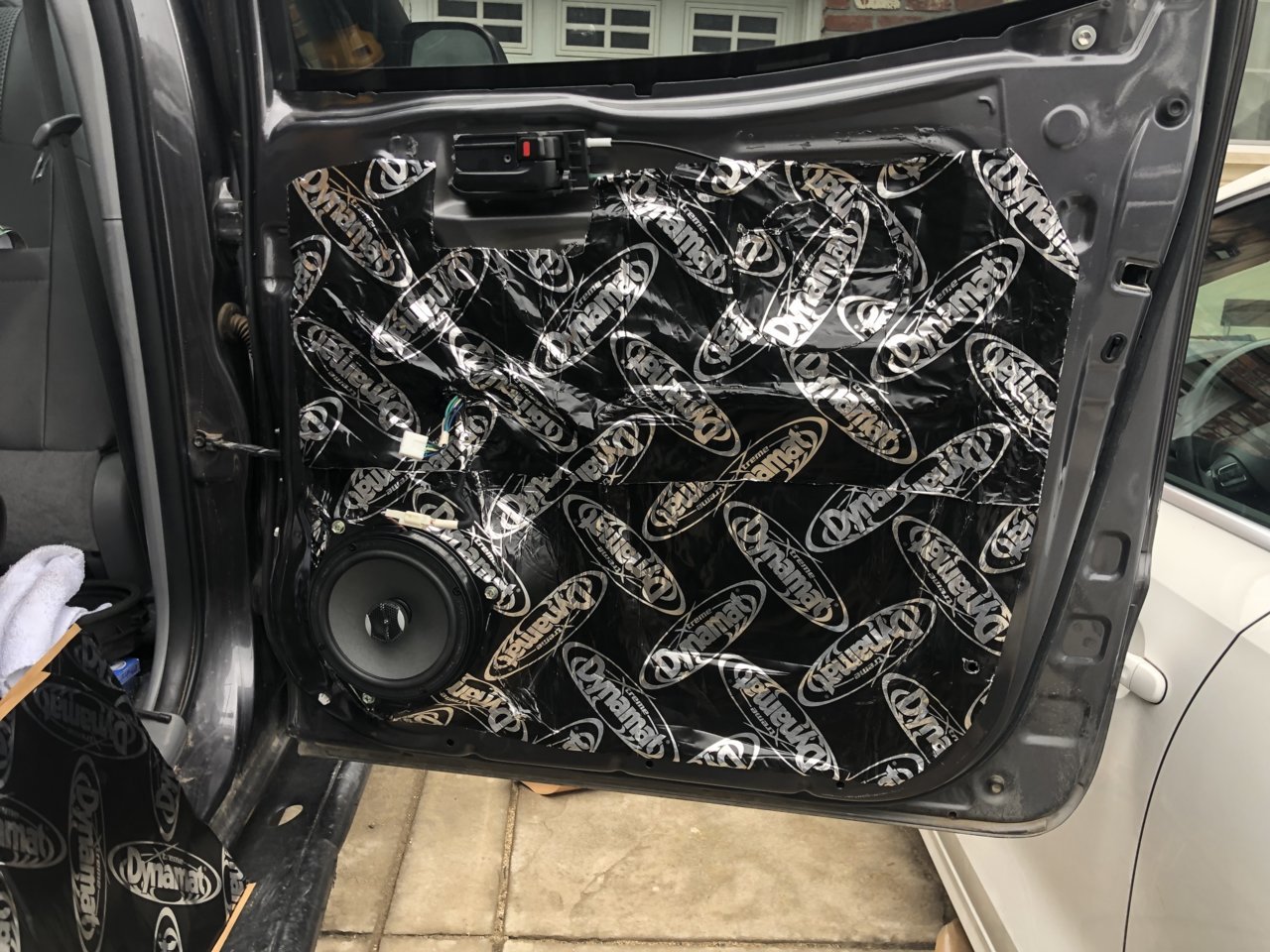

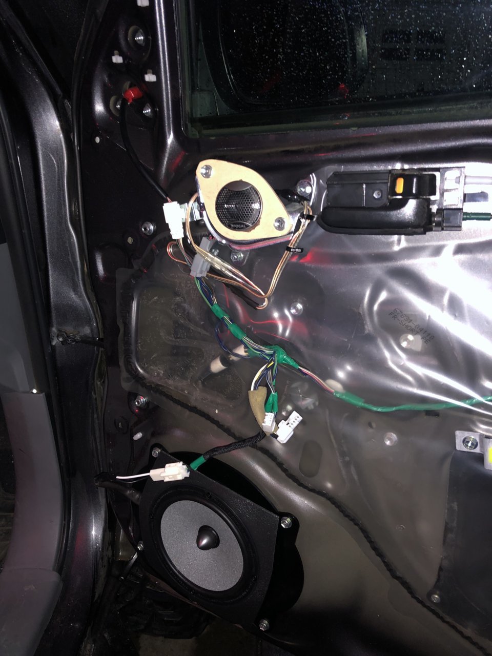

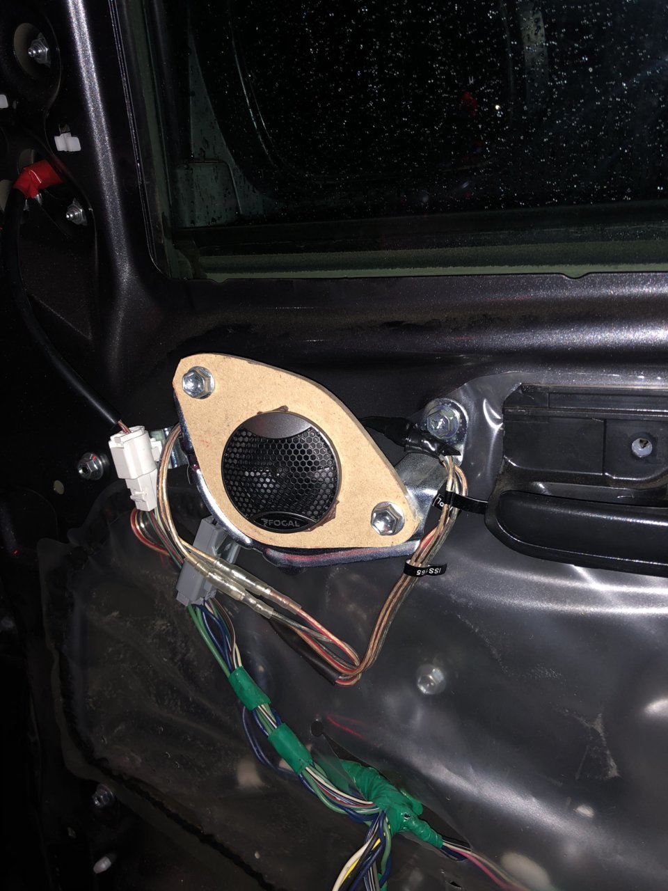

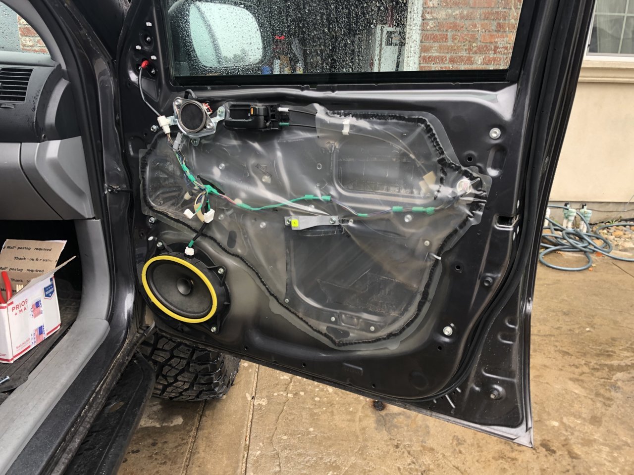

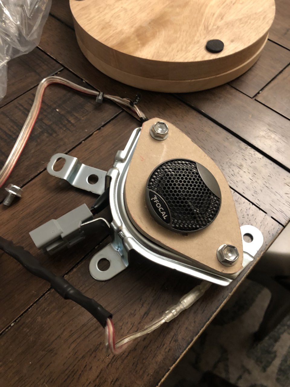

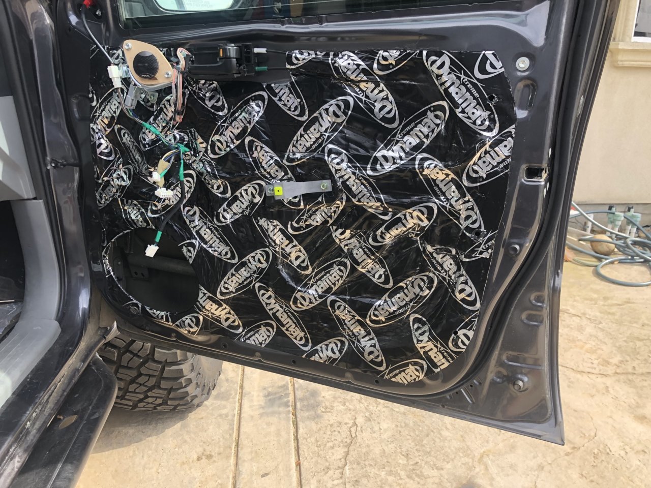

    Scored a deal on some New Focal Front/Rear Door speakers and Dynomat. Dynomat came second as the new speaker were not picking up much mid/low. Dynomat improved it dramatically. Still needs more power.
    20190327_054531389_iOS.jpg 20190327_060418594_iOS.jpg 20190325_225734373_iOS.jpg 20190327_060422567_iOS.jpg

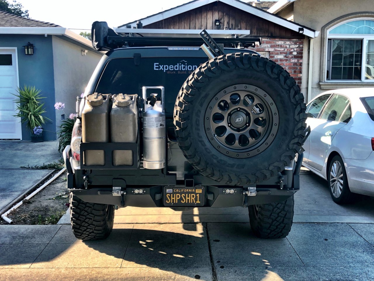

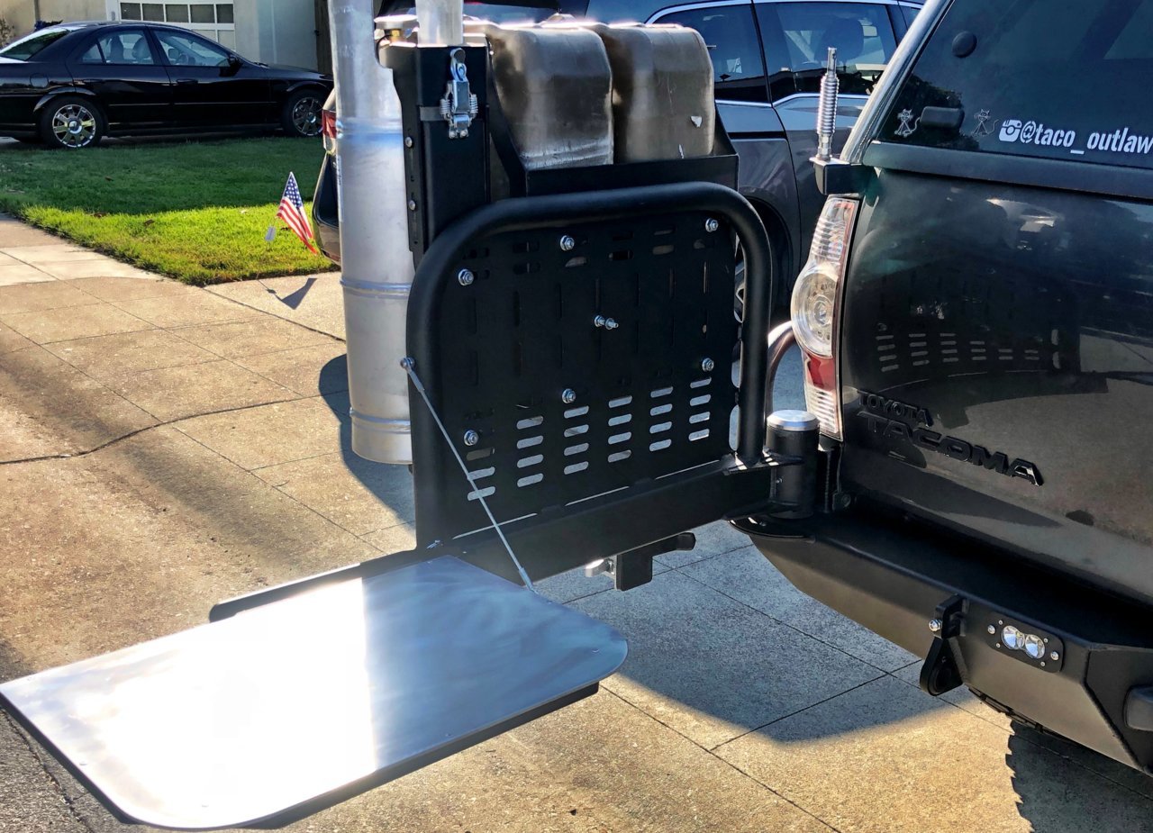

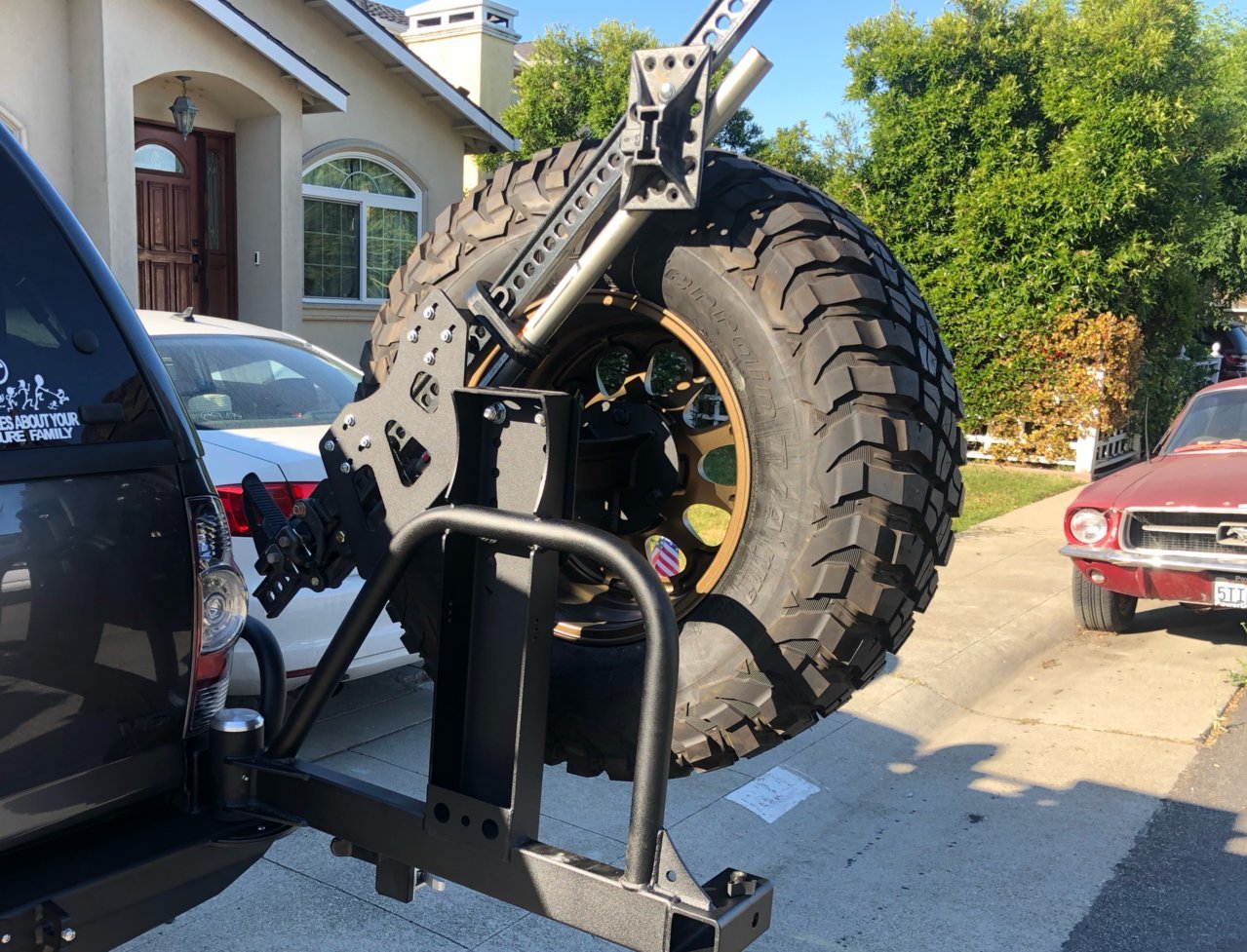

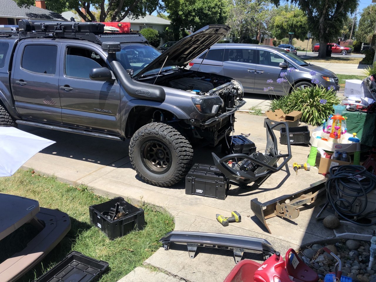

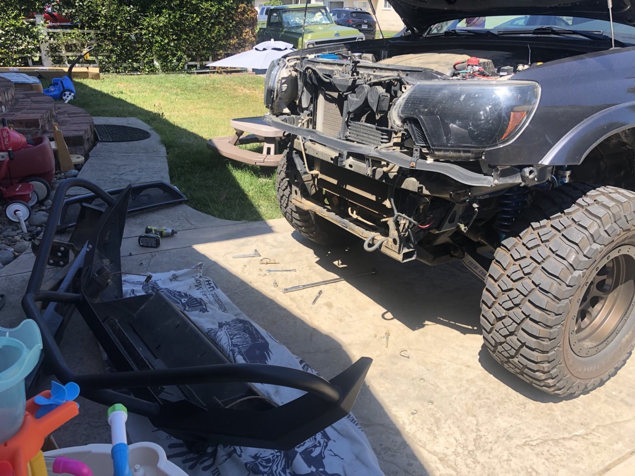

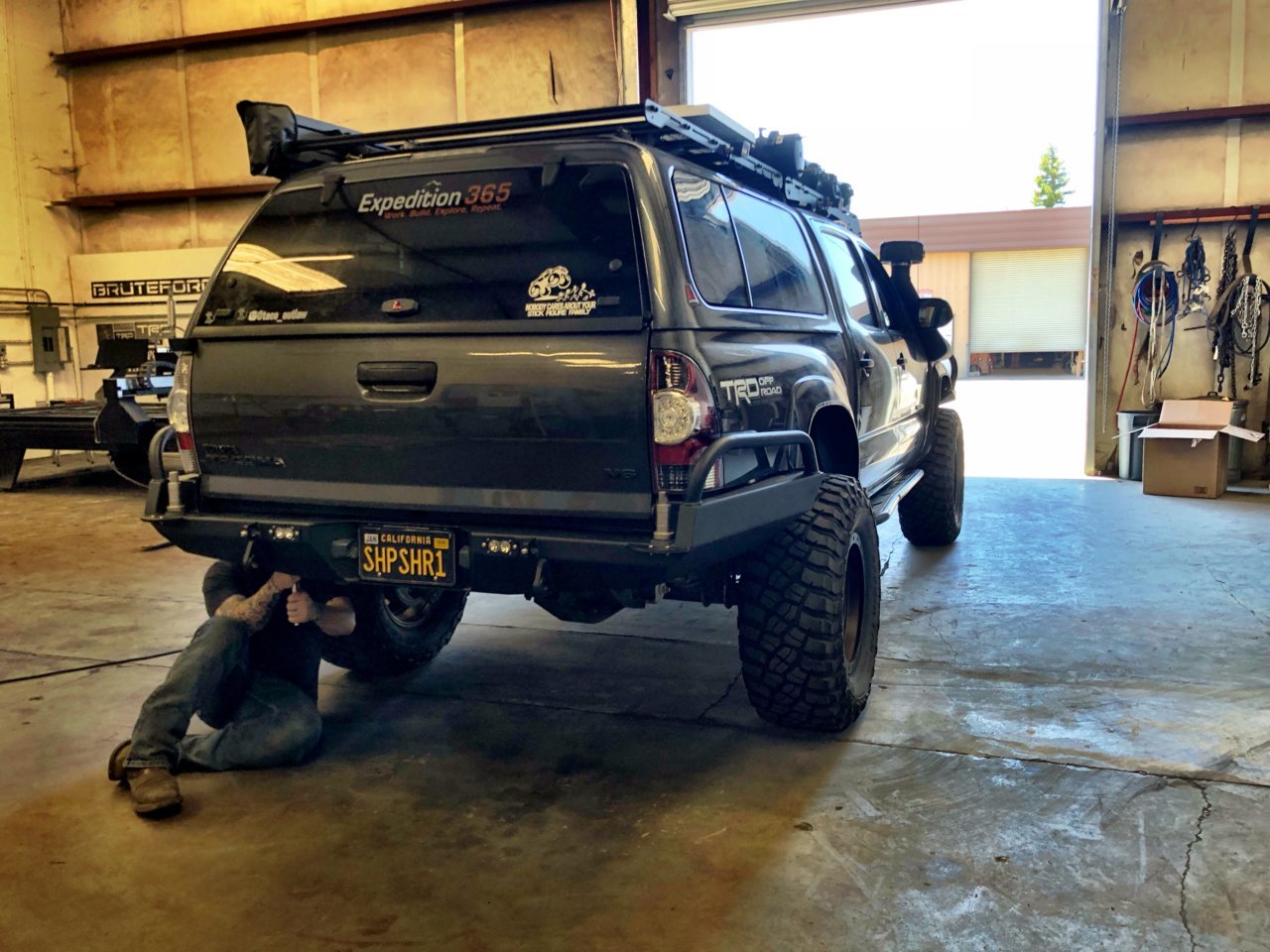

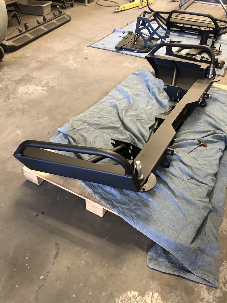

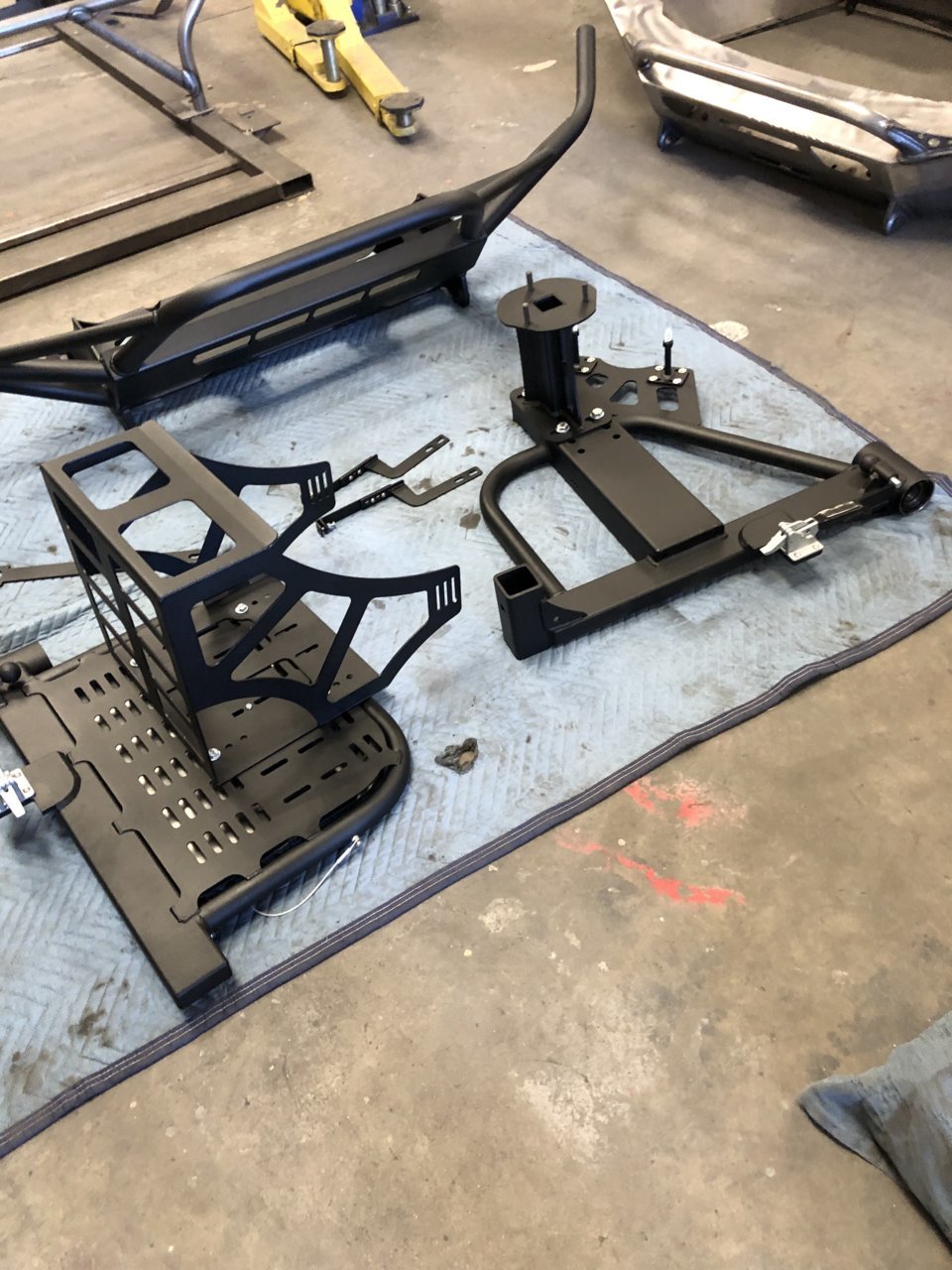

    Swapped out standard rear Pelfreybilt bumper for updated Bruteforce Dual Swingout w/ Table, Dual Jerry Can mount, Bruteforce propane mount (pretty rad mount) and secondary hitch for bike racks etc. Billy got it done just in time for trip out to CO for FJSummit.
    20190629_172905570_iOS.jpg 20190629_172912602_iOS.jpg 20190629_180002470_iOS.jpg 20190629_210639171_iOS.jpg 20190629_184506626_iOS.jpg 20190630_151921732_iOS.jpg 20190630_152112854_iOS.jpg 20190630_152118912_iOS.jpg

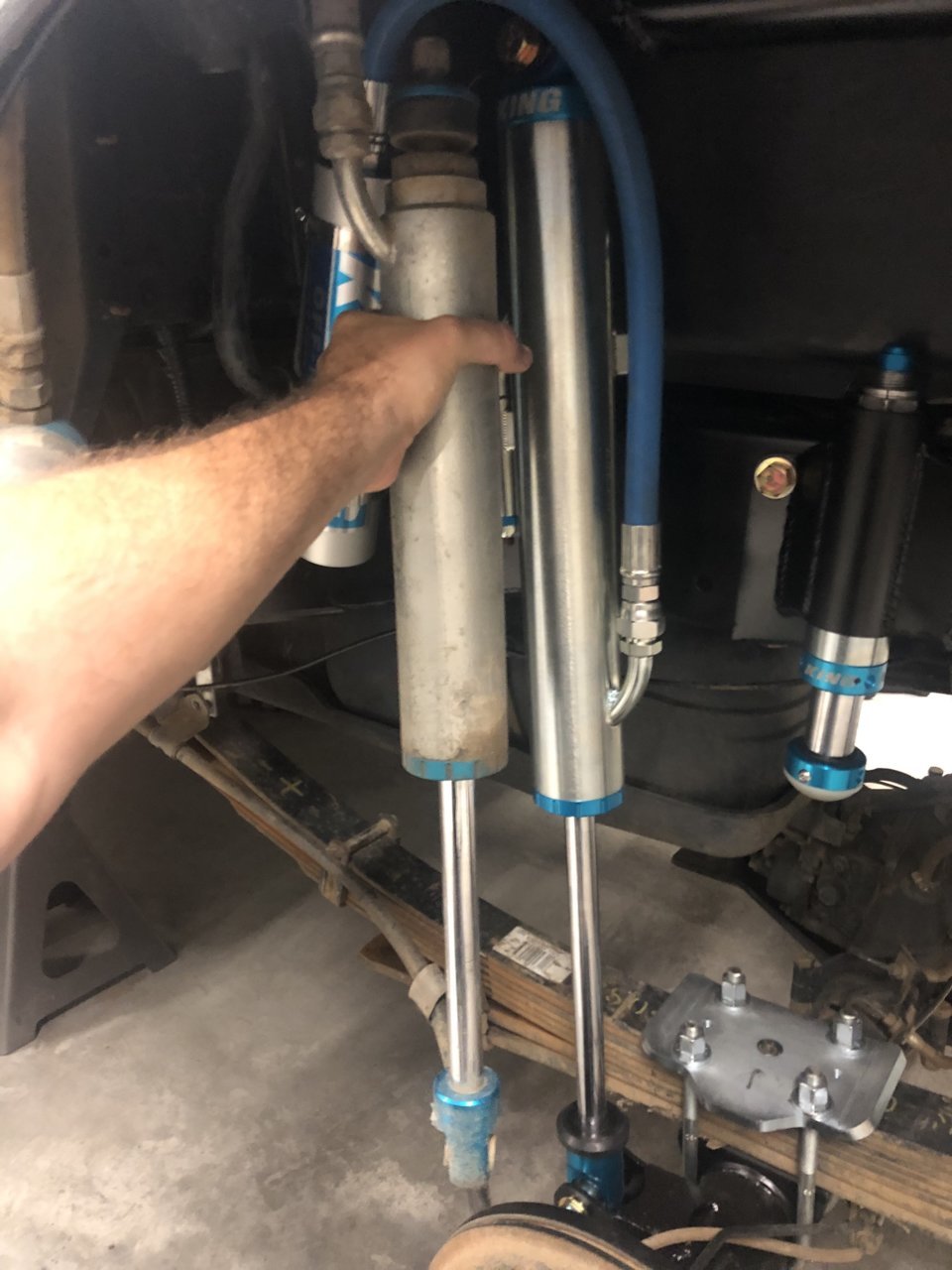

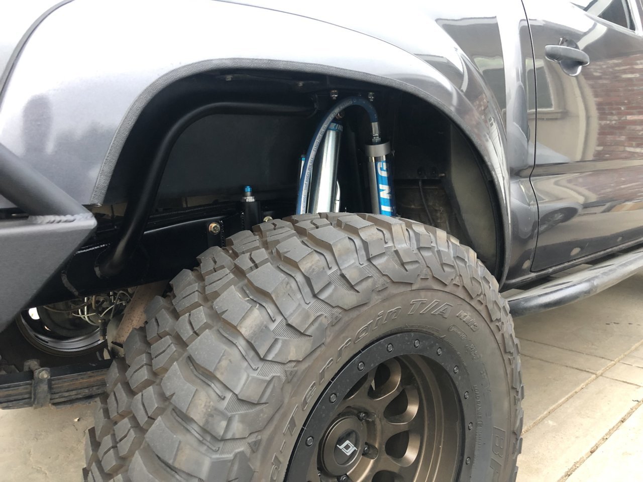

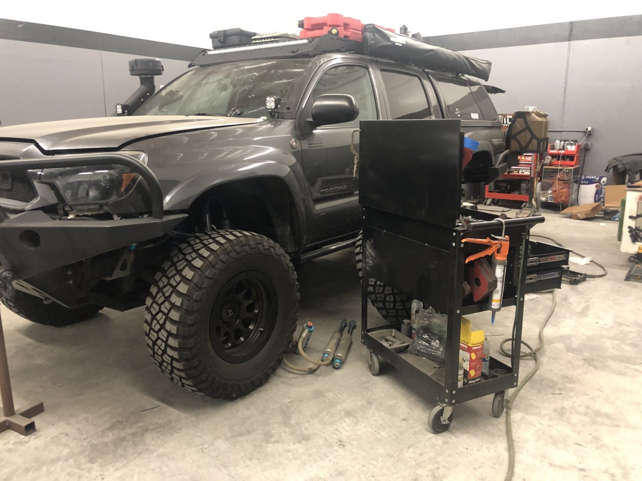

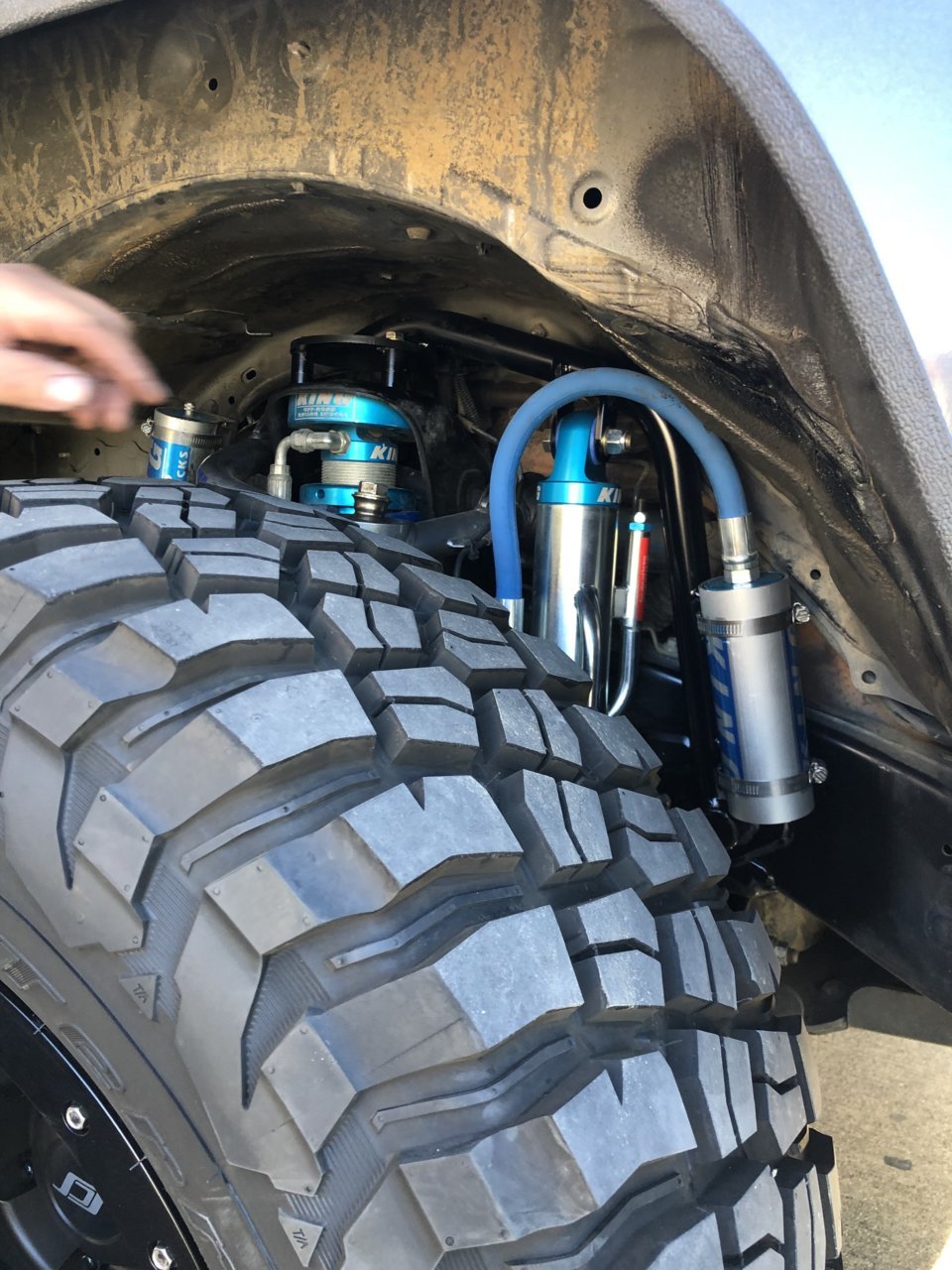

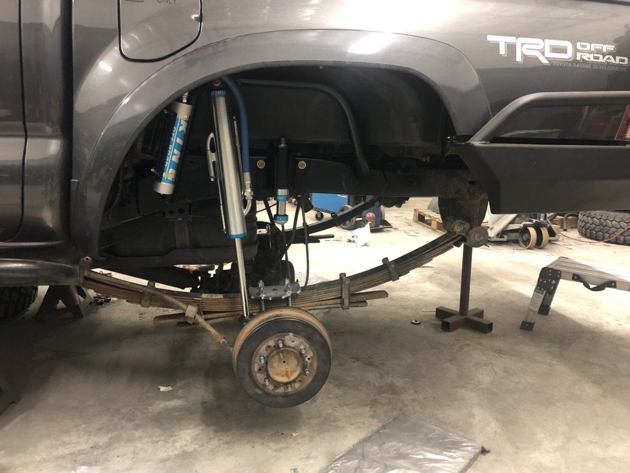

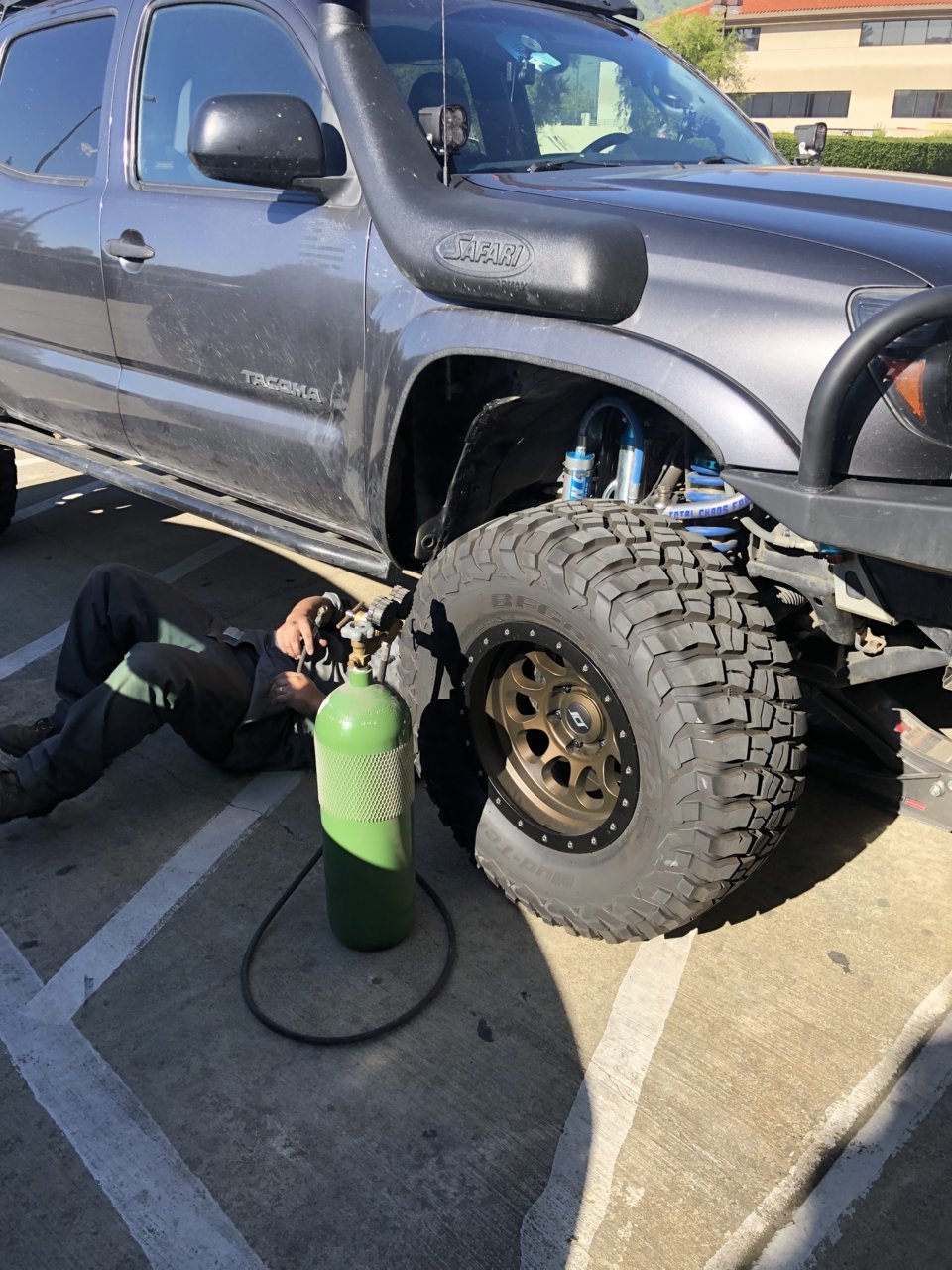

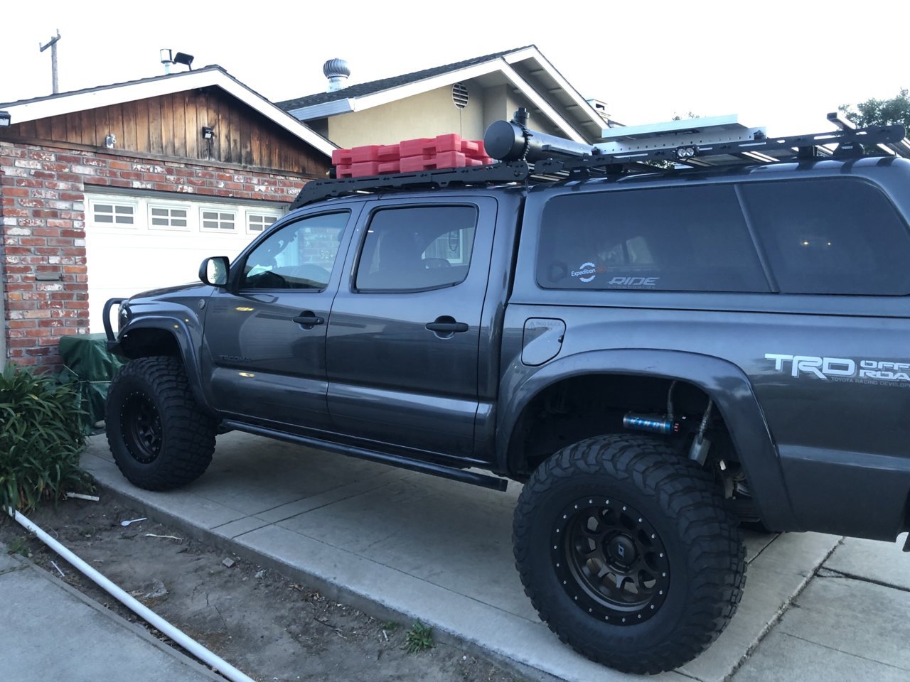

    Truck was back at Milo's for custom shock relocate paired with 12" 2.5 Tripple bypass shocks with 2 x 2" Hydro bumps. Had the bypasses on a custom layout for clearance reasons. Most people go 3 forward but going 2 forward and 1 back gave it a more flat layout. Came down to the wire but got it wrapped up the day before heading out to CO. Need to get it back for bracing and limits straps but she is ready to roll.
    20190701_154937982_iOS.jpg 20190710_013404688_iOS.jpg 20190710_013354428_iOS.jpg 20190710_013423831_iOS.jpg 20190710_032209982_iOS.jpg

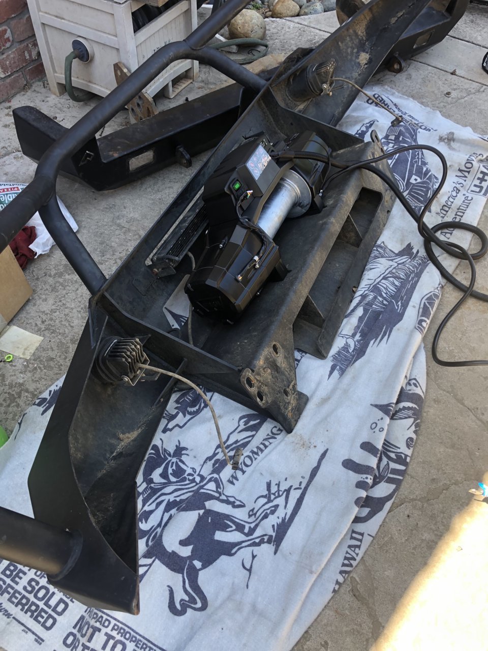

    Finally got enough together to get the winch installed. Scored a sweet deal on the Platinum so went big on the winch. Had to hack off part of the bracing to fit it without relocating anything. Brace was mostly for the stock bumper and grill so easy fix. Warn 12-SP savage winch. Really digging the remote it comes with.
    20190627_232400012_iOS.jpg 20190630_180359739_iOS.jpg 20190630_181018054_iOS.jpg 20190630_212222334_iOS.jpg

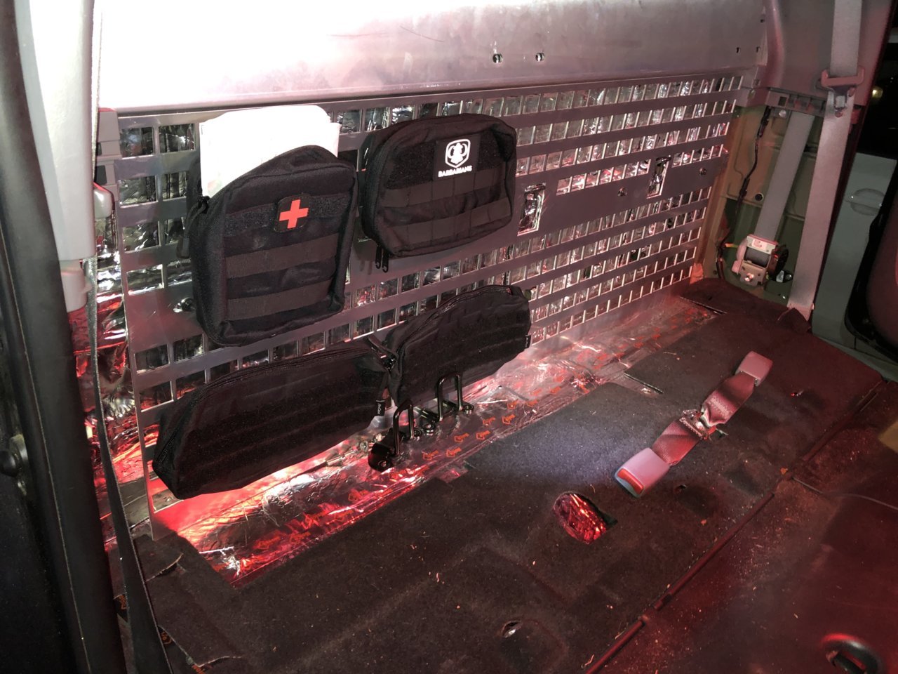

    Also finally got around to installing the molle panel installed behind the rear seats. I have had this sitting in the garage for almost 2 years. Craigslist score. New never used. Took a bit of hacking to install as the holes did not line up perfectly. Added some additional Noico sound deadening (should have got black but did not realize they had it in black). Chose Noico from reviews and cheaper price point than the Dynomat used for the speakers.

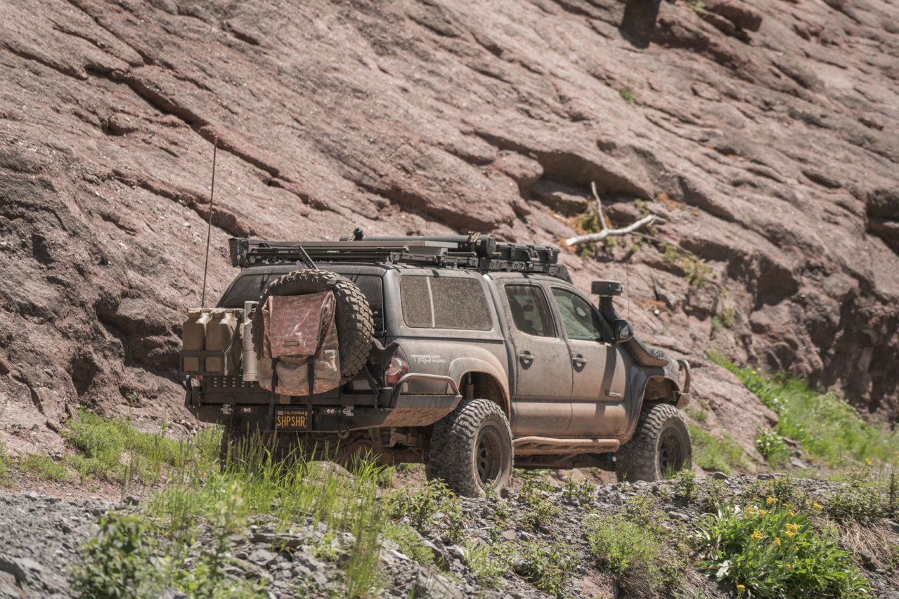

    A few quick shots from our trip out to Ouray. too many to post so they will trickle in. Most trails were closed or just opening in Ouray so we hit up what we could. Some damn gorgeous views in CO. Can't wait to go back.

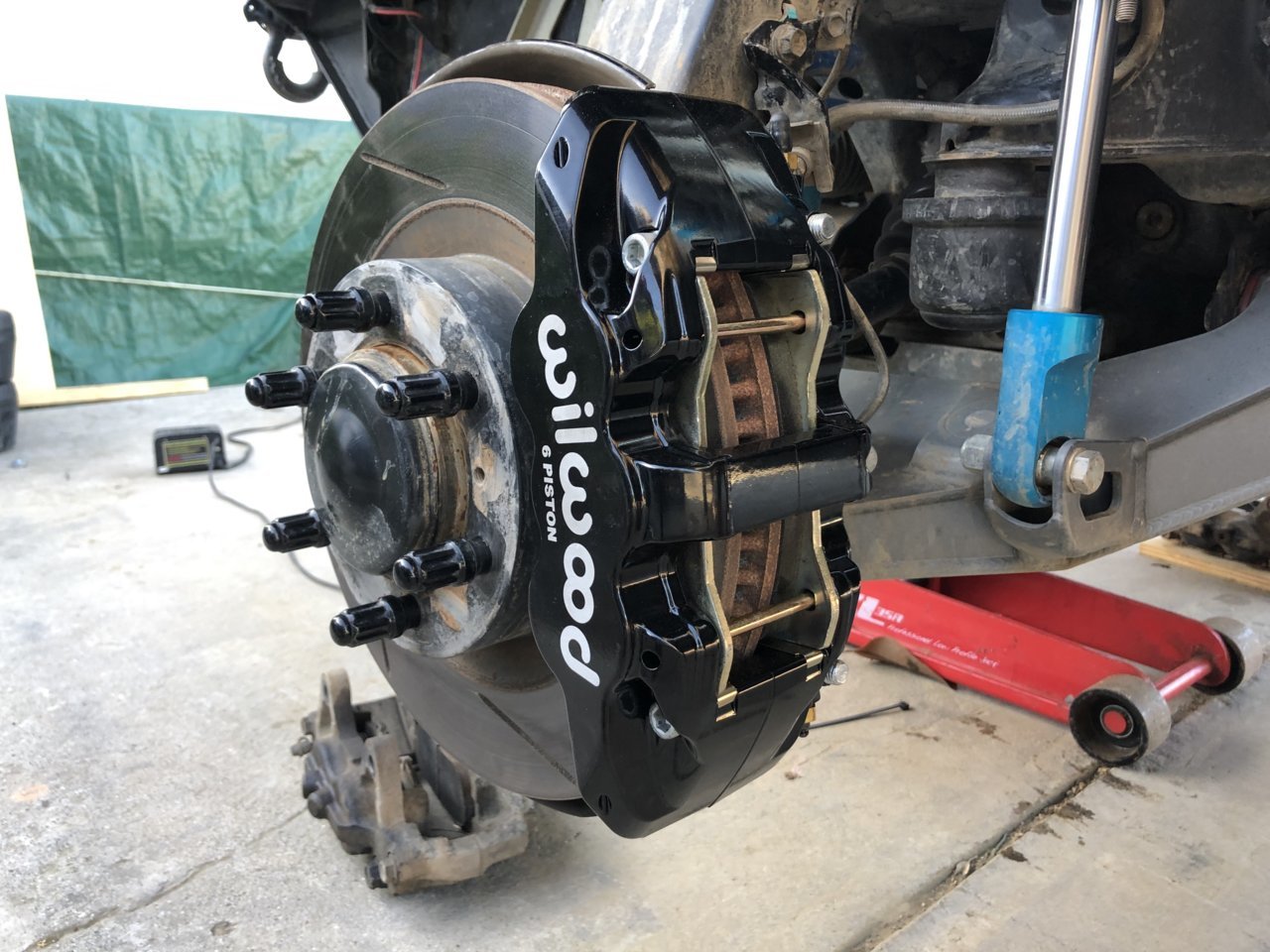

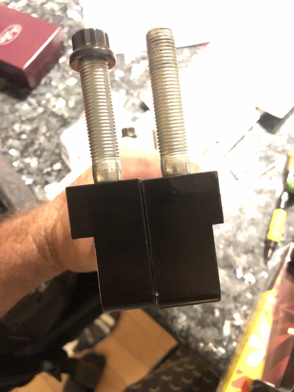

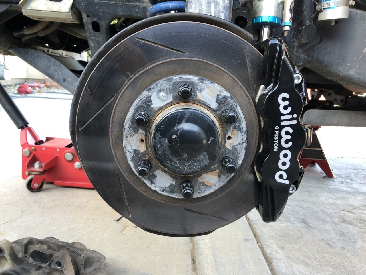

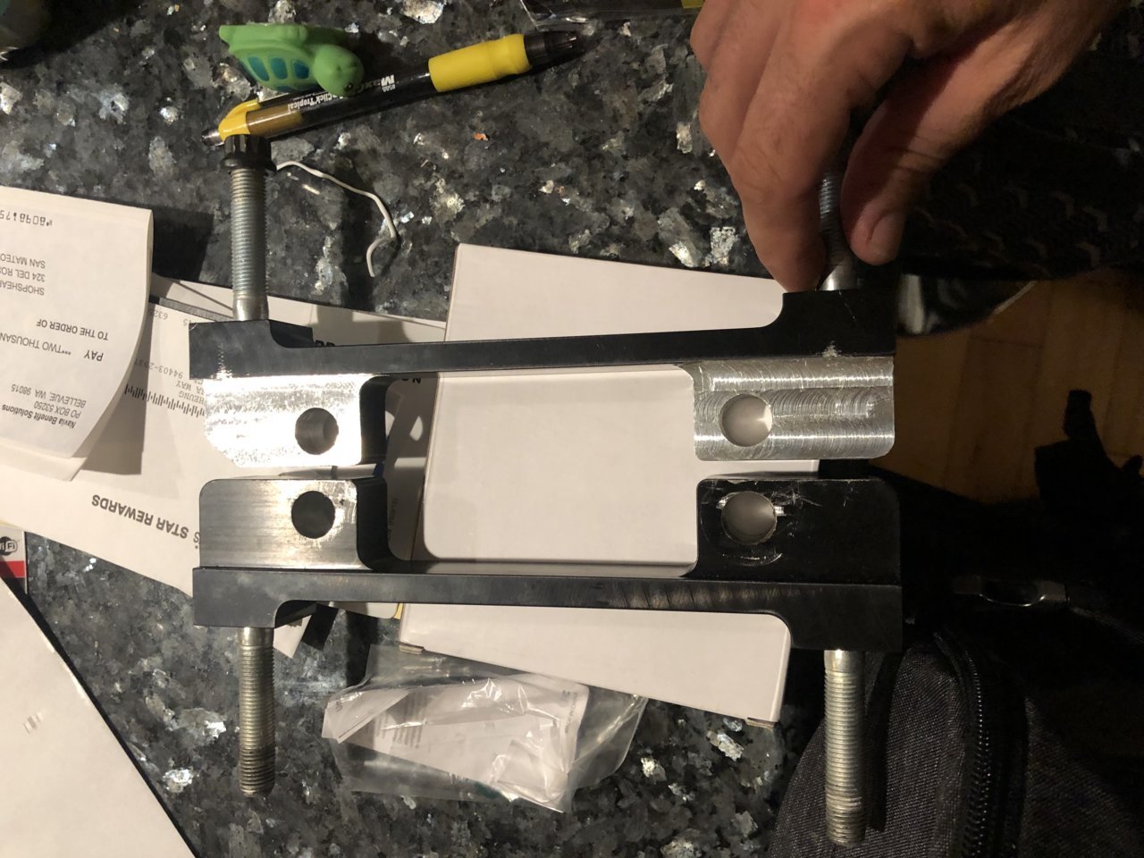

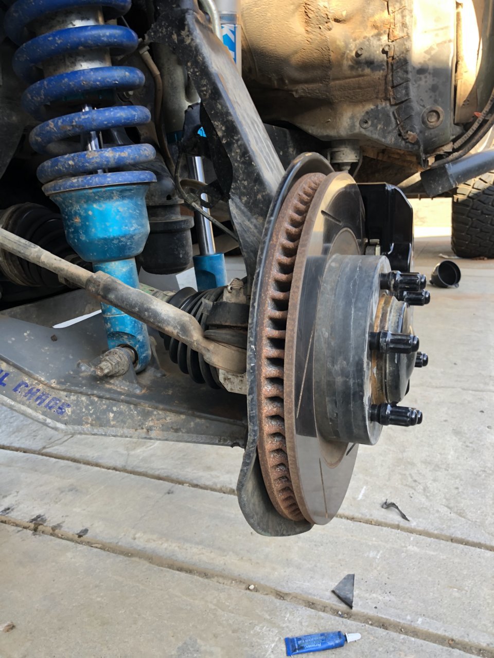

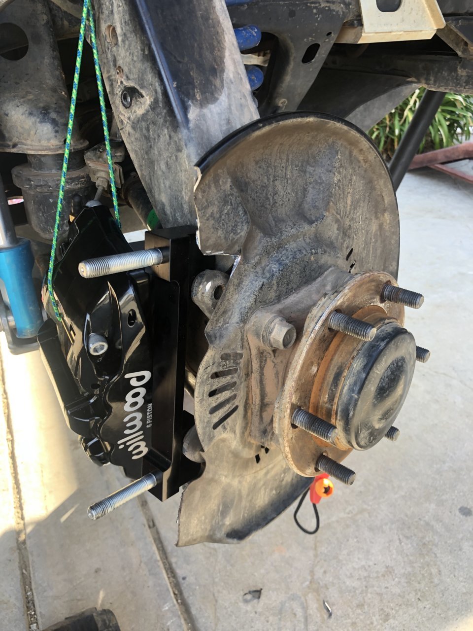

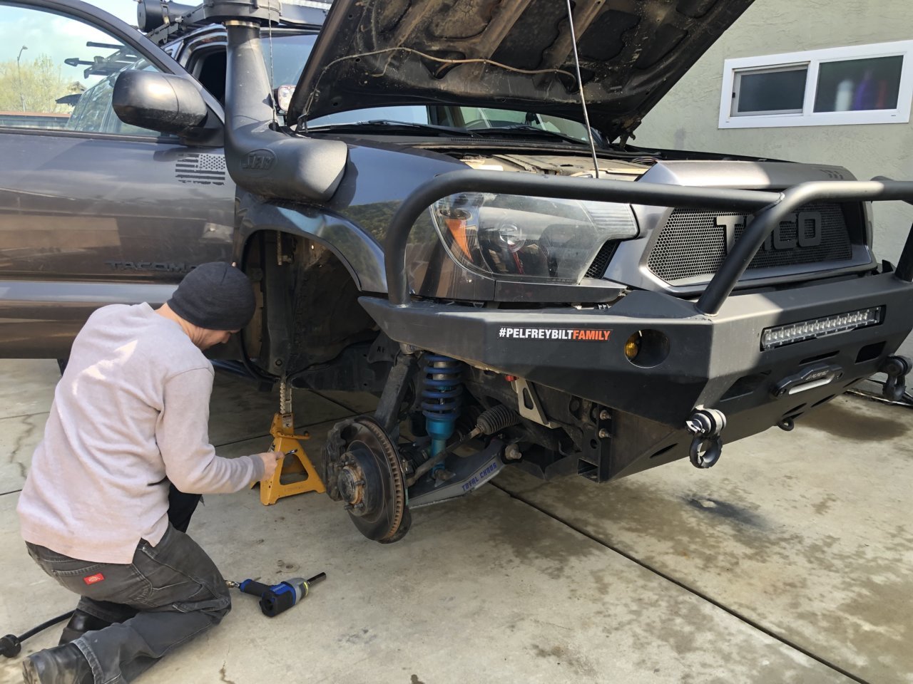

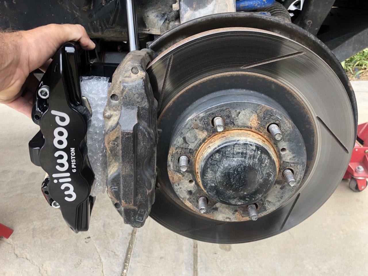

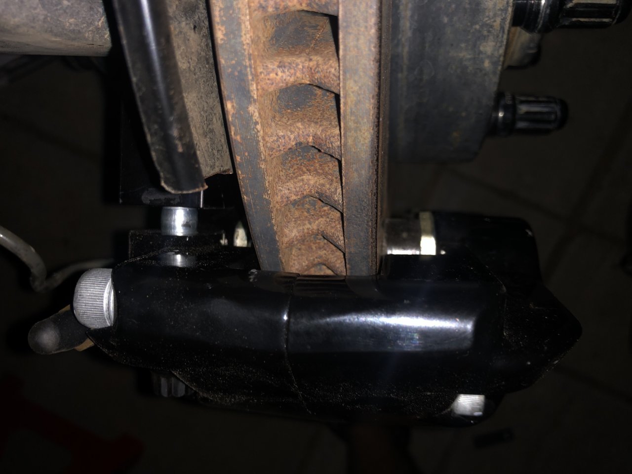

    Got the Wilwood Calipers installed from RR Racing. These use OEM sized T4R rotors which I was already running. Swapped out the 5th gen T4R calipers for Aero6-DS calipers (adds an external dust shield for better dirt protection). 338mm vs 340mm in the standard BBK kit. Any issues will be easy to swap the rotors out. Still needs a good bedding of the pads but a noticeable difference. Nothing crazy but truck feels like it can stop again with massive tires and tons of armor. Was hoping to have them installed prior to the trip but did not arrive in time.
    Ended up having the truck on jack stands for 3 weeks due to the adapters being off. the non DS calipers and DS calipers are the same on paper but are incorrect so the adapters needed to be adjusted. RR Racing was solid and got it updated and shipped out.
    Still have some new DBA 4000 T3 rotors on order but they are sold out and on back order. Should have them in a couple months. The Stoptechs are still in great shape.
    20190820_153939739_iOS.jpg 20190822_052950393_iOS.jpg 20190822_160544757_iOS.jpg 20190909_075715426_iOS.jpg 20190911_033352213_iOS.jpg 20190911_035857261_iOS.jpg 20190911_040008554_iOS.jpg 20190911_040008554_iOS.jpg 20190911_154148320_iOS.jpg 20190911_154143588_iOS.jpg 20190911_154139302_iOS.jpg

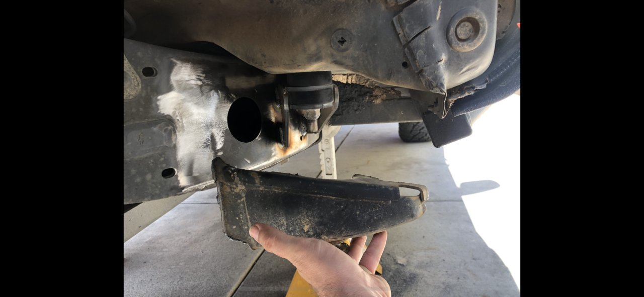

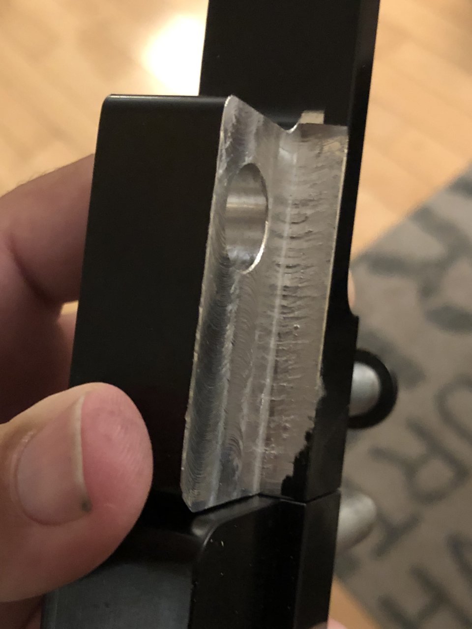

    Came back to the truck after a quick park session with my Son. First thougth was I had not tightened the bleed nipple enough on the Wilwoods. I guess the silver lining is I was able to drive home but damn. Parts are on order and bypasses are off the truck for now. No big trips planned so the re-valving o the front coilovers is ok for now.
    0A7E4609-A786-4DA1-A651-C76ABE1C1D78.jpg 3F4D4FC2-93C0-41CA-BAC9-4A1B914FFB92.jpg C9A3CF59-DC41-4975-A86B-2E273ED63381.jpg
