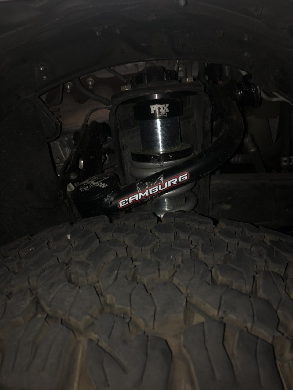

    Backing out of my parking spot and my tire caves in. I get out and see my front right side control arm has basically snapped off on both ends.
    Stuck out here in Vegas and I guess I’ll have to wait on a new part for the time being. Sucks. Now it’s just sitting in the parking spot until tomorrow when I try to figure out what to do. They’ve only been on since April.

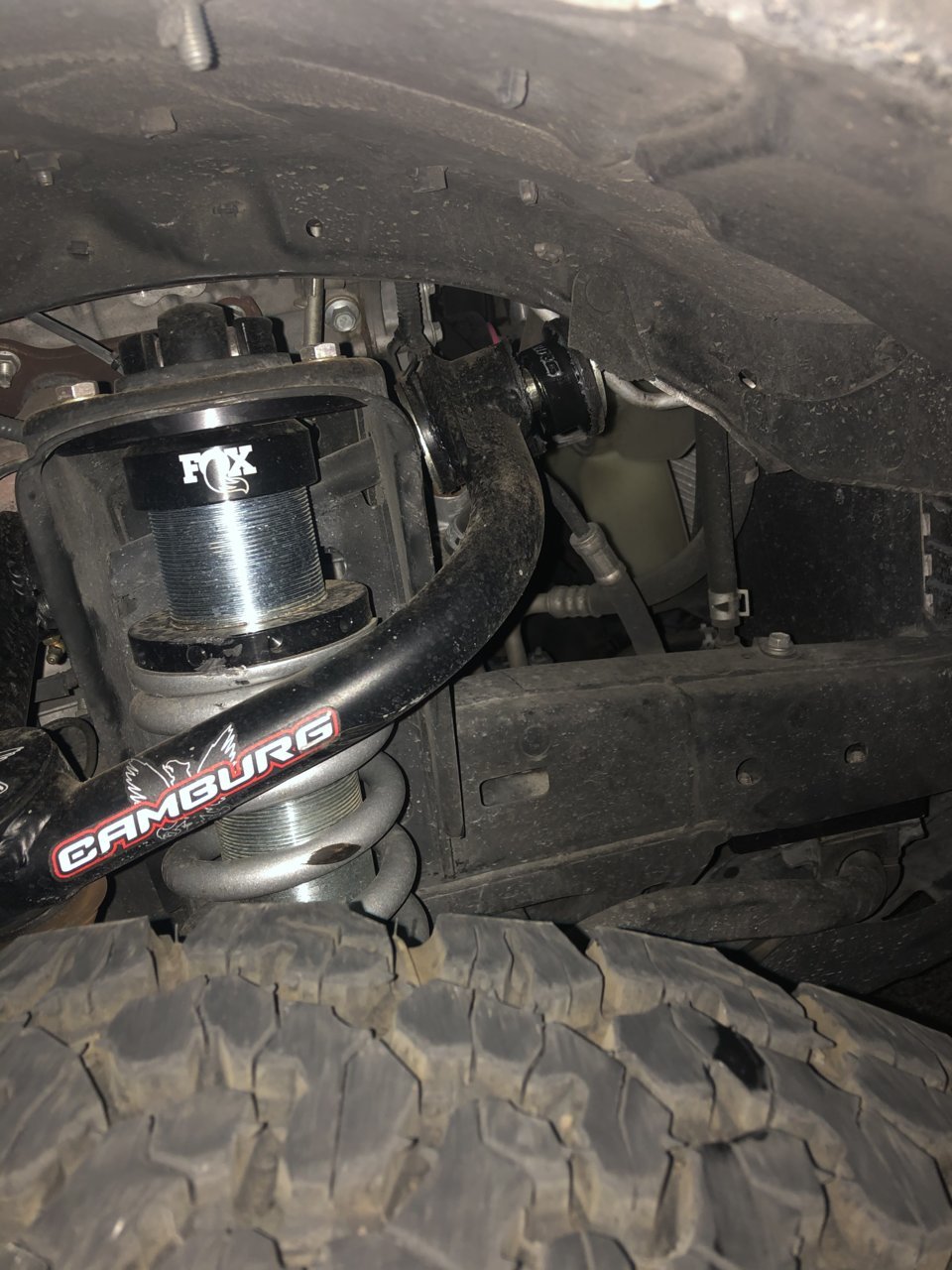

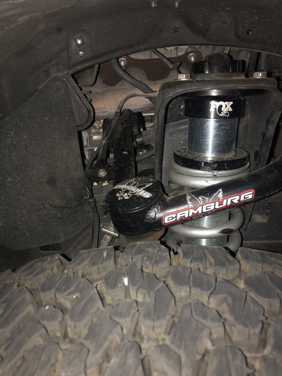

    It's difficult to tell from the picture, but it looks like your UCA bolt sheared causing the UCA to become detached from the truck, not the control arm itself failed.
    What did you torque the nut on the control arm bolt?
    Update: Looks like the nut came off and the bolt backed out.

    Yep, looks like no fault of Camburg at all.
    Either installation/user error (not torqued, not checked after install, not appropriate thread cleaning/locking)
    OE just a failed UCA bolt (unlikely).

    Yeah, after more thought and inspection it doesn’t look like camburgs fault. It looks like the bolt. I had a shop put them on. They didn’t get torqued down after driving for awhile and I’ve put about 1000 miles on them.

    The bolts not broken. The nut backed off. The right side busing backed out. That allowed the left side to slip off. Two washers, a new nut, and 30 minutes and it's driveable.

    That’s exactly what happened and what I’m going to grab tomorrow. Thank you!
