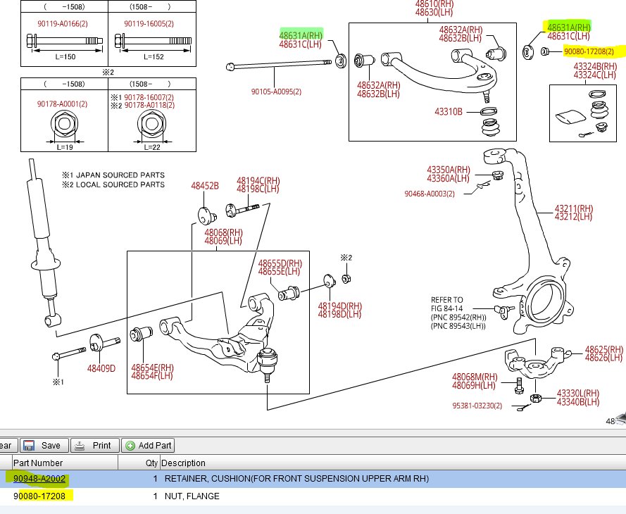

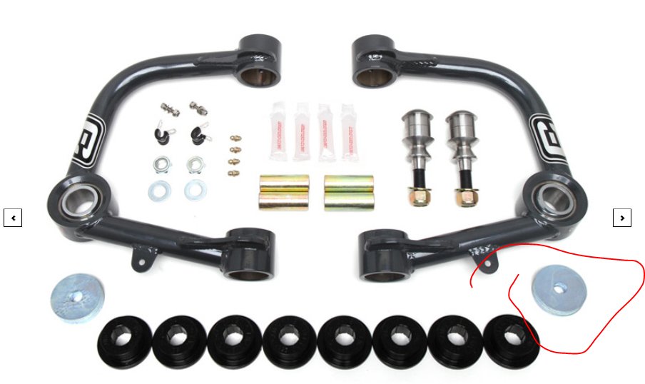

  15. Jun 11, 2020 at 6:58 PM
    #35
    BillDaCat8
    BillDaCat8 Well-Known Member
    Jun 25, 2017
    #222348
    1,915
    Jake
    PHX
    07 4x4 Access Cab M/T
    My shit is all stock.
    Local dealer there in Vegas should be able to get you the parts overnight. Try Centennial Toyota.
    If you haven't ordered already...
    Looks like Camburg uses a flat washer on either side of that bushing. Probably can find something that would work at a local hardware store. So ignore the "retainer" part number I posted above.
