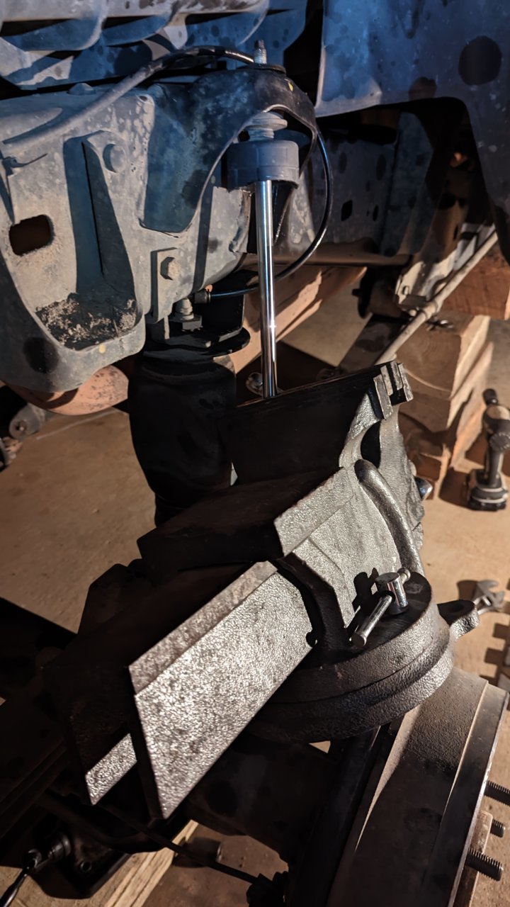

    I had this issue and found a video that suggested using a vice. While I had the struts off the front this worked by tightening the vice onto the flat surface of the top of the shaft. So when doing the rears I exposed the shock stanchion and gripped it with the vice. First time posting so I'll see if I can upload the photo.PXL_20221029_025649605.jpg PXL_20221029_025639163.jpg
