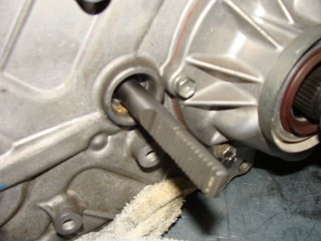

    Any one ever have the 4lo light flash and it unable to go into 4lo?

    If you drive a manual it's usually because the clutch isn't fully pressed. Mine has to hit the floor before it'll engage

    It's all the way to the floor. I'm able to hear the actuator engage, but it doesn't ever lock in, it's almost like the actuator gets stuck. Sometimes my indicator light will stay on but It's essentially in nuetral.

    Nope this is the first time it's occurred, but now it's consistent. 4 hi still works

    Is your truck fully stopped and in neutral with your foot on the brake?

    Really common issue. This is why I converted my T-case to manual shift. The T-case actuator has metal contacts that corrode. I cleaned mine up and "fixed" it several times but in the end got tired of messing with it and just made my own manual shifter, then locked the front actuator and just unplugged it. In a pinch, you can also manually shift the T-case with nothing but a 10mm wrench. Mine got stuck in 4lo once and I had to figure that out on the trail. When the shaft is all the way out, that's 4lo, one click in is 4hi, all the way in is 2hi.
