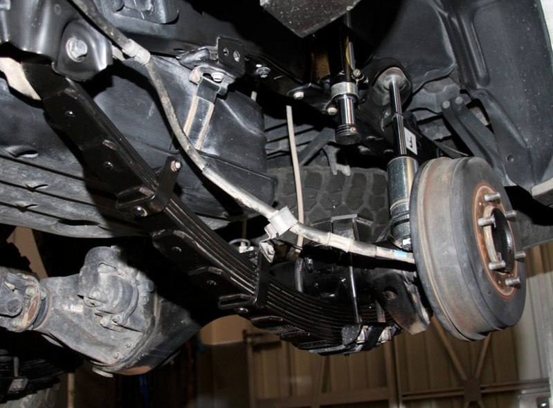

    Eh might. Longest shock you can put in the stock location is 10", I can fit a 12" without going through the bed but anything longer requires that.
    Didn't know the TC kit allows stock shock locations though..

    You can... But it wouldn't make sense heh. Definitely worthwhile to add in longer shocks. TacomaRearMidTravel01.jpg

    Yeah definitely doesn't make it worth it haha
