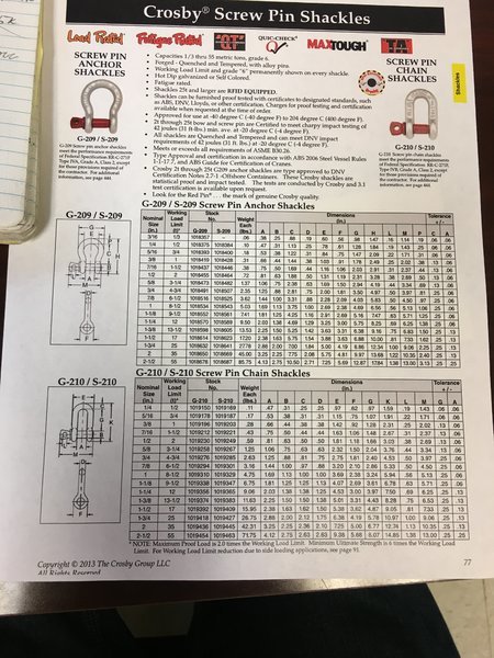

    I was sifting through our rigging gear at work last night and all the shackles happen to be Crosby. We aren't allowed to use anything from china and I prefer to buy American made anyways. Don't mind the extra cost thanks for the info.

    Always look at your charts!
    And beware of side loading vs straight pull.
