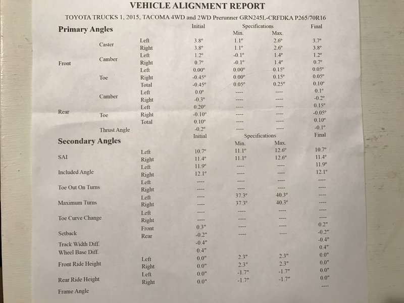

    What UCA's do you have? I wouldn't take the bumper/winch off.. If you go get an alignment and depending on your UCA's ask for 3 degrees of caster and that'll help a lot. If you didn't before

    I have icon tubular and I believe I'm maxed out on caster.

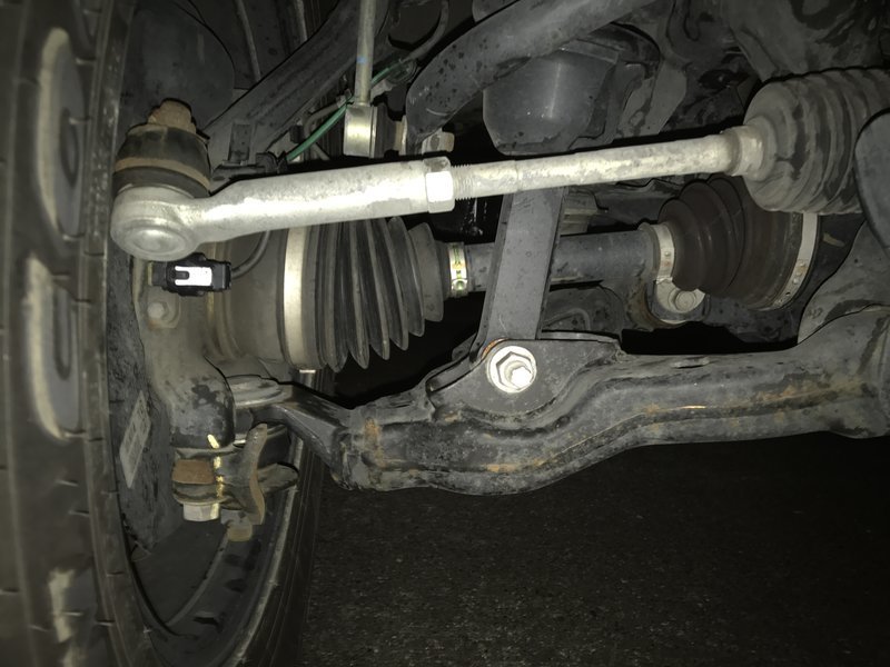

    Vibration in 2wd as well?
    If it is, you cranked it up farther than it was before. Only rotating parts that increased their angles can make a vibration appear like that.

    Did you ask for that last time? If not I highly doubt a shop would do that without special request.. usually they just set it as close to 0/0/2.5 caster

    and if it's only plastic you're rubbing on... :sawzall::sawzall::sawzall::sawzall::sawzall:

    I'm 3.7 on the left and 3.8 caster on the right.

    Can you see where you are rubbing? How did you get that much caster? I was told I could only get 2.3.

    Here's the alignment report

    Next to the cab mount I think. I have it chopped back pretty far.

    Yeah, the vibration tells me you brought it up farther than original. Dial it back till that goes away, then rub a bunch of chalk on everything you think might be rubbing. Find the problem spot, and give it attention.
