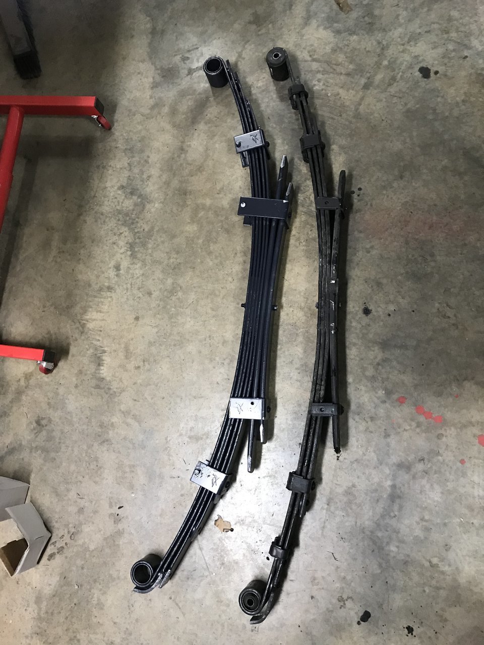

    But they went in just fine....other than the parking brake not being able to be attached to the pack due to them not giving the right bolt. Or least the stock one wouldnt fit and i dont have any M8x1.5 on hand to have tested. . But zip ties work just fine!

    They may be super bro but after yesterday I can say I am very impressed with the BFG KO2's in 295/75R16, I didn't have any issues slipping in the snow and didn't get stuck once. Granted I had @NorthwestCruiser and Andrew breaking trail but I was plowing pretty good with my skid plate and LCAs and there were a few places I got well out of their tracks and didn't have any issues plowing through.
    I am running Icons (no resis) with 700# springs up front and the Dakar EL096R leafs and Icon non-resi shocks (just swapped these in and removed the resi shocks) in the back with full plate bumpers, winch and heavy 1/4" IFS skid plate up front and I would say that the suspension is noticeably stiff all around but not unbearable by any means. I'm sure once I add 2 more skids plates and a heavier battery up front it will be almost smooth. The Icons originally came with 650# springs that I ran until I installed the bumper and I think with all the extra weight I would've been diving into turns with those springs. Since I haven't ever tried the clickers I can't say whether they would be worth it or not but if you don't see yourself using them that is a lot of extra money for really nothing. I do just fine with the non-resi up front, I think unless you are really planning to run hard there is enough oil in the 2.5" that they don't heat up enough to be necessary. In the rear I plan to go back to either a 2.0" or 2.5" resi at some point when I do a shock relocate, these are just temporary to get me by after needing a longer length with the Dakars.
