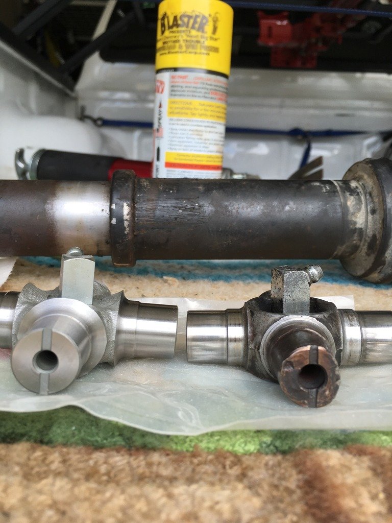

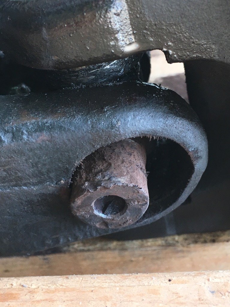

    @Goran
    As stated, if you know which u-joint is bad - it takes maybe 1-2 hours to remove/replace.
    I didn't know which one so I started with the one closest to the 3rd member.
    I also marked the original alignment with "Hello Kitty" pink finger nail polish so my driveline wouldn't be out of phase.
    I used a socket and a mini sledge.
    All of the needle bearings in one of the caps was completely rusted and fell apart when finally apart.
    Turns out the grease channel was completely blocked with something.
    The affected u-joint post was oval-ed out.
