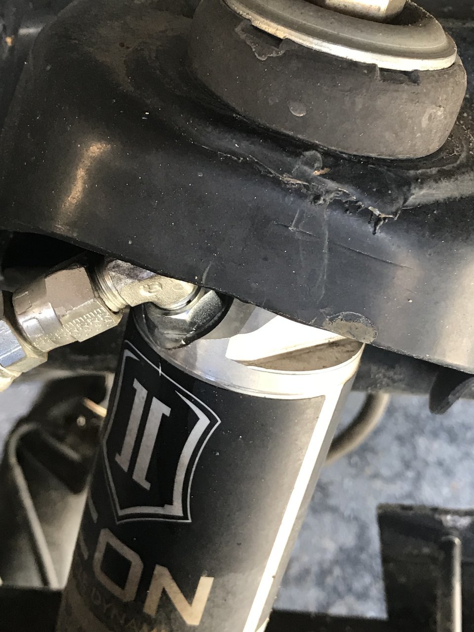

    I just noticed my rear Icon shots are leaking and the hose is loose. Is that something I should be concerned about?

    I think the shock tower is supposed to be notched at the fitting.

    Check if the fitting is loose at all and can be snugged up. If its leaking thats not normal

    Is it leaking out of the hose or the fitting?

    Looks like the fitting

    it looks like a its a -6 JIC Fitting, but its hard to tell without seeing the seal ( inside of the fitting )
    Try tightening it 1/4 turn more if that doesn't snug it up then you might need a new fitting pressed on.
    I work at a Hydraulic hose shop in Everett if you want me to take a look at it, i'd be more than happy to.

    I had the same issue with my Icons and ended up just tightening the fitting and haven't had an issue since. 6+ months so far.
