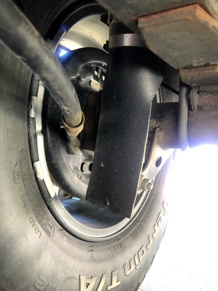

    I ended up making a shield for my Kings out of thick rubber for this same reason. After only a few hundred miles on logging roads the shafts were starting to get some pitting.

    How did you attach it to the shock? Hose clamp? I was taking my leaf pack apart yesterday and noticed my Kings are starting to get pitted on the shafts.

    Yep, I used two hose clamps. You could probably get away with one, but a little overkill never hurt anything. I've had them on for 30K ish and so far they have been holding up great.

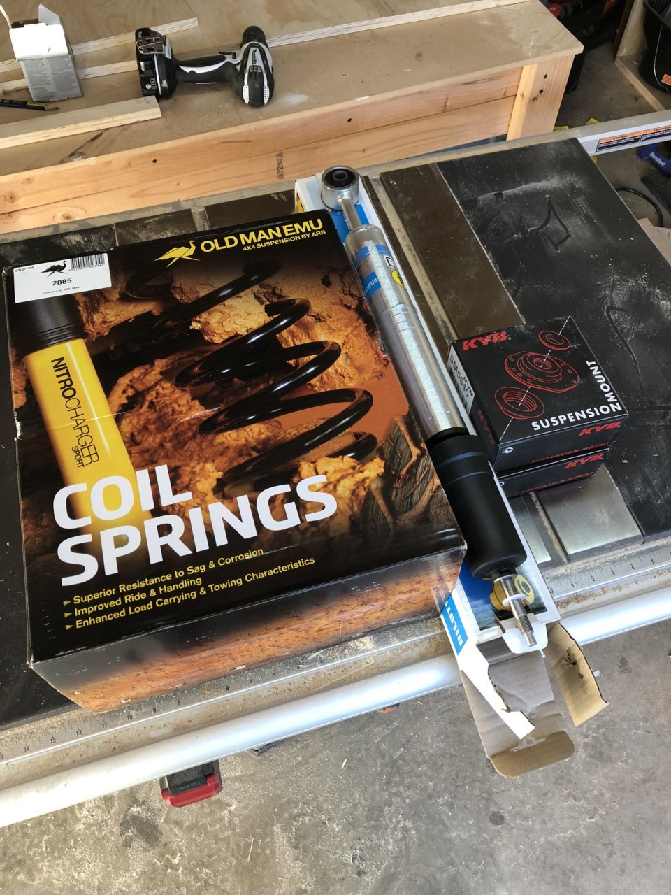

    3DA463FF-E6EC-480E-940D-5B304BECCAC2.jpg Mail came today :D
    Time to get rid of the spacer installed by the previous owner
