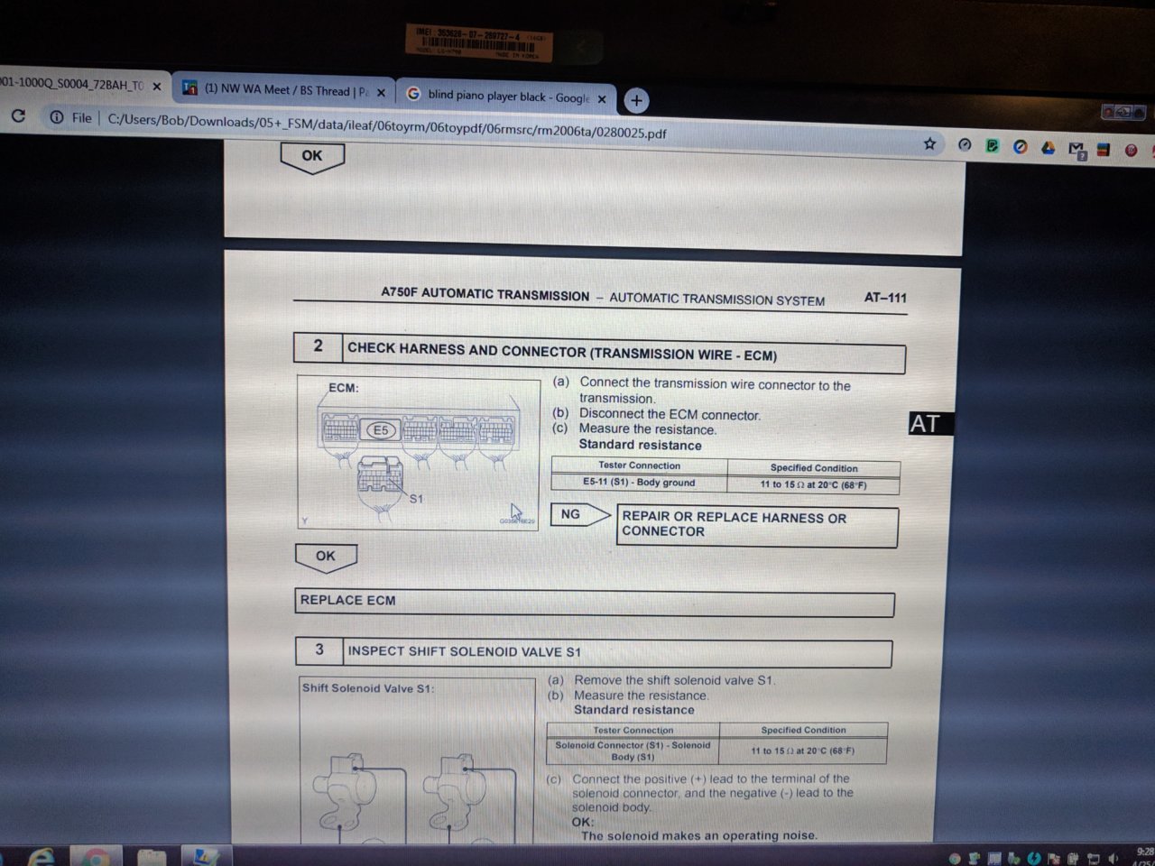

    So I'm starting to see a pattern here. I got my hands on the FSM for the 2006 Tacoma.
    The 2 wires they've fixed already, are on plug E4 of the engine harness which plugs into spot A on the ECU. Plug E5 is also part of of the main engine harness and plugs into spot B of the ECU. The main engine harness needs to be unplugged from the ecu to allow them to separate the cab from the frame and engine. Guess which plug the shift solenoid A runs to?
    E5. :eek::evil::typing:
    Seems who ever was responsible for removing plugs E4 and E5 just yanked on the wires till they came out. At this point they should just fix all the wires/pins on both those plugs to make sure this doesn't keep happening.

    Oh you don't have to do that. The FSM shows that SS-A goes to pin 11 on plug E5. I wasn't joking.
