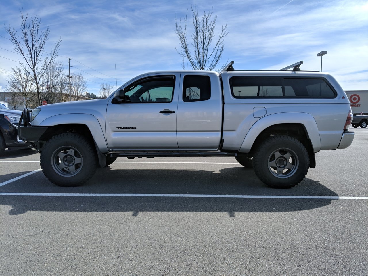

    I'm actually at 15mm driver / 13mm passenger. Driver side is still 1/2" lower than passenger. It needs to be raised to probably 18mm driver / 15mm passenger, but I am holding off because I had already planned on removing a leaf from my dakar pack. I have a similar setup with arb bumper, winch, full skids, sliders, group 29 battery over passenger fender. This photo is with the current 15mm / 13mm setup. It will probably settle more. I just realized the photo is with my skids removed.

    Nice, good info. I'll probably go for 18/15, and maybe throw a spacer on top just to get a bit more clearance.
    Did you also trim the wings on your ARB bumper?
    I just chopped about 4" off mine last weekend because it stuck out into the wheel well almost 2" with the flare removed.
