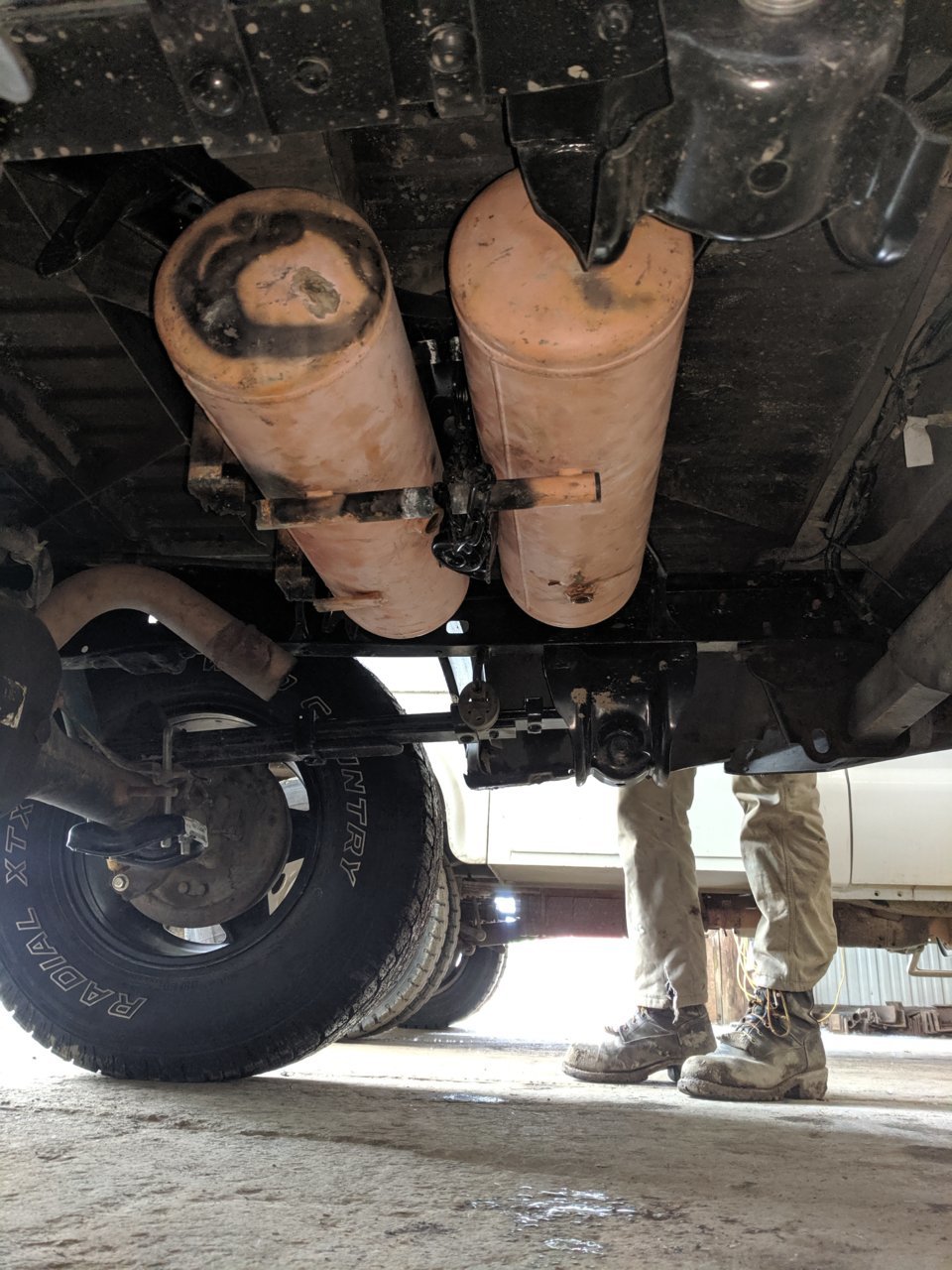

    What you going ot use them for? Ive had a tank and all the lines for awhile and just havent really decided if i want to install them it or not

    Mostly for when needed around the house, since I don't have an air compressor at home. Also to turn the compressor on prior to airing up, that way I'll have a tires worth of air on standby and should hopefully speed airing back up. It takes approximately a minute to charge the tank. I plan to T off and run a hookup on both sides of the truck. Im only using the factory arb pressure switch which I'm not 100% sure what it his regulated to. The tanks has a relief valve @165psi. I came across an old jobsite compressor that needed a new compressor but the rest of the components where good. Just need ~15' of hose to run from the front to the back.

    Straight from the manual for the twin pump.
    Pressure SwitchOpen10.3Bar [150psi]
    Pressure SwitchClosed9.3Bar [135psi]
    Safety ValveOPEN @ > ~12.4 [180 PSI]

    Sweet. That tank has a relief valve for 165psi. I should be fine.

    I've had it a while now and finally decided to just do it. I'd like to run the occasional air tool, cut off or impact, but that is probably pushing it.
    I used a prototype snellfab mount for the twin. Mounts to the core support near the radiator.
