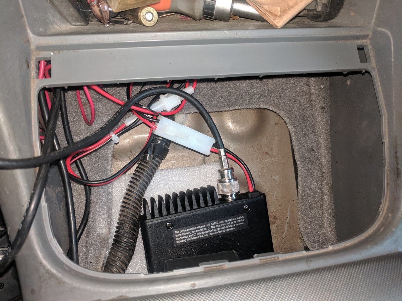

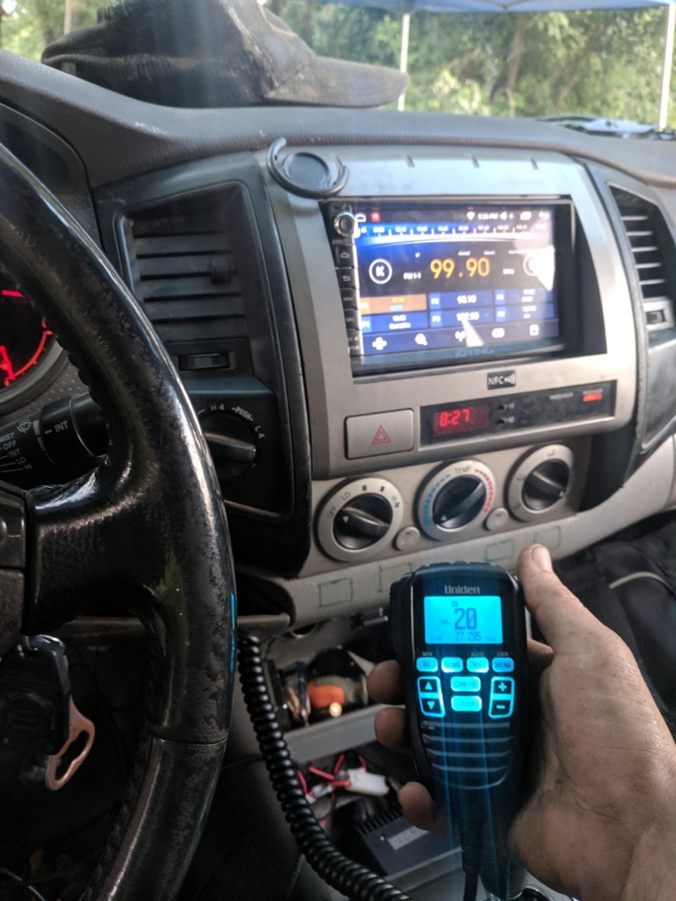

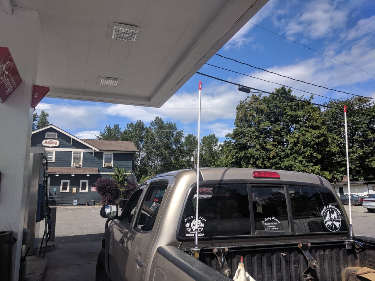

    Ok CB gurus. I got my uniden cmx760, found a spot in the tranny tunnel area to put it and coax ran to 3' firestik behind the cab. I'm also running a 3' firestik for am/fm terrestrial radio reception off a different run of coax. I'm getting interference when I key the mic on the CB with the am/fm radio, I can hear my voice through my stereo system speakers.
    The CB is grounded just behind the dash, but not mounted and just kinda floating in the tranny tunnel with foam padding to keep it from jostling around. Do I need to ground the chassis of the cb too? Both firestiks are mounted and grounded to the same rail, could that be my issue? CB coax runs down driver side frame rail and uses the driver side firestik, am/fm radio runs down the passenger side frame rail and uses the passenger side firestik.

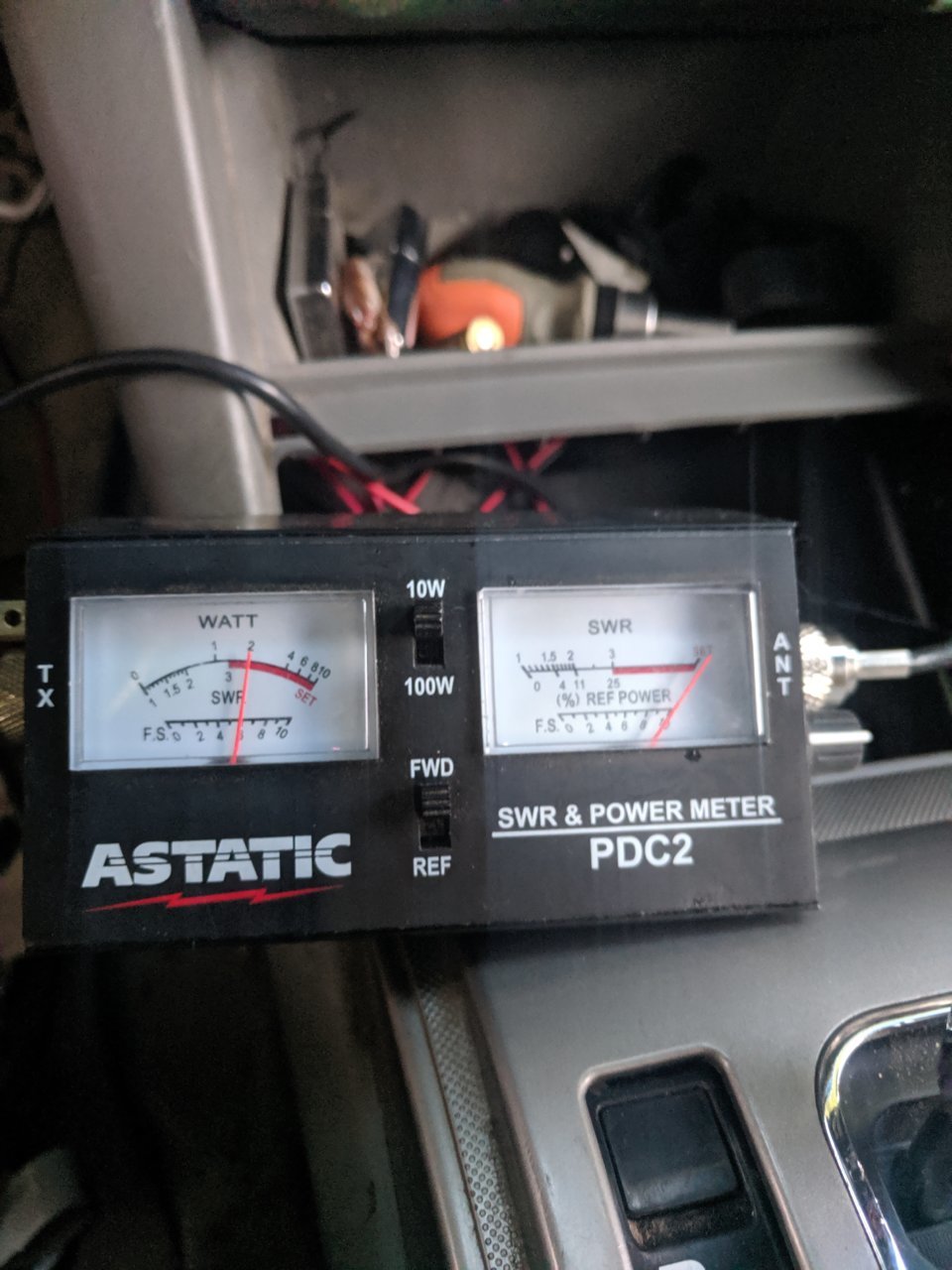

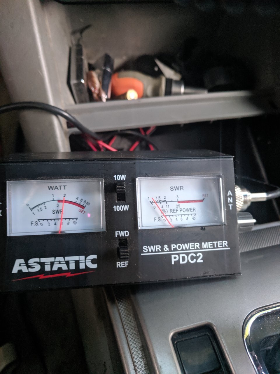

    I'm not even sure if I'm using my swr meter right.
    :notsure:
    Swr dial at set
    Then when switched to ref, this is my swr without moving the dial.

    Turn the stereo off! Mine did the same thing.
    On the other hand anyone in range with stereo on will hear it too!

    Just realized am/fm radios don't require a ground. Unhooked the ground from the coax ran to that antenna and interference went away. And now have the squelch at 1 instead of 4.
