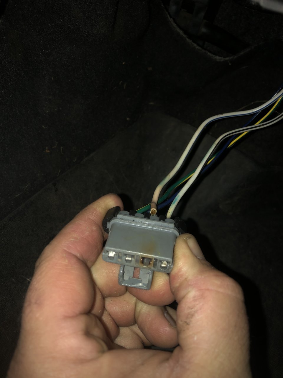

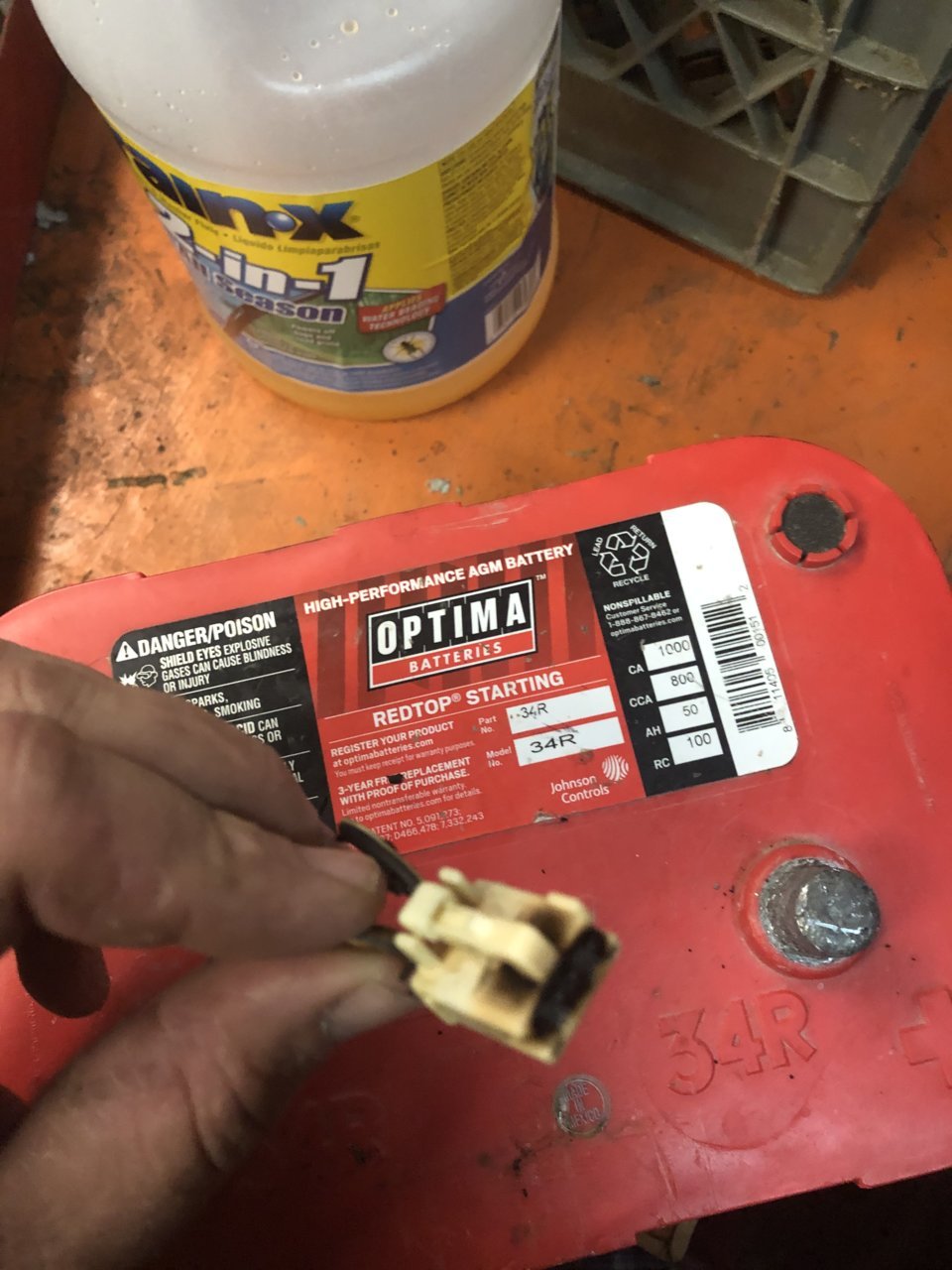

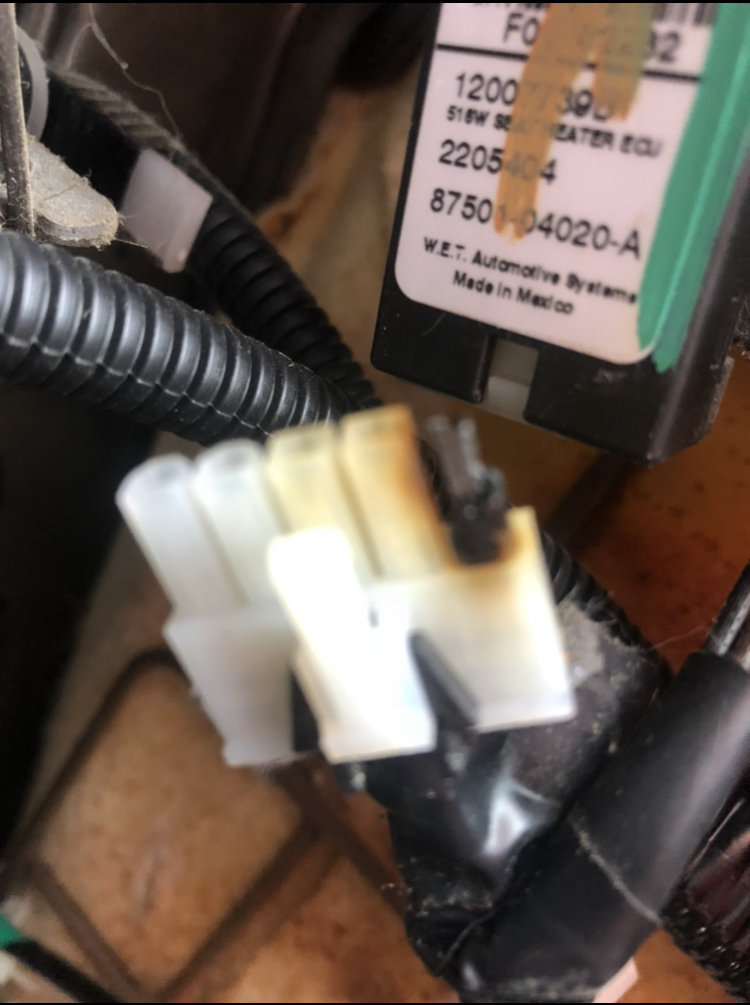

    I didn’t take a pic of my other heated seat module that’s burnt up too, but for f@cks sake, I’m getting a little pissed off at Toyota and their shitty connectors trying to burn down my truck.C73A51BF-F9B1-4512-8050-3F43D5949C50.jpg 208CD2C4-C038-4C3C-AF4B-DC72C8BD7B15.jpg 3FBDC143-ACB8-455D-B999-C04F10DFEAED.jpg

    Pretty sure those were recalled. Their solution was to remove them from the vehicle completely and refund the portion of that accessory package to the customer.

    There’s a thread around here somewhere I’ve been following for the heated seats. Looks like I can solder in a thermo connector if my module isn’t fried inside, or buy that part of the harness and splice it back together without dismantling my seat to get the heating pad installed. Figured I would give the $2 option first. Lol, the dealership to me that the only way they would fix it was if I bought new seats.... having heat in the lower back after work is nice after a cold day but buying seats isn’t even an option. I bought the updated wiring plug and resistor for the blower motor today and discovered the blower motor plug was smoked too. I’m doing all the little nagging BS electrical problems I have while I have a little time off from work.

    You’d be surprised to see how many manufacturers battle that same problem. Everyone i replace I just throw on a weather pack

    I had to replace the blower resistor twice now. Both times it was the actual resistor and not the wiring surprisingly. This last time i did the updated wiring and resistor so we will see

    This is resistor #3 and the first shot at the new updated harness.

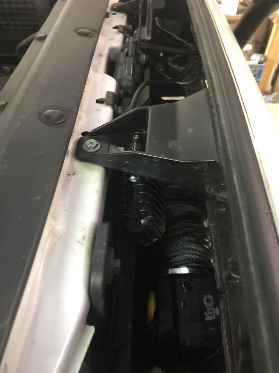

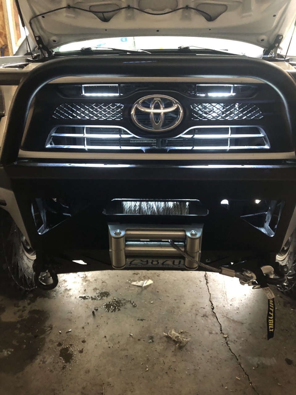

    05AC026C-AEFC-424F-B4EA-10951DA607E8.jpg I came a slick way to light up the winch to make sure I’m not over coiling one side at night. Everything is attached to the grill so all I have to do is pop the connectors off and it all comes out with the grill.4739411D-0F29-457E-93CC-492AF659EC1D.jpg

    Well that's one use of light bar that actually makes sense. I need to find somebody local to let me winch their vehicle to pretension my line. Finding a spot do do it in alone has been more challenging than I thought it'd be
