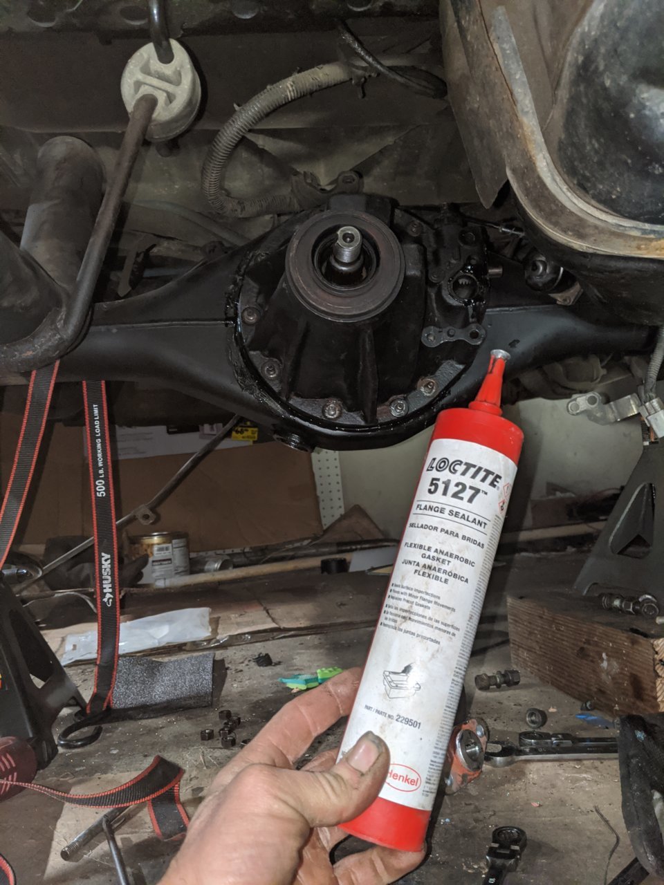

    So I'm pretty sure I glued my rear diff to the axle. I used this stuff I had laying around, Loctite 5127 "flange sealant", thinking it was similar to rtv, but I'm thinking like most of the products made under the Loctite name, it locs it Tite. :bananadead:
    The damn thing won't budge and both shafts are out and the locker is engaged. Not even a wiggle.

    Front and Rear Locked, 35’s, Chevy 63” swap, Fox Suspension and a bunch of other shit too long to list.
    Put the yoke back on and come a long it.

    I was just thinking that. I should probably put a couple of the stud nuts back on for when it finally decides to let go so that it doesn't end up going through the backside of my engine.

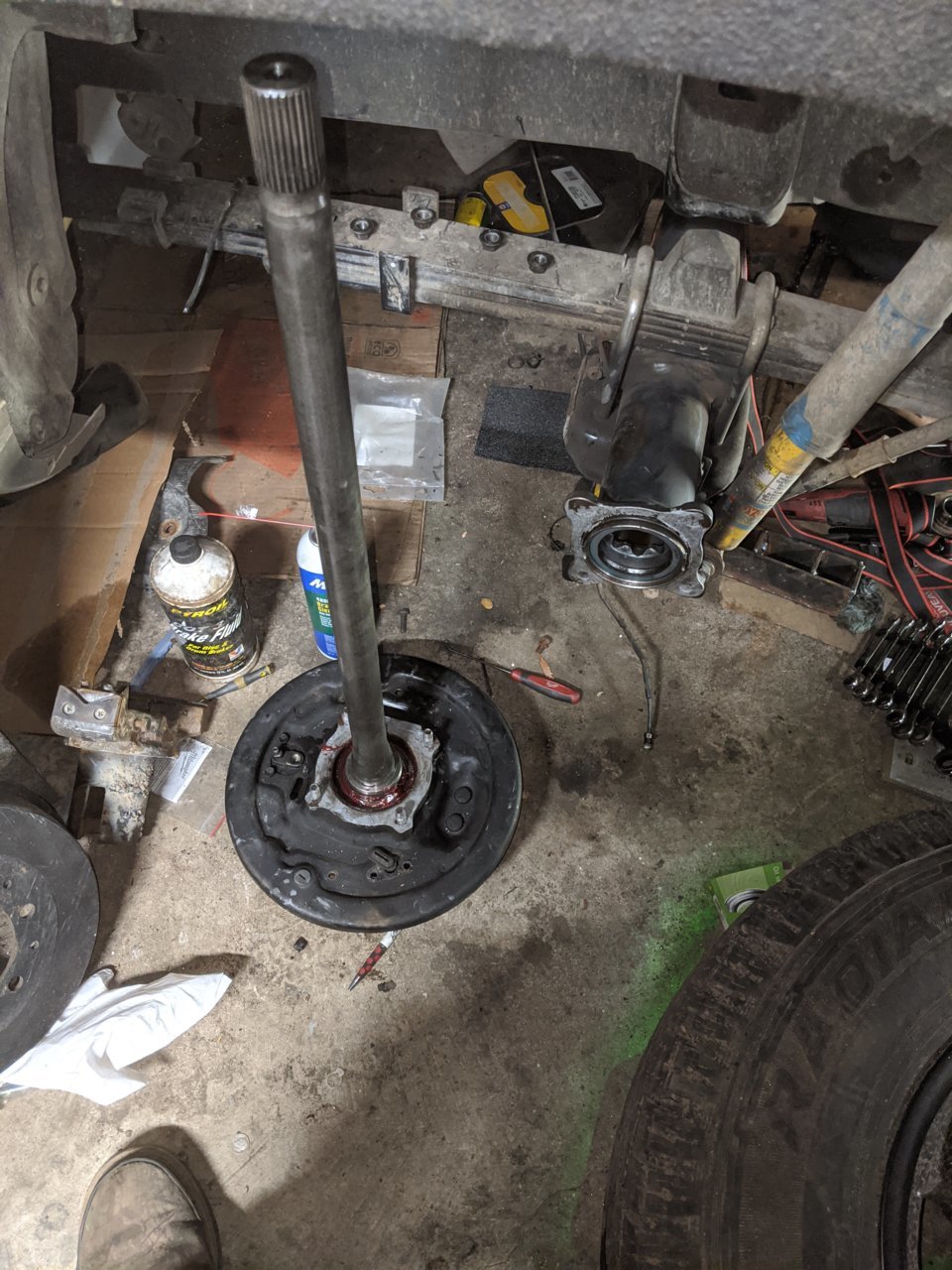

    They're completely out. I'm putting new axle seals in also. Im hoping I didn't completely wash out the wheel bearings so hoping I can repack them without removing them from the hub/shaft. I know it's easy to just remove the c clip holding the shaft to the hub.

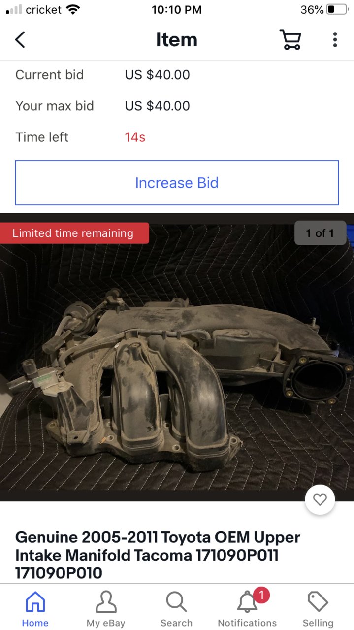

    A9DE21AA-5094-4015-96C5-AA487262BDA1.jpg Next quarantine mod is in the works.

    Damn, $40!?
