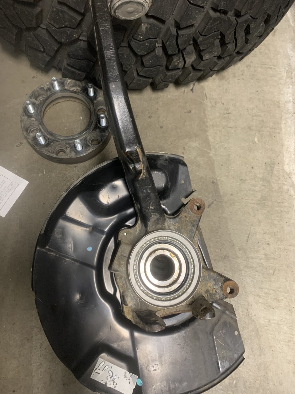

    @busmup808 this or take a cut off wheel and cut diagonally through the race. Watch your depth so you don’t hit the spindle, Wanna be 95% of the way through. Once you’ve cut through as much as possible take a chisel and place it in the groove of the cut you just made and pound on it. The races are hardened and will split. Sometimes cutting one side works, you might have to make two cuts 180° opposite of each other though
    And wear safety glasses, hardened metal will do some gnarly things

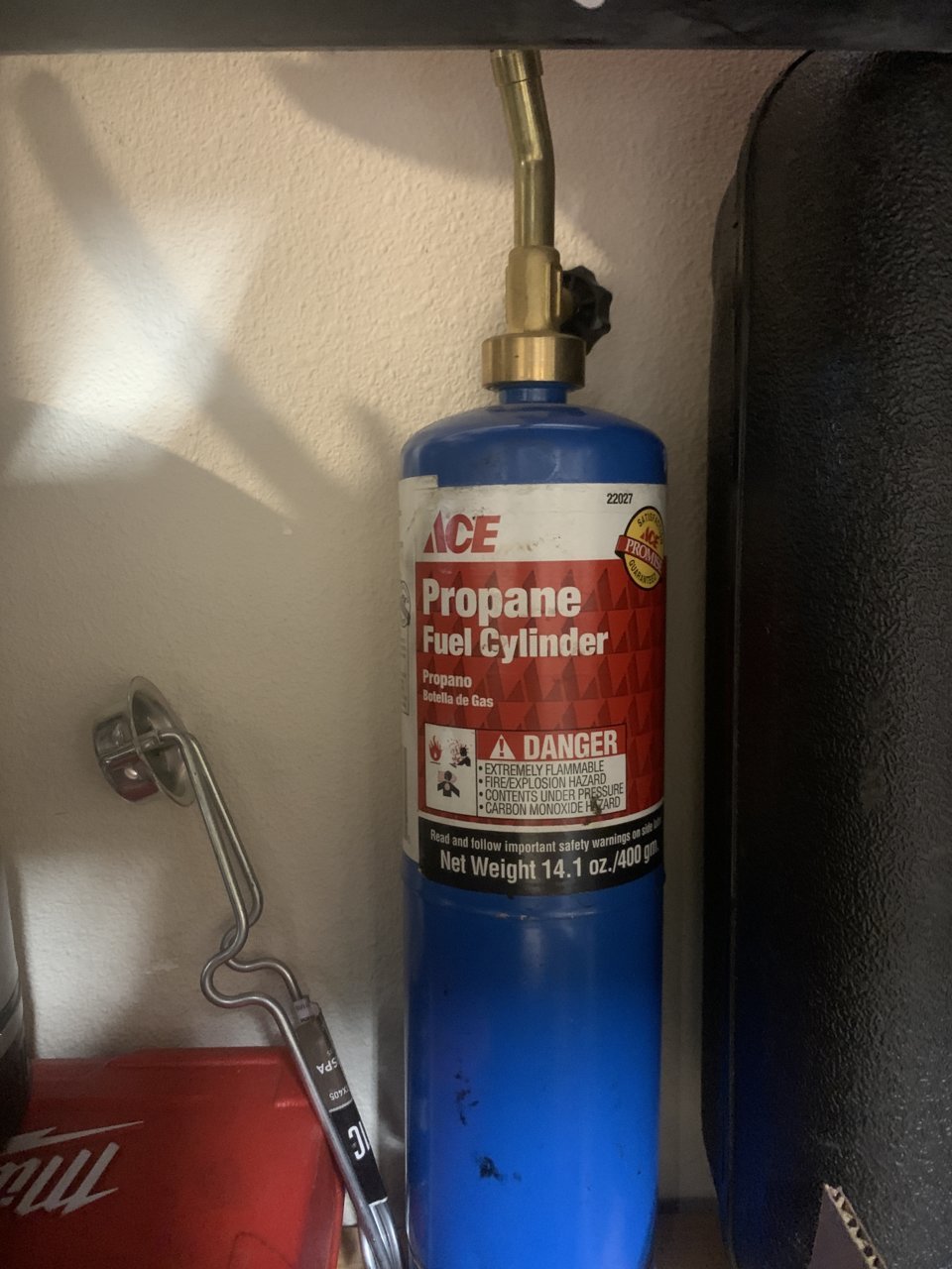

    Mahaloz Brotha! My cuz’n called me after I posted and picked me up to go to the junkyard to get another L spindle. Long story short is I got the parts and it is all pressed in. Taking a dinner break to feed my son and then back in the garage to assemble. Heat didn’t work for me as I only had Ace propane fuel cylinder. Did the dremal thing and it worked.

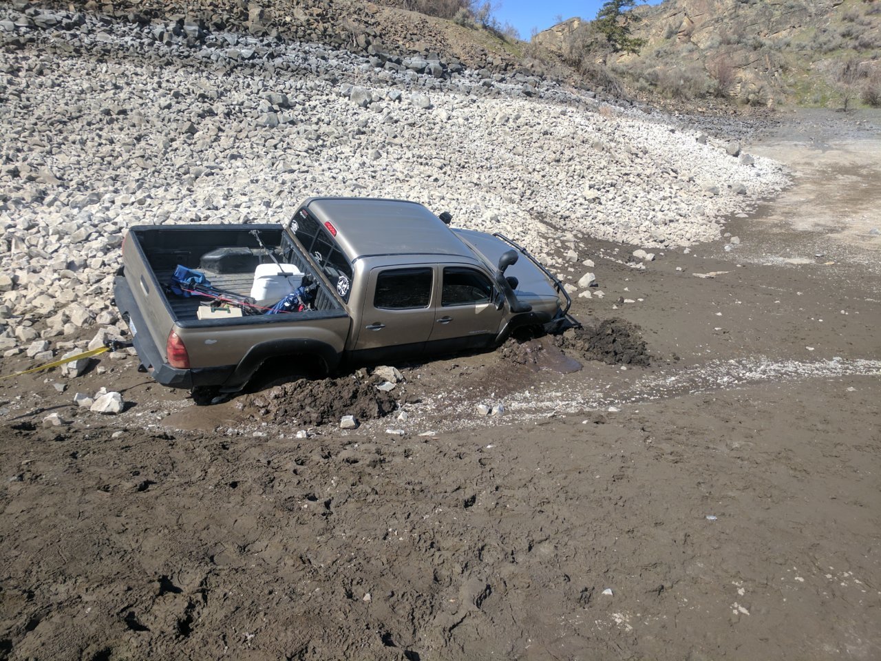

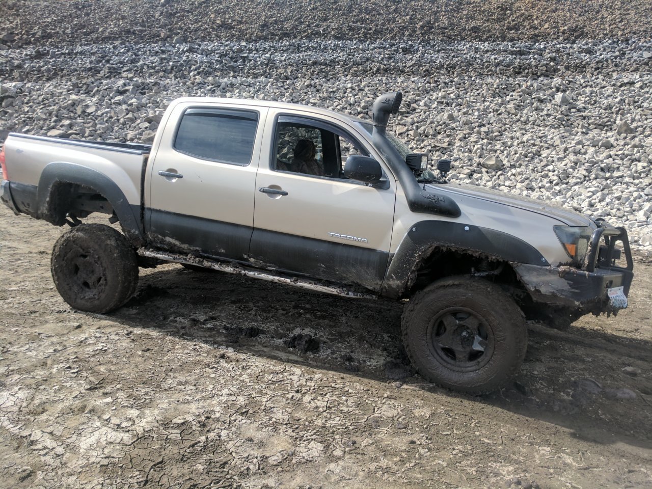

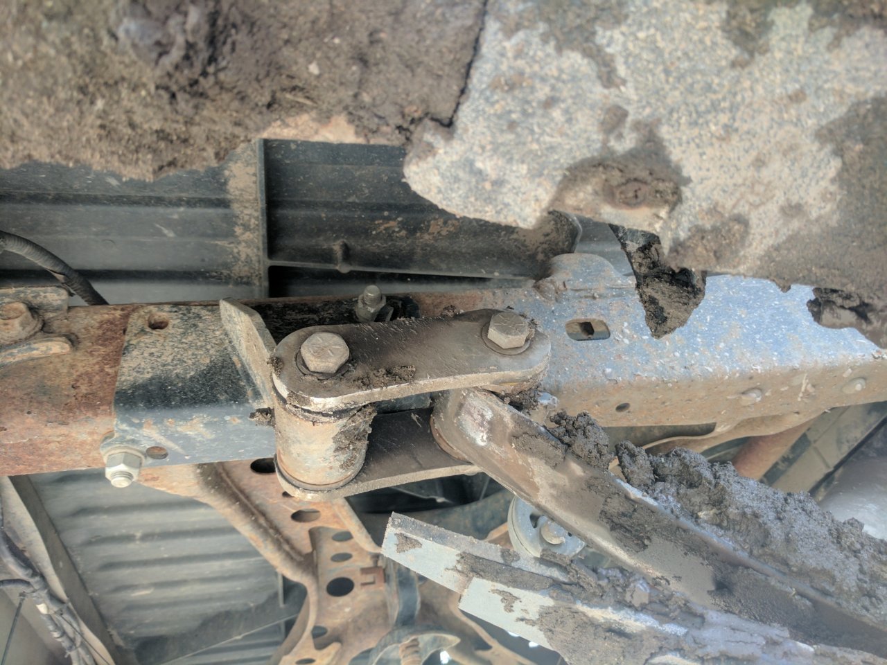

    So I just remembered a good fix to re-arch your dakars... Go flex them out and let one side of the axle completely become weightless, then slammit into reverse. That should cantilever and invert the shackle the wrong way forcing a positive arch to be formed. You'll have to flex it out again but continue In a forward motion to bring the shackle back to normal location. Repeat with other side, and boom no more saggy flat ass. :bananadead::bananadead:
    It also helps if you get stuck in a muddy ass lake bed, such as lake Roosevelt and have a Chevy take running starts and jerk your truck backwards inches at a time. It really gets that shackle inverted in a hurry.
    FYI, this is not a recommended way to re-arch leaf springs. I cannot be held responsible if anyone chooses to try this.... :anonymous:
    Damn was looking closer at these pics, my frame looks way worse than I remember. Big difference now.
    Notice the gap between the main leaf and the next leaf below it with the shackle inverted? It's a bit of an eye fuck with the mud and rusty frame all blending in. You can really notice it in the last pic inside the wheel well. There's a good amount of daylight shown through that gap.
