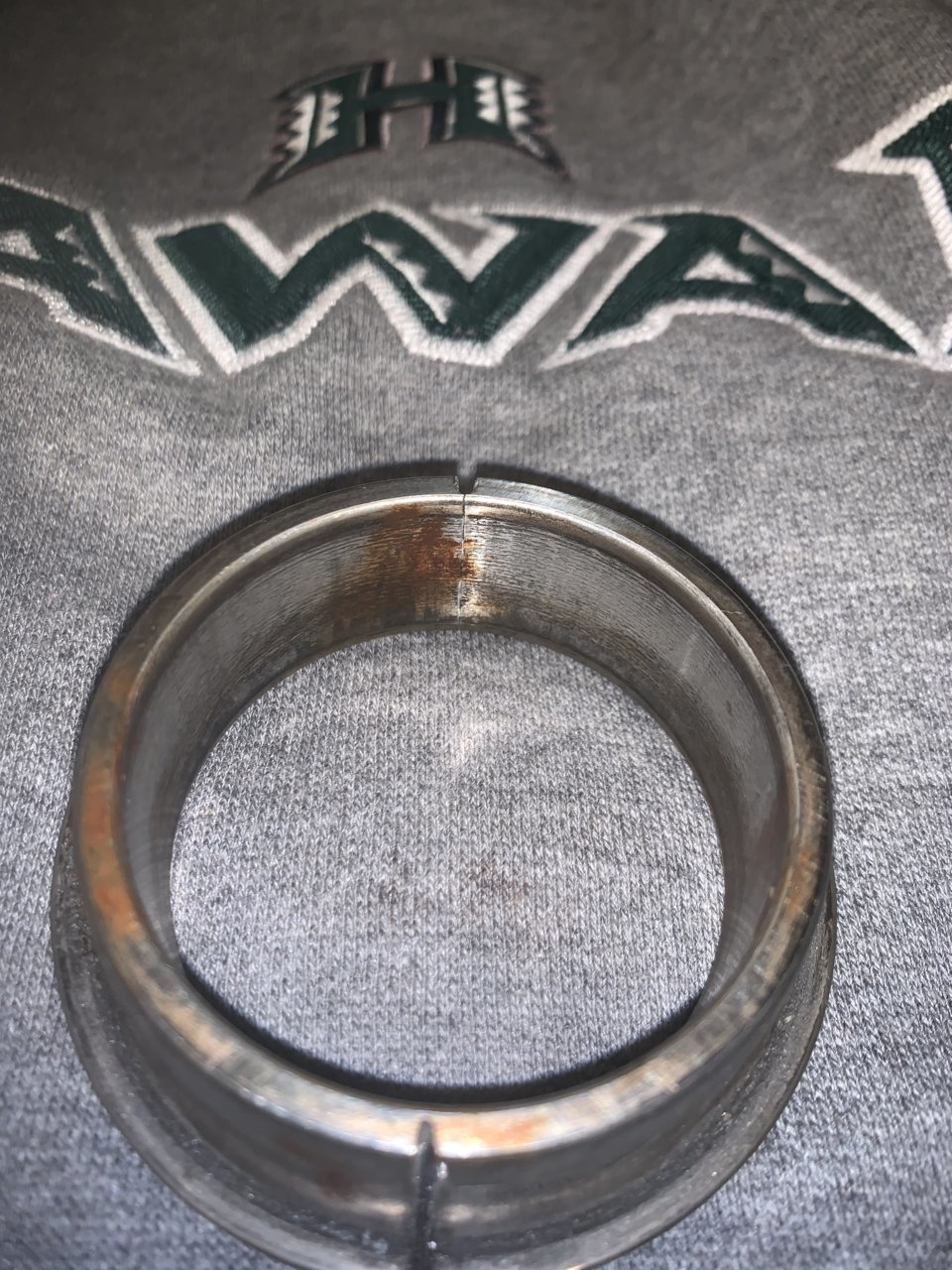

    busmup808
    busmup808 bus up all day, all night
    Mar 7, 2014
    #124781
    674
    Dain
    HI 2 WA
    So here is the race that wuz stuck on my hub. This thing wuz a biatch!
    This photo u can c da crack on da top of da race

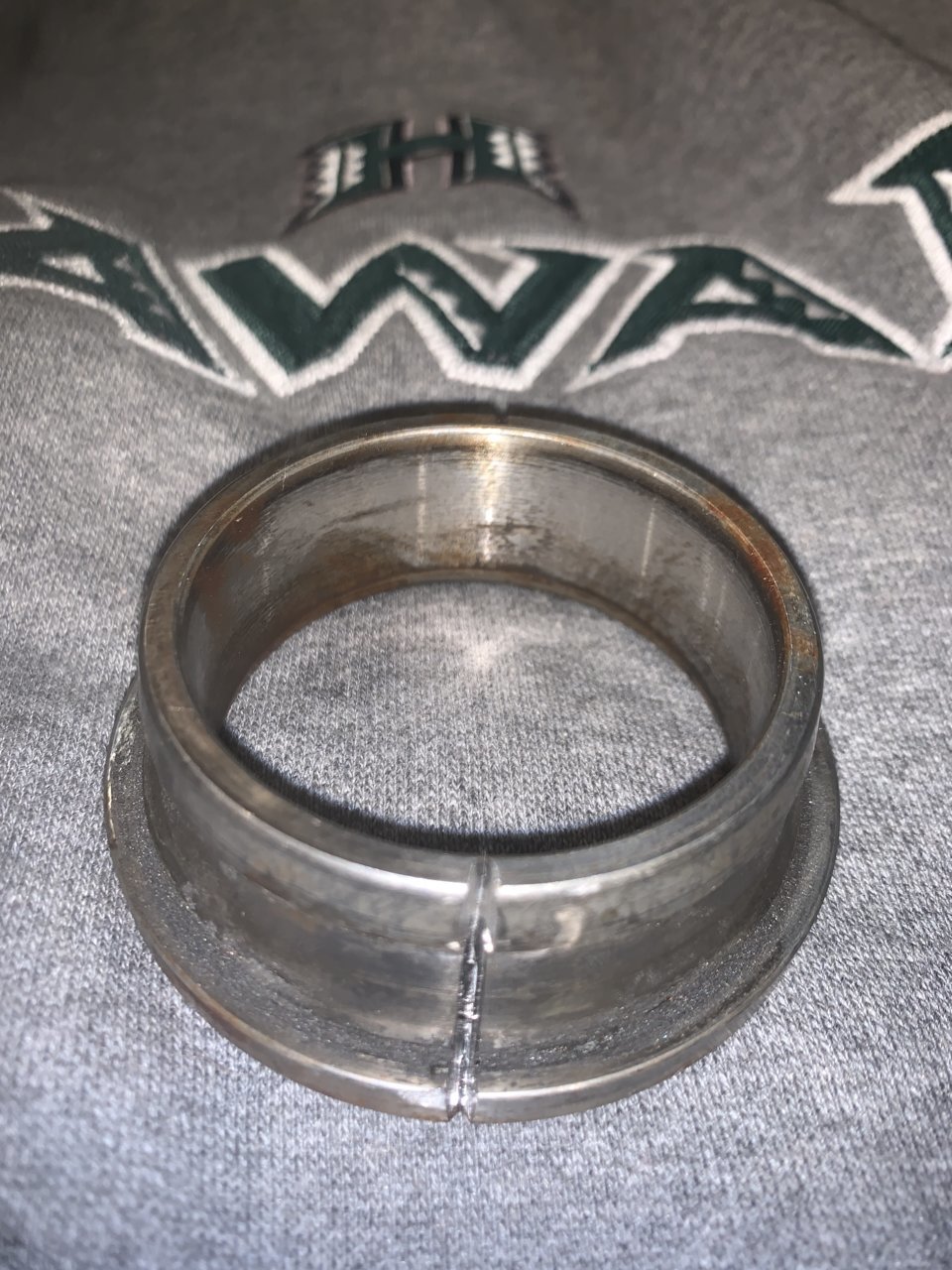

    busmup808
    Mar 7, 2014
    #124781
    674
    Dain
    HI 2 WA
    Thanks, but I already got some from my skool scrap pile yesterday upload_2020-4-24_21-22-32.jpg

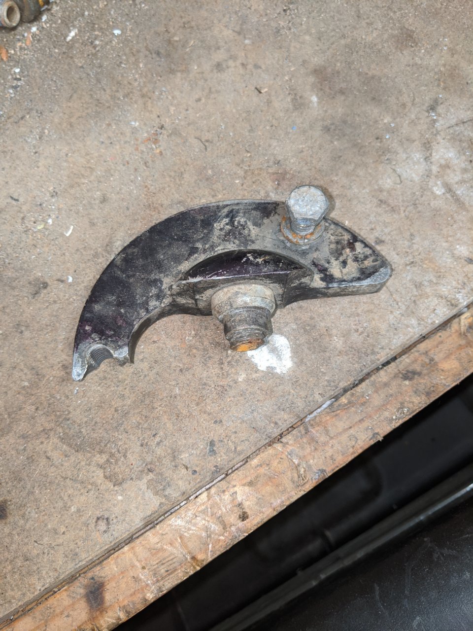

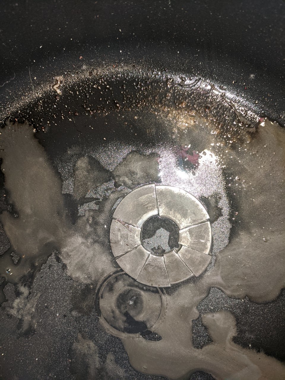

    bobsuruncle
    bobsuruncle PhD in voiding warranties
    Feb 17, 2015
    #148863
    7,339
    Bob
    Fall City, WA
    06 TRD OR DCSB
    ARB bull bumper Warn XD9000 Icon 2.5 EXT Road Armor rear bumper Archive Garage shackle flip FJ/T4R tcase 4.30 gears Dirty5’s T4R rear axle swap w/disc brakes New frame from Toyota under EWP
    @velillen
    Topmount/tophat: here's what's left of it. I have nfc what it's actual name is.
    And also the topout washer
    busmup808 and Dirk Diggler like this.
  16. Apr 25, 2020 at 9:42 AM
    velillen
    velillen Well-Known Member
    Dec 14, 2013
    #118589
    5,940
    Nick
    Wyoming
    2011 Access Cab 4x4
    Do you have the old Top out washer? if so measure it and call up polyperformance and see if the King 2.5 Topout washer is the same
    The top mount you meaning the Tacoma specific part (witht he three bolts for coil bucket) or the actual top cap that threads into the shock body? 2.0 or 2.5?
    edit beat me to it on the mounting plate thingy. I dont have one of those. Could always check if King's or Fox's measure out the same though. Only difference id imagine on them would be thickess and possibly the width of the channel for the eye
    bobsuruncle[QUOTED] likes this.
  17. Apr 25, 2020 at 9:44 AM
    bobsuruncle
    Feb 17, 2015
    #148863
    7,339
    Bob
    Fall City, WA
    06 TRD OR DCSB
    See above. :typing: :D
    I also need new spherical joints at both ends of each coilover and the spiral clips. 2.5 IR non extended travel, which icon now is telling me I can't make them ext travel by removing the internal spacer or rather, they're not designed to do that. I'm about to just buy some kings or ads at this point.
  18. Apr 25, 2020 at 9:59 AM
    wrmathis
    wrmathis Dark Lord of the Sith
    Sep 10, 2008
    #9126
    9,460
    Bonaire, GA
    2006 Tacoma TRD OR 4x4
    parts and stuff
    maybe @TMFF can help you out. he rebuilt my ICONs and replaced a shcok body and shaft on my ICONs.
  19. Apr 25, 2020 at 10:10 AM
    velillen
    Dec 14, 2013
    #118589
    5,940
    Nick
    Wyoming
    2011 Access Cab 4x4
    If you dont need the misalignment spacers its probably cheaper to source your own stuff than buy the "kit" from icon. Its COM10T bearings top and bottom. The spirolox...just add them to your order for anything else you need icon wise.
    They probably think you were asking to just take out the spacer and run it with no spacer at all. The extended travel still has a spacer it is just like half the length of the standard travel one. If someone with them was needing a rebuild soon you could just measure it and have Jim make one real fast.
  20. Apr 25, 2020 at 10:14 AM
    bobsuruncle
    Feb 17, 2015
    #148863
    7,339
    Bob
    Fall City, WA
    06 TRD OR DCSB
    Yeah I was planning to just cut it in half. On side is already about 3/8" shorter than the other. Do you know if the spirolox can be replaced by c clips? I'm thinking I'd just need the right diameter and thickness to keep everything tightly held together.
