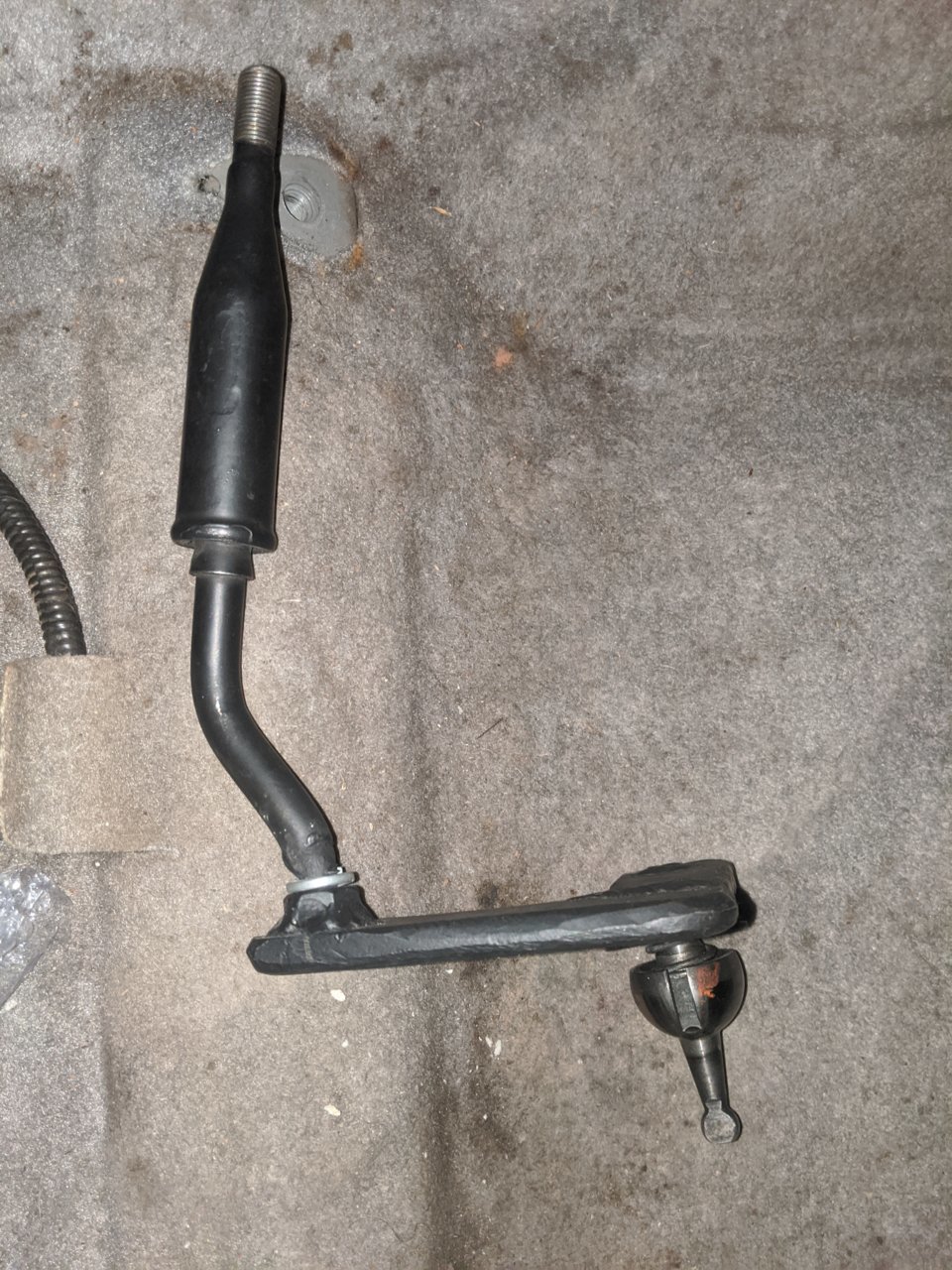

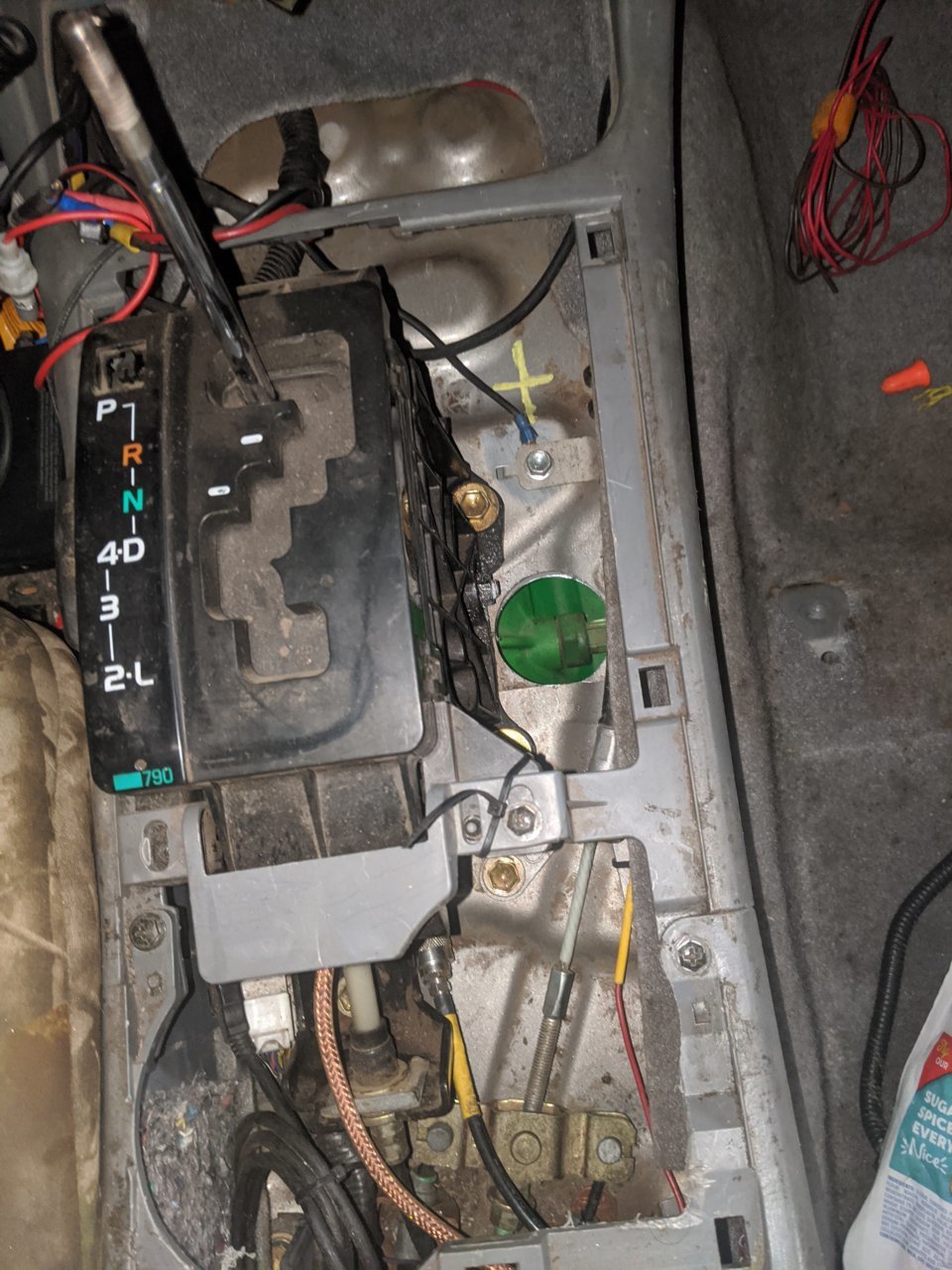

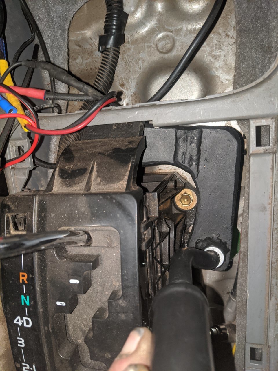

    Did you mean to quote me? Yeah that's where the FJ case sits, and that hole is were I want the shifter to enter the cab about 2-3/4" right and 4-1/8" back from the actual hole at the tcase. it conveniently wants to come up right between Park and the left side cup holder of the center console.
    The dog leg linkage needs to be under the cab not in the cab to work in the spot I've planned for. Everyone seems to just go with twin sticks, now I see why.

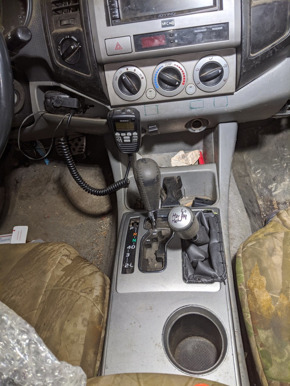

    I went from a twin stick to a j shift pattern. One reason is with the crawl box, there is no need for 2lo with just the rear tcase. I can have it with the crawl box.
    Second reason is my tcase has a blow out with some of the mounting bolts and rtv. So leaking gear oil all the time wasn’t fun so when I got a new tcase, I did t feel like tearing the case apart to twin stick it.
