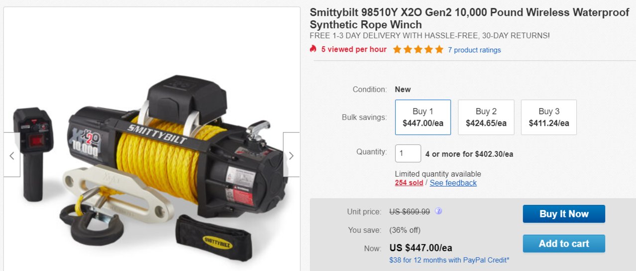

    I'm not someone who needs a winch regularly, I just want that extra piece of mind for doing solo trips. As long as it works when I need it, I'm good. I've got small hands, hopefully it wouldn't be an issue. They've got a good deal on eBay for it right now, so I'm just trying to convince myself to press buy.

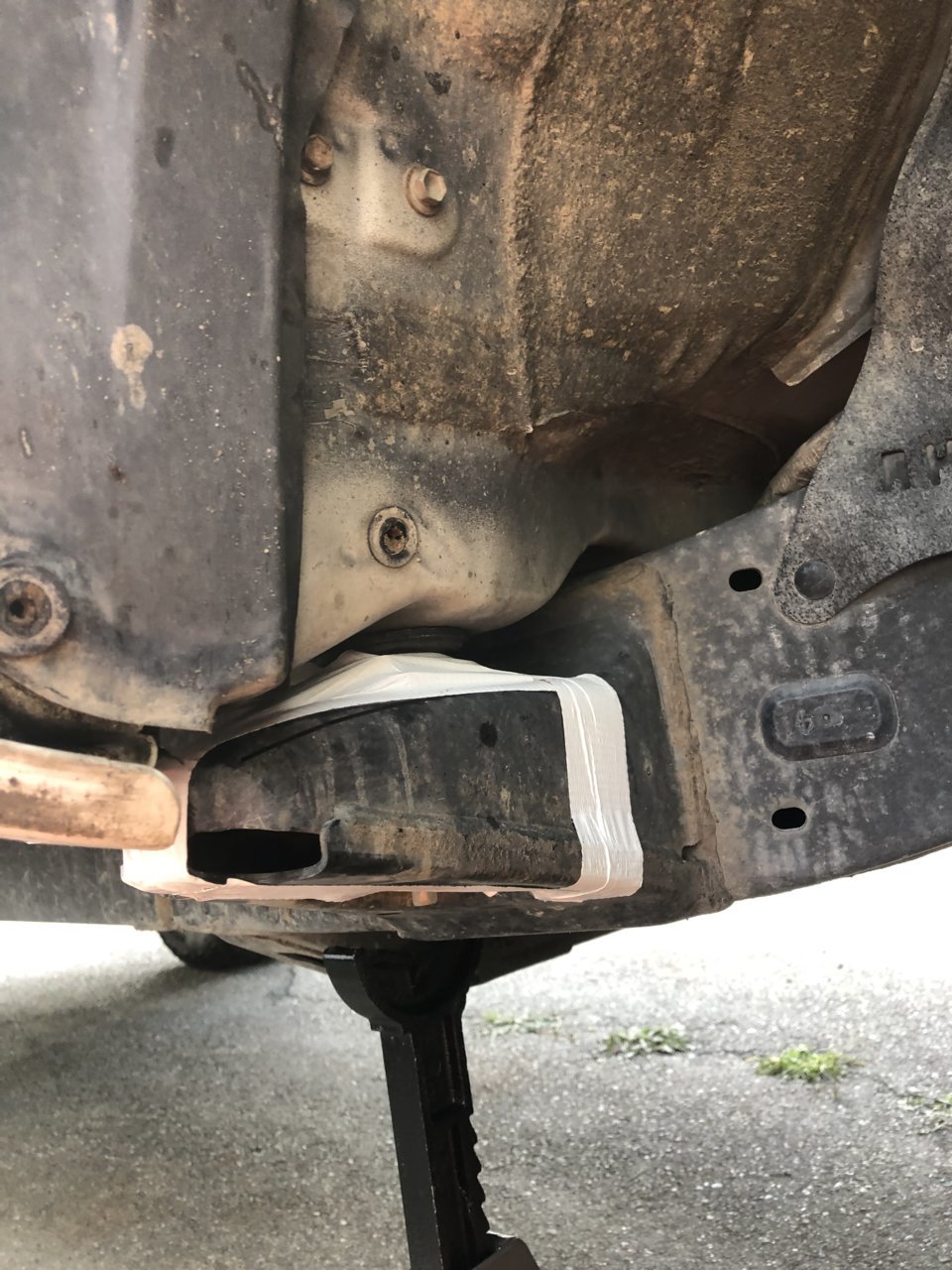

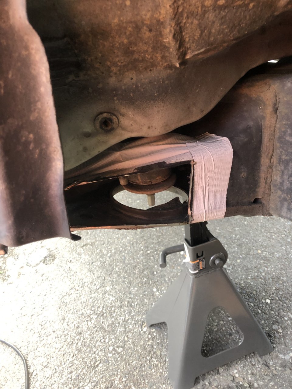

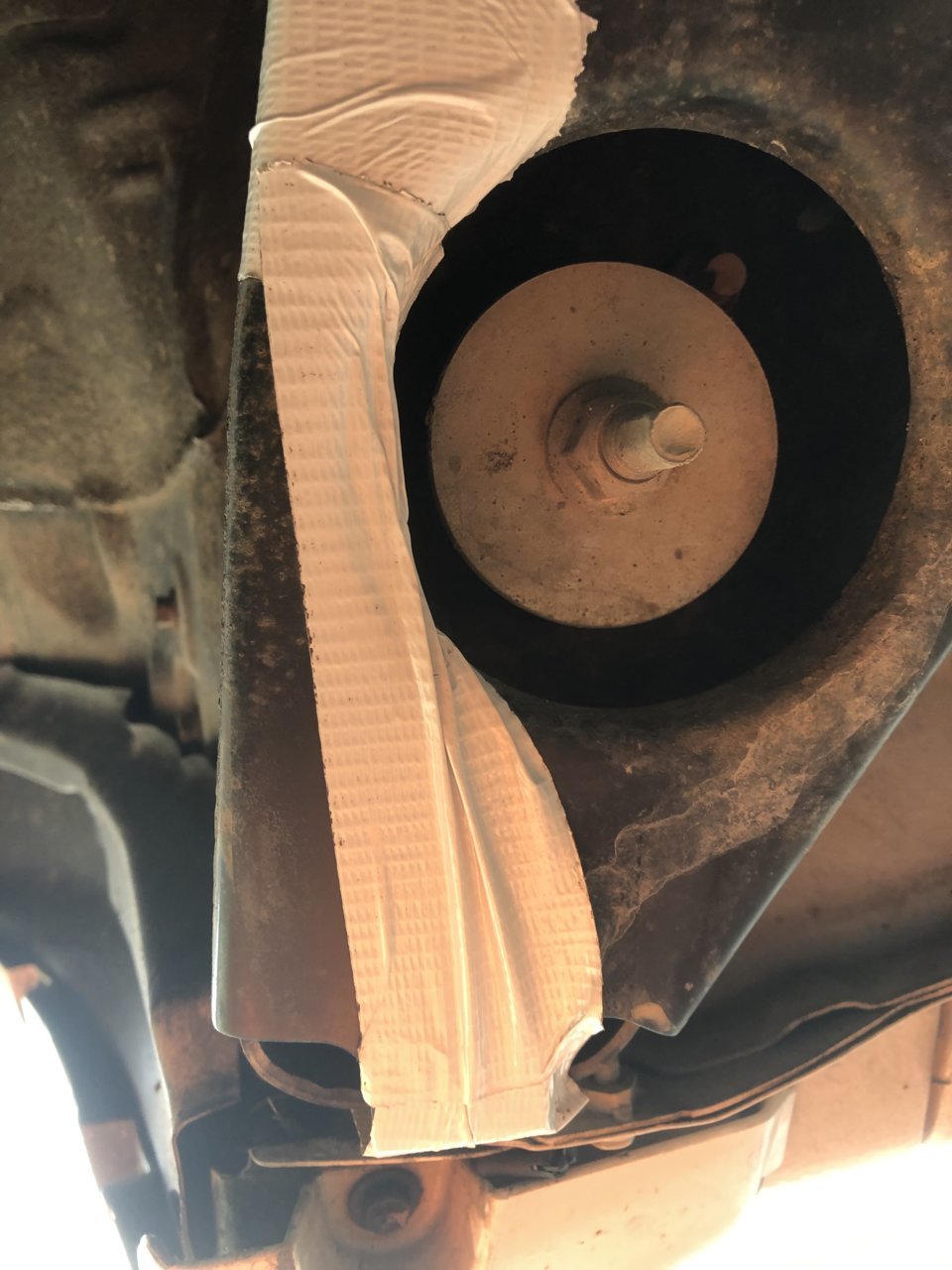

    Anyone feel like sharing pix of their CMC? I might cut mine soon and wait for Jim to be available for the plate welding but I'm not 100% on where/what to cut. I thought I saw something on TW where someone added lines to a pic of a cab mount showing where to cut but I can't find it now.

    4 people = 402 shipped for a 10k synthetic winch....sounds like a big win to me

    I think they may be discontinuing the X2O since the new Gen 3 winches came out recently. Seems like stocks are dwindling most places, and this is about 100 bucks cheaper than anywhere else I can find currently. And obviously the Gen 3 is more expensive.

    Did you cut yours? If so, did you use an angle grinder and how difficult was it?

    Thin disks 4” grinder stupid easy. The tape made it easy to see and get straight lines. My safety glasses were sun glasses that day so it was a little dark up in there. Maybe 5-10 minutes of laying it out perfect then 2-3 minutes of cutting. I had a BAMF plate to trace my lines with a sharpie. I made sure my cuts were a little smaller than my plates so they wouldn’t fall through to make welding them back up easy. I did a little grinding on the plate and hole for a tight fit tack welded it in there then went to town and let the grinder do the magic on the finish. I can glue metal together but I’m not a welder by any means. A584752F-9B42-4698-813E-6061E785E547.jpg45900B34-1E37-46EE-BD88-8B66286AC05E.jpg
