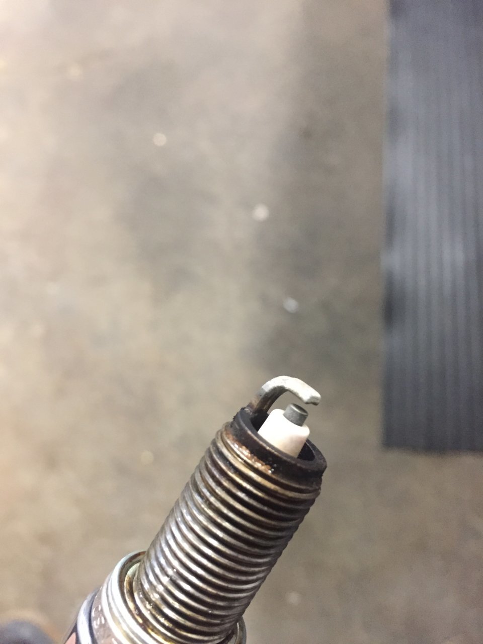

    Here’s my spark plug. Gapped correctly. Just noticed my coolant overflow is empty. C483042A-716A-4985-9EEC-D07803E30794.jpg

    you might have a blown head gasket. want to say the 4.0L are kinda prone to them in the No4 Cylinder. either 4 or 6

    I'll say it right now, that's a blown head gasket the way it's clean at the electrode.
    @CBenfell what do the rest of the plugs look like? Leave that plug out and after a few hours inspect that cylinder for coolant.

    I agree. Not oil fouled AND he’s loosing coolant. If it hasn’t overheated it’s probably worth just pulling the heads and putting new gaskets in.

    I don’t have a scope to stick down there. I will check #2 plug and see what’s up.
