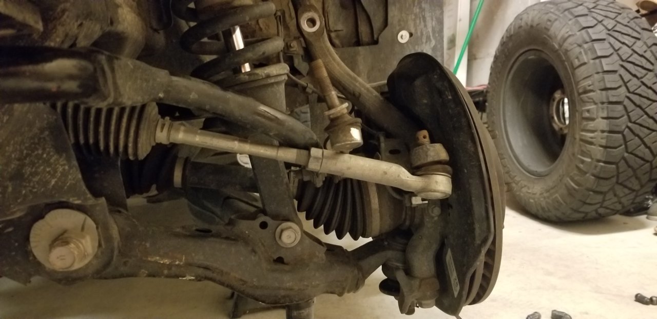

    I feel dumb as shit. I cant seem to get my sway bar over my steering tie rods. I tried dropping one tie rod but its not fucking budging. Suggestions?

    Need to get it a bit straighter so it's not in such a bind, try shocking the area of the spindle where the tie rod balljoint goes through with a good solid blow from a hammer. Last resort, thread the castle nut back on and hit the nut to drive it downward and out. Some heat, even from a small propane bottle torch would help. Heat the spindle around the joint, but not the bolt or joint itself.
    Edit: scratch that, just undo the UCA balljoint or bolt if you have aftermarket/separate the spindle from the UCA, loosen your lca bolts, swing the lca and spindle assembly down, put sway bar where you want it, and reassemble. You may need to also remove the coil assembly at the lca, ymmv.

    ...i got it off lol. I just about took off the front crossmembers? And slid the swaybar off through the front. 10 minute mod my ass lol.

    Yeah, whoever said it takes 10min must have just cut it off. There's quite a bit of shit to remove just to get the away bar out in one piece.

    Yah. The vid i watched conveniently left out the guy removing the outer tie rods lol. Oh well. Did a quick lab around my neighborhood. Doesn't feel too boaty. Less body roll than OEM trd off road suspension. I'll have to test it out on the freeway to see if I'll keep it. At this point though my laziness will probably keep me from putting it back in lol.
