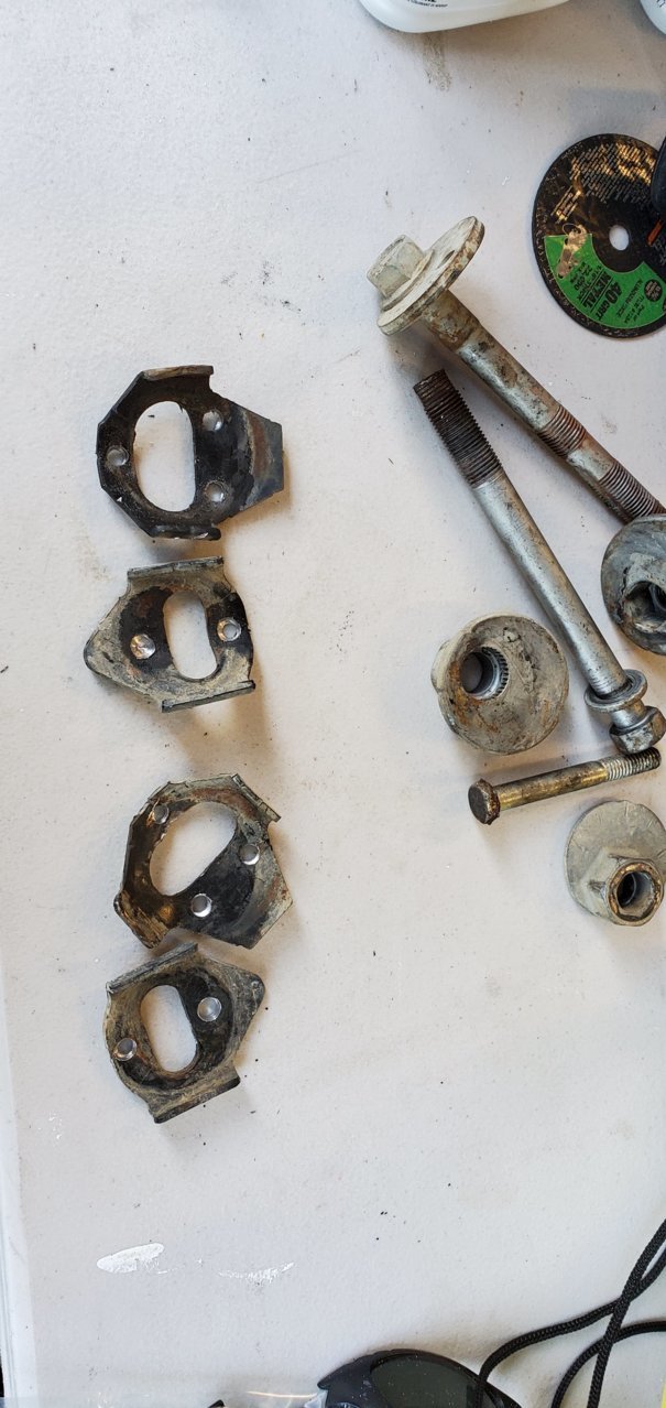

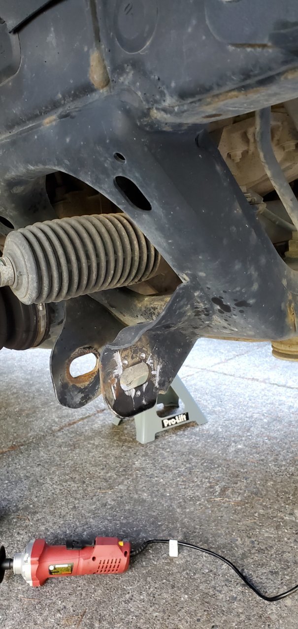

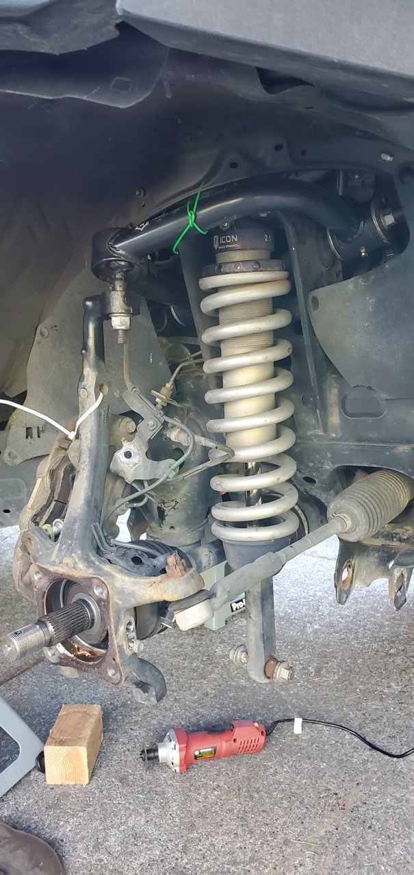

    Putting in the Total Chaos cam tab kit to replace the folded over tabs, SPC alignment cam bolts, new LCAs because my ball joints were blown out and replacing the bearing hub assemblies in the hopes it will fix the hum/grind from the drivers side. For the most part just maintenance items that I have put off for too long.

    Right on man! I just sold my TC cam tab gussets. I think I'm going to order the Marlin Crawler brace instead. Also think I need to replace my LCAs/bushings too. Looking at this to replace them.
    https://www.1aauto.com/2005-15-toyo...-ball-joint-set-trq/i/1asfk03366/1058377/2007
    And also do the passenger side hub. Then I think I'm pretty much done rebuilding the front.
    What do the SPC alignment cam bolts do? wonder if i should do that too.

    I went with these ones.
    https://smile.amazon.com/gp/product/B07ZHTMHSG/ref=ppx_yo_dt_b_asin_title_o05_s00?ie=UTF8&psc=1
    I figure even if they don't last as long as stock I will be able to clean up and rebuild everything on the stock arms and have them ready to swap back in down the road.
    I don't think there is anything too special about the SPC cam bolts, I had just read that the bolts and sleeve have a tendency to rust and freeze up so I picked them up in case. I ended up having to cut the sleeve on the passenger side to get it out so I am glad I got them.
    I haven't, since I already have these I will start with this and then if it is still there I will probably end up going down that road.
