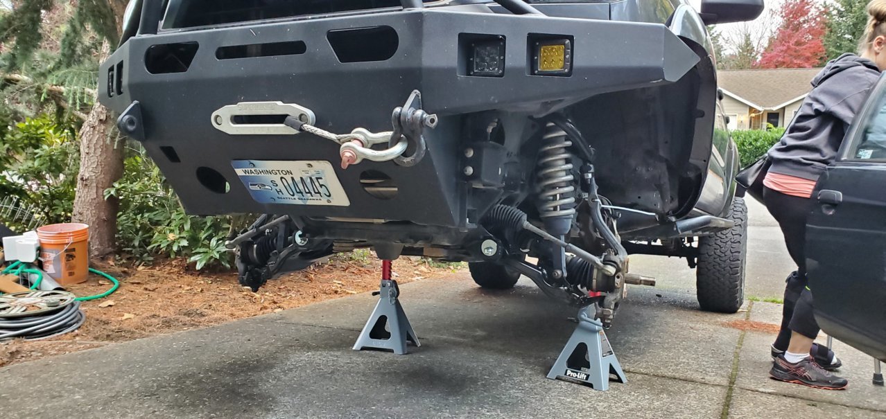

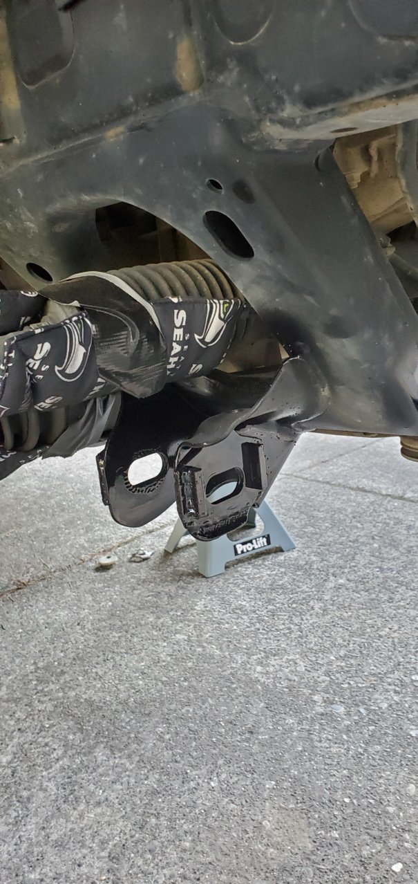

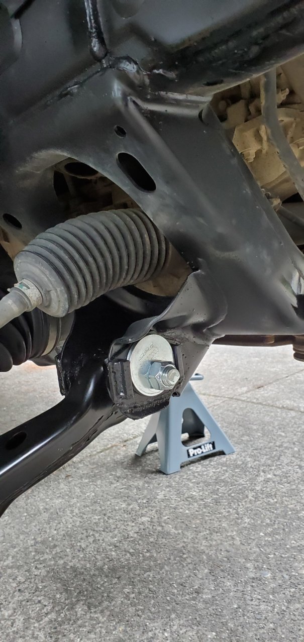

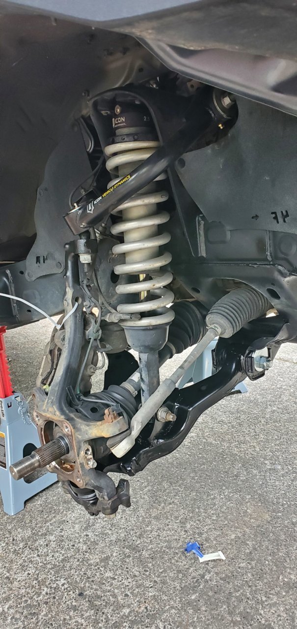

    Got the TC Cam Tabs done, new LCAs and new hub assemblies installed towards the end of the week. After an alignment Thursday and getting the truck back on the road I can safely say the drivers side wheel bearing was my issue, no more noise at 55-60mph now. I should actually be good to go for snow wheeling this year if we actually get any.

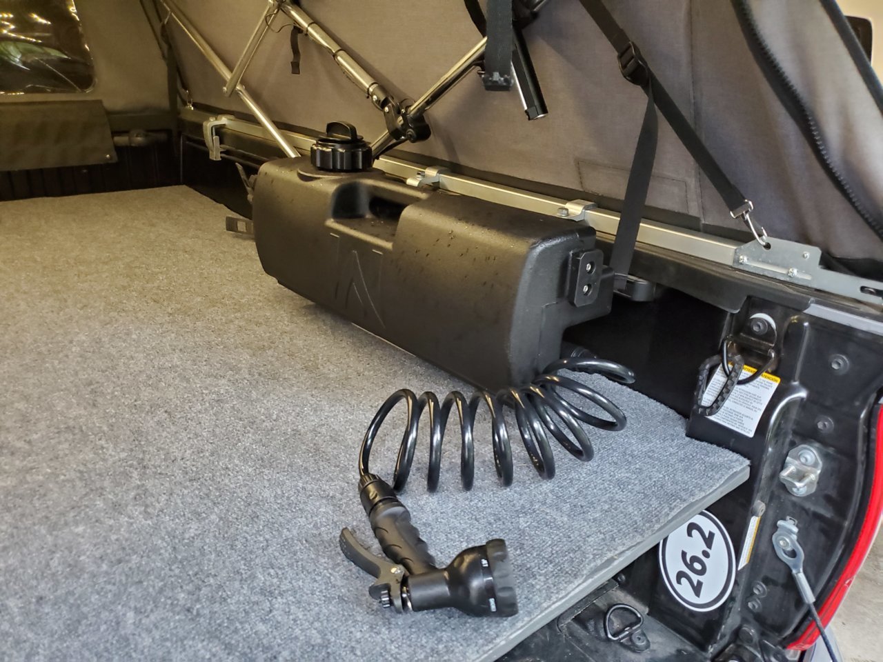

    Love my waterport. Used it to shower on my recent two week trip. Use it to wash dishes, spray off the dogs etc. Wish there was a way to hear the water.

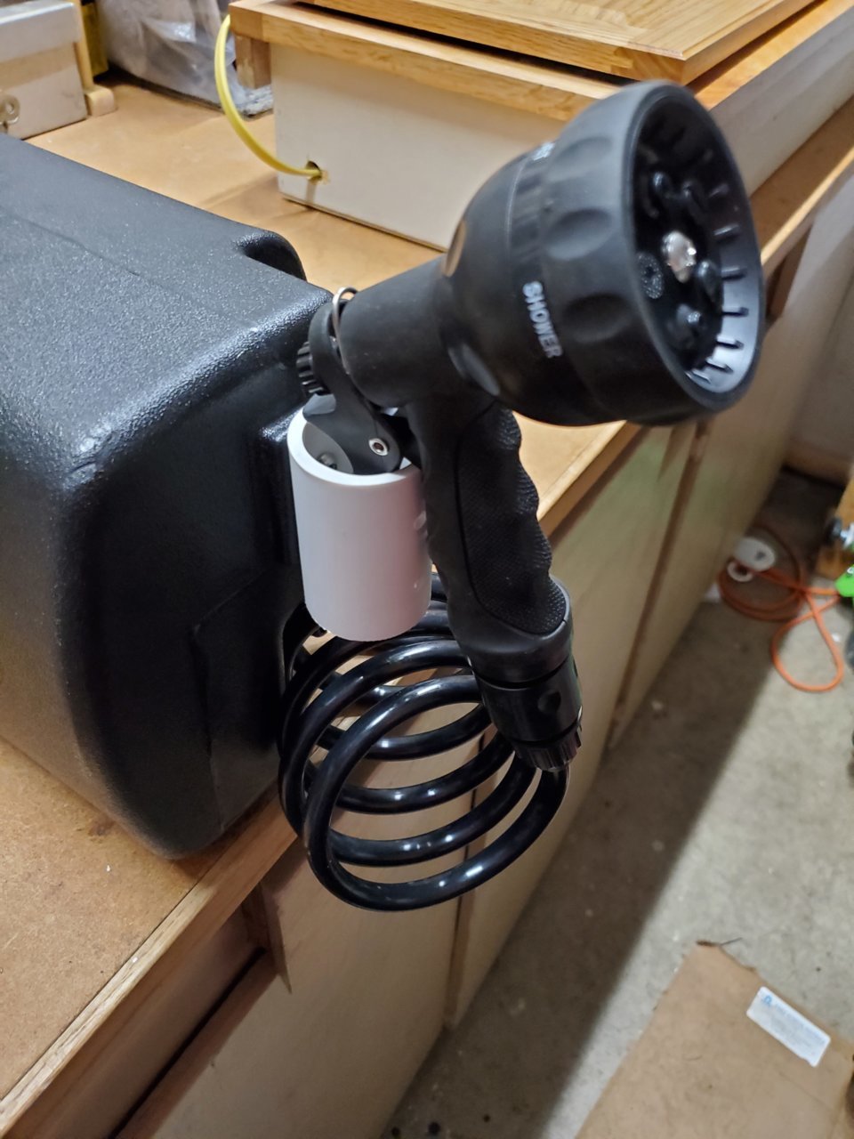

    I made a nozzle holder for the waterport with some scrap PVC. To bad I didn't have any ABS pipe scraps to match better.

    Do they come with the little coiled hose now? Mine came with basically a washing machine hose.

    Yeah, that's the hose and nozzle it came with. There are plastic quick connectors on both ends.
