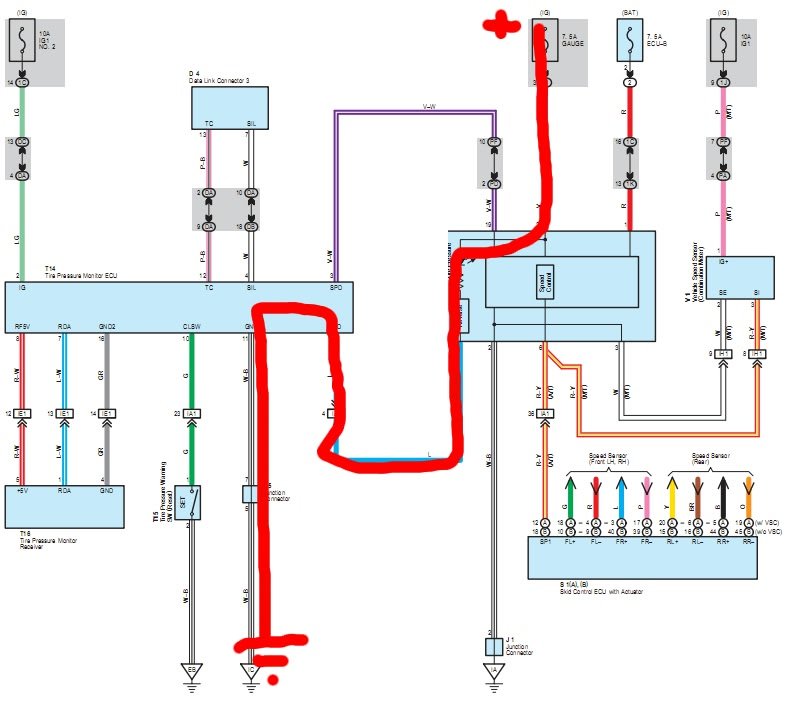

    I was originally hoping after 4yrs the LED would burn out but no dice.
    Yeah, I never get it right on the first or even the second try! 3rd times a charm or just shithouse luck. :D

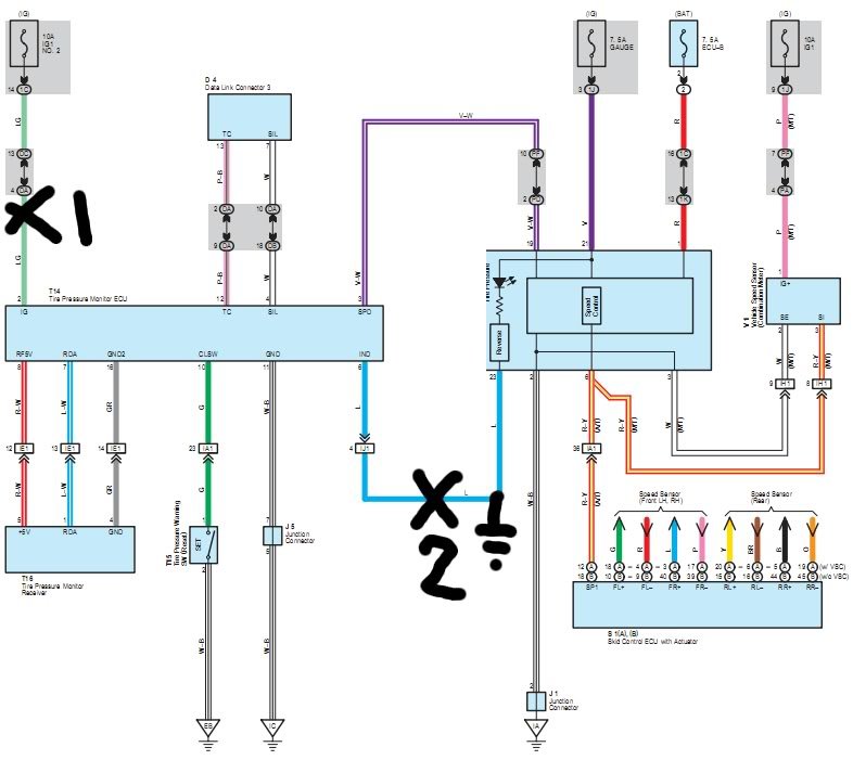

    It might be different in the later years, but my tpms module was located in the lower portion of the dash behind the cigarette lighters. I removed it, but that alone doesn't turn the light off. If anything, if your light wasn't on previously, and you pull the module, it will illuminate. The green + feed wire needs to be cut and taped to prevent accidental shorting, and the blue wire on the tpms module plug needs to be intercepted grounded to cancel the light. The wiring harness end of the cut is grounded, not the plug end.
    This is the post I followed for my 06
    https://www.tacomaworld.com/threads/complete-tpms-disable-guide.161292/#post-3287018
