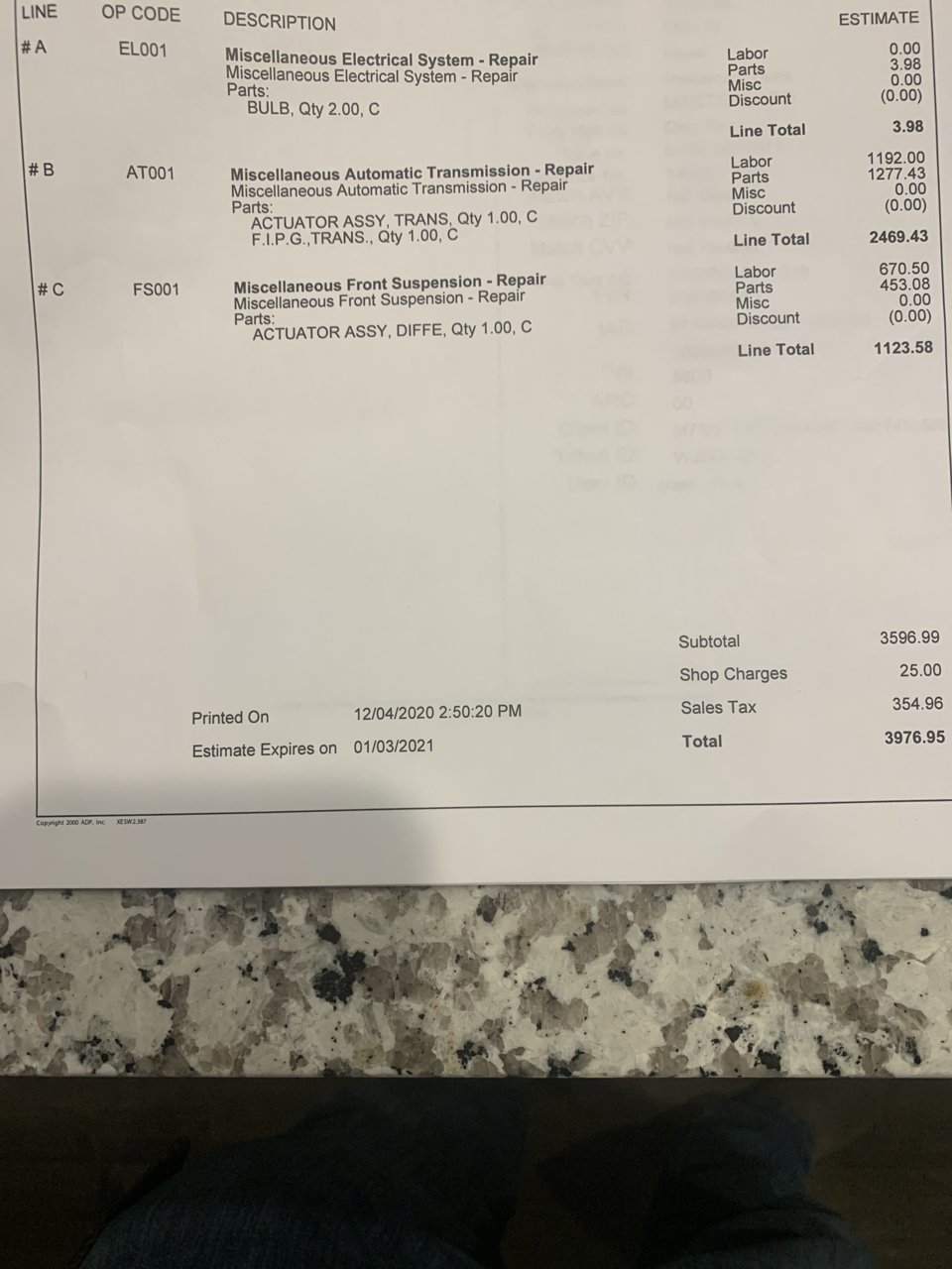

    They’re guessing the t-case actuator. All electrical looks good from their continuity test. I need to double check my t-case oil too as I held off on draining since it seemed purely electrical. Also the t-case takes the most oil. They had another customer go through this on a newer 4Runner that has been a lemon. They did the actuator before finding a shit ton of shavings in the t-case. Luckily I checked that when I get home and I am good to go. No shavings in the transfer case drained it all just in case. There was glitter but not anything bigger than a millimeter. (Measured). One odd thing is that with all four tires jacked up only the driveline is spinning now, and before tires were as well. Another thread noted that when that happens it’s generally the front actuator. That was bench tested and runs good though (unless it just went bad).
    TLDR; my question is it possible that because pushed my shift rod back to 2wd, and I slid my ADD sleeve back to 2wd would the symptoms present themselves differently than that diagnosis step? Toyota wants to do t-case actuator and then re-test the front, if everything was required $4000 out the door :O.
    If anyone has a used t-case actuator I may want to buy it off you, maybe @bobsuruncle , I am thinking sourcing parts for the FJ t-case may take too long.

    if your front driveshaft is spinning but the tires aren’t then your t case is stuck. If spinning the tires spins the driveshaft than your front disconnect is stuck. Just cause it bench tested fine doesn’t necessarily mean it works fine in the circuit since it has to have the interrupt internally working to know if it’s shifted far enough and what not.

    Yep that's true, @Shadowhunter was telling me a story on that for his t-case actuator. Yeah so just checked on the ground and the front driveline will spin freely, with resistance so your t-case stuck comment makes sense. Guess I will still start there then, just onto the parts sourcing for that then too. Just to be clear, when you say your t-case is stuck, do you mean the case itself is stuck or just the actuator? Seems there was no shavings in there so I would be surprised if there was internal binding.

    Yeah I’ve had the Tcase actuator fail and couldn’t get out of 4wd. Ended up just swapping a lower mileage tcase in to fix.

    wow that’s wild that they’re almost the same as the actuator new from overseas lol. Used are pretty cheap too. Will look into this route too...
