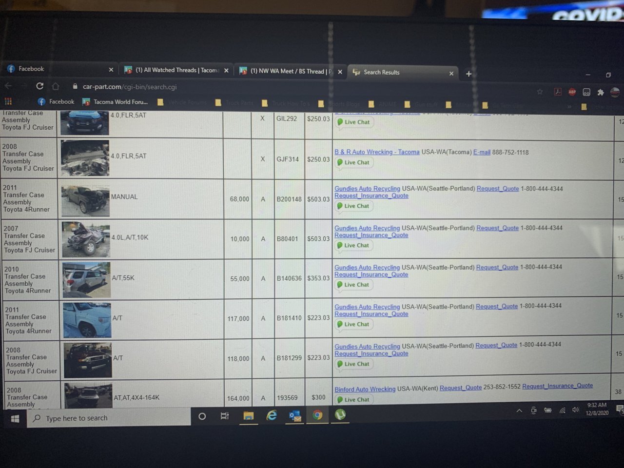

    I got my case from car-part.com.
    hell I got a set of twin sticks to sale.

    Thanks everyone. I thought the cost seemed a bit outrageous but everyone got to make a living. I have checked Craigslist but no luck so far, have seen some on car-part so maybe need to dig a bit deeper in those sources. I will probably look at just sourcing the parts myself. I know there are a few people trying to make a few extra bucks welding smaller projects for the holidays. I am still undecided on twin-stick vs. j-shift if it is truly going to make the job more difficult.

    A couple between 250 and 300 around Seattle.

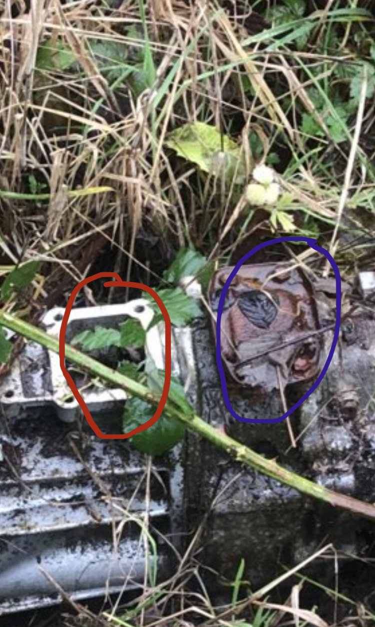

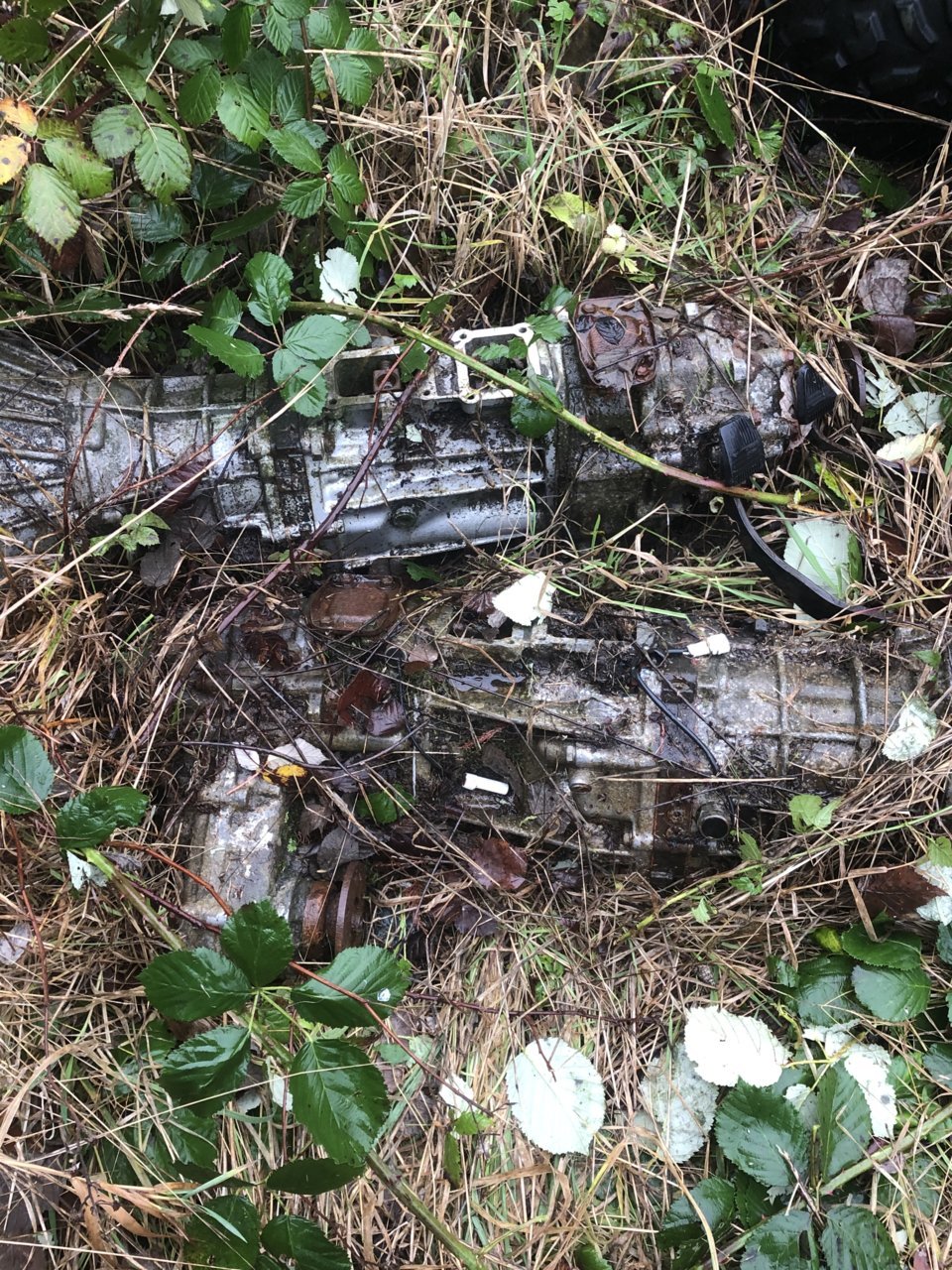

    1E024FEC-BAE0-4FF3-9285-83989A3721DF.jpg I guess the first step to building a crawl box would be drag one out from under the bench and go out in the bone yard and kick the blackberries off the old junk. I think it’s going to be a slow ass build as Marlin releases the parts and pieces. Gotta start somewhere.C33A3E3A-493E-42BB-B3DD-1926E0A98227.jpg

    haha...squirt....haven't seen that in years

    I think it was in the bag of mystery gears:anonymous:

    I’ve been hitting up friends to find one so i can start building one

    Your welcome to have one. The two outside are forward shift. The case is probably the only thing worth a fuck.

    Is anything salvageable or do they both need to complete rebuild?

    I would say probably a rebuild. They were laying outback when I bought the place under a blue tarp that’s disintegrated into the ground.

    T-A-R-P is just part spelled differently. I’m definitely interested, what’s the forward shift mean though?

    The shifter for the tcase is in the transmission housing. Forward of the tcase

    Where the TC shifter sits. Forward shift TC is in the red circle. Under the crusty cover in the blue circle is where you can swap in the top shift rails and forks.https://www.lowrangeoffroad.com/top-shift-conversion-kit-a.html
