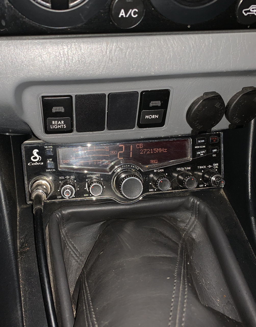

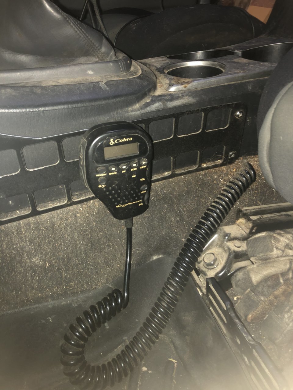

    12EB4023-9BB2-4472-94E9-65F1380A0DAD.jpg I have the Cobra 75 WX ST. It’s super compact, about the size of a Twinkie. It’s zip tied to the bracket above the inverter and I ran the mic out from underneath. Super clean install... truck not so much:anonymous:

    Got any pics of that in good lighting? Thought about putting mine there at one time but wasn’t sure the best way to do it

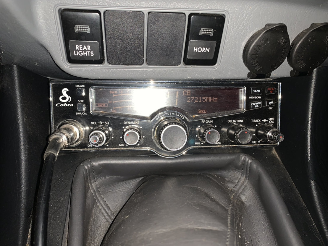

    I have one of those in my GX

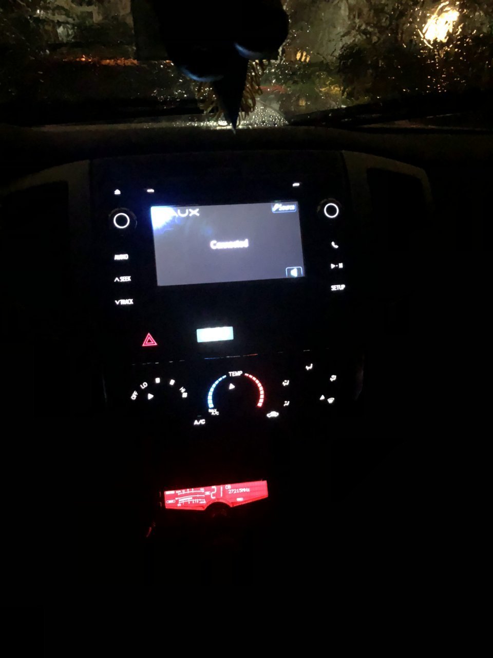

    It works through car speakers
    I used the aux jack behind the dash and extended the usb in the arm rest

    U just cut a hole and shove it in there?

    Haha I found those buttons at the junk yard in a Tacoma a while back
    Since I got rid of my aux and ubs that was right there I just put those buttons in they are not hooked up to anything yet and I need to remove those decals

    Cut ,trimmed , used a hear gun
    It fit in there really tight but that’s good
    It has 0 movement

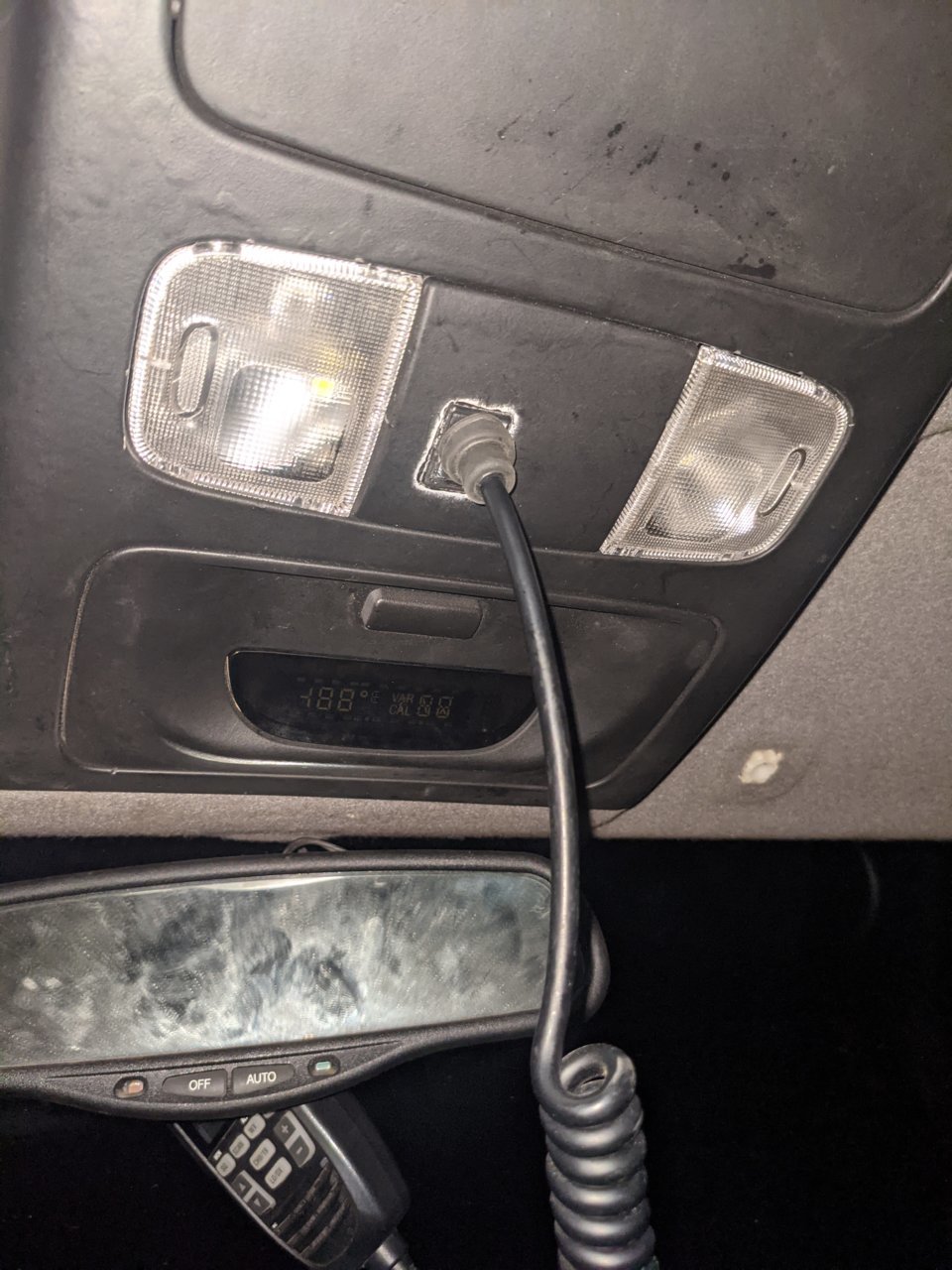

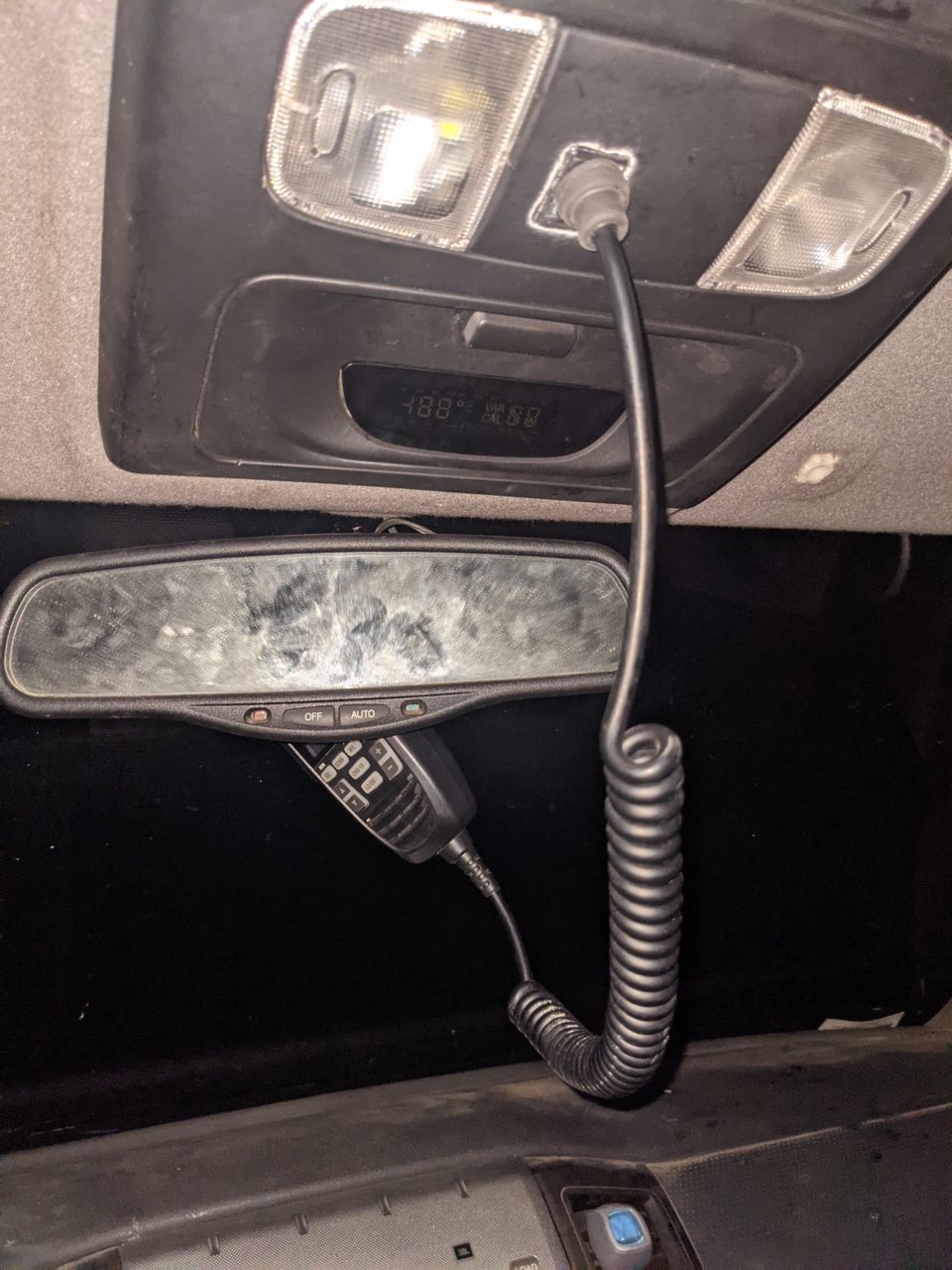

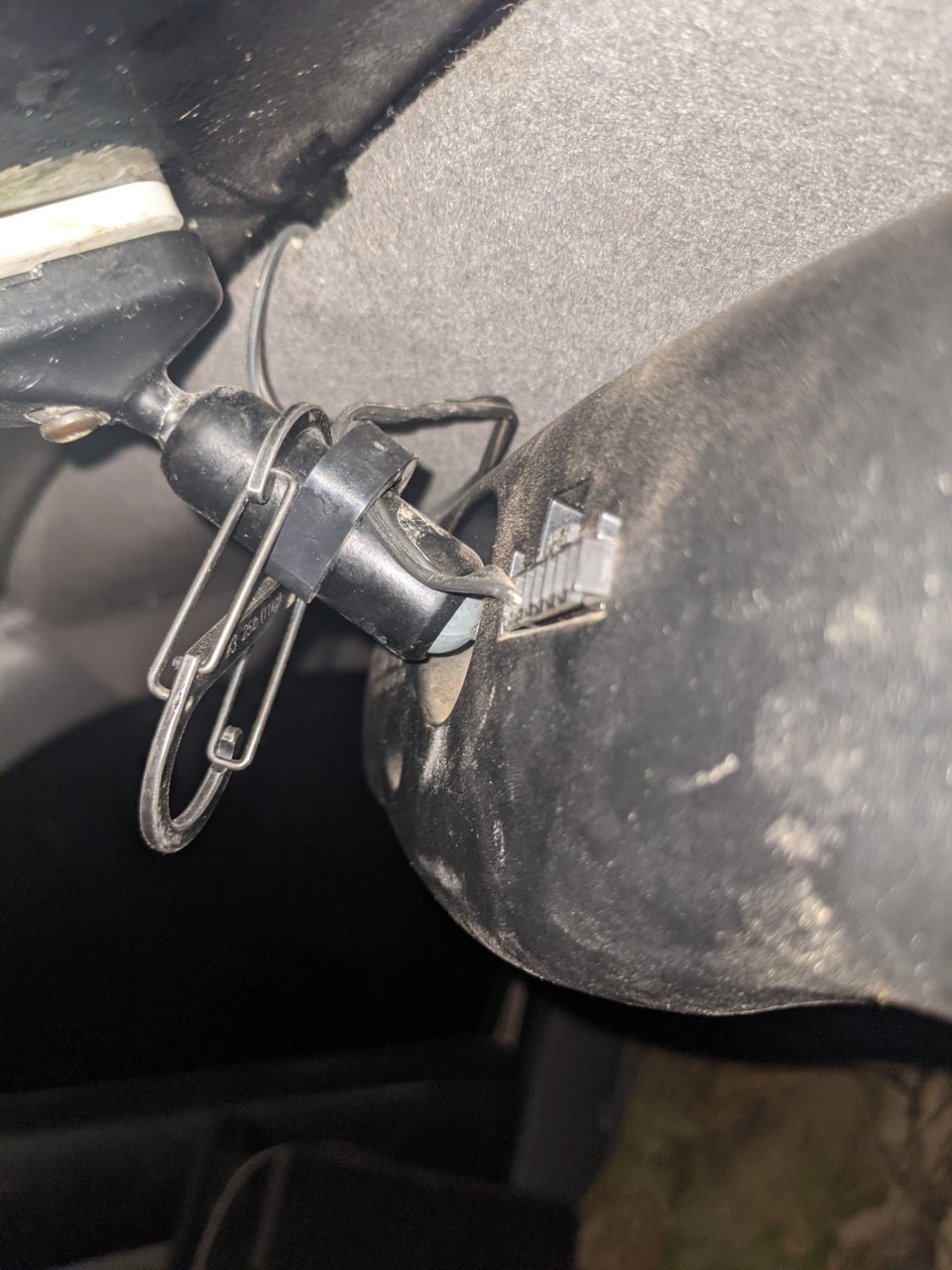

    It's a pita to get into the headliner, but I have my uniden cmx-760 up in the roof, and cut a hole for my mic to plug into between the map lights. I let it hang from a carabineer hooked to the rear view mirror arm. Or I can unplug the mic completely band stash it in the center arm rest console.

    I was wondering if this spot would be missed otherwise was on the same boat with the rest of you. Generally having a passenger I am thinking either the lower junk space or side of either seat. Pretty awesome you have it that integrated @wrmathis

    Ah this is an idea for me too since I don’t have shit up there right now haha. Anything you followed for this, or just figured it out?

    Just winged it. Ran the power and ground up the A-pillar and then the coax towards the back window and then down to a hole below the back window then on out to my antenna. Cut the hole between the map lights small and mm by mm got bigger until the plug was snug and then some super glue to make sure it wouldn't move.

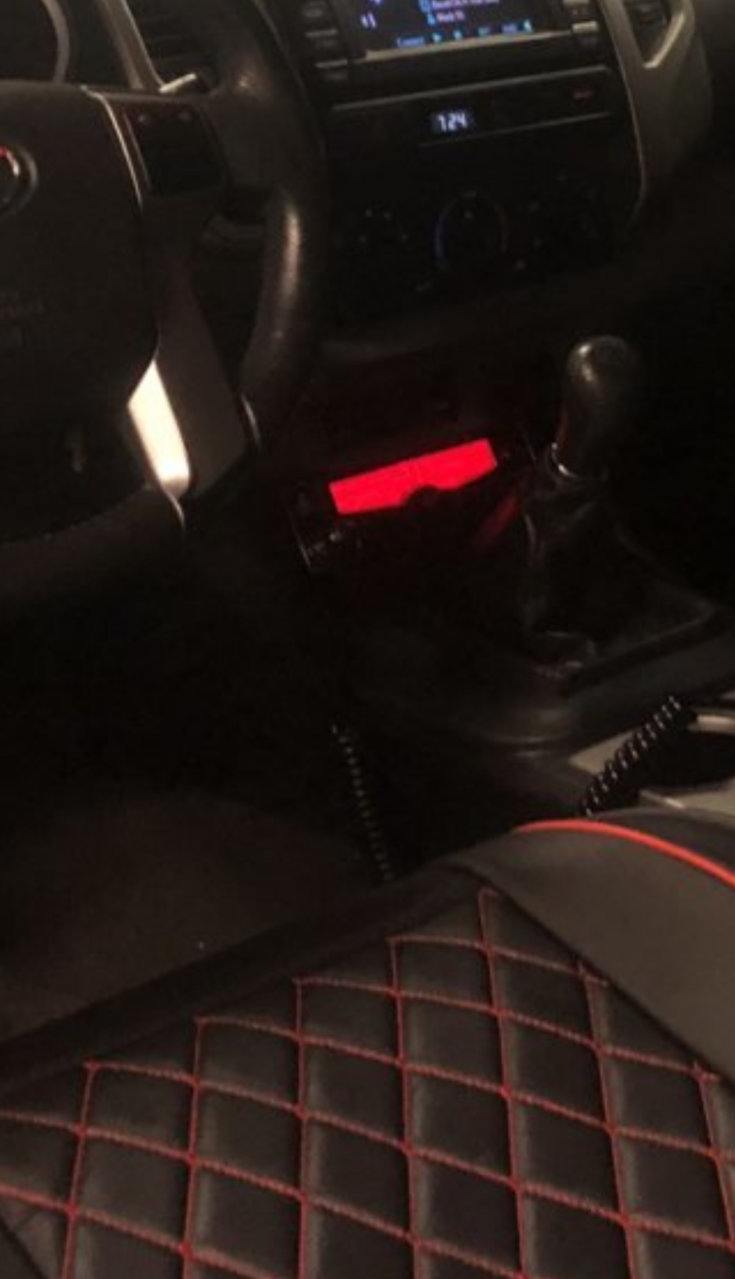

    Is the driver-seat mount uncomfortable @DoulosXP?
    Not at all. Only time I notice it is when an alignment tech, that was taller than me, carelessly move the seat back causing the radio to slide with it (if you do this leave slack in the wiring). Otherwise love the location.

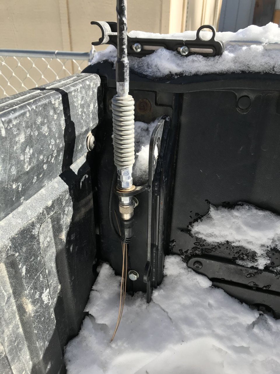

    Just make sure the antenna has a good ground, like real good. Box doesn’t need ground it’s just a safety in case lightning gets friendly with the antenna

    This right here is the most important thing. A lot of people overlook it and waste time trying other things if they have issues with swr or tx/rx issues and 99% of the time it's grounding related.

    This is how I mounted/grounded mine712567F8-F15F-4593-B439-3151F7A86C3E.jpg
