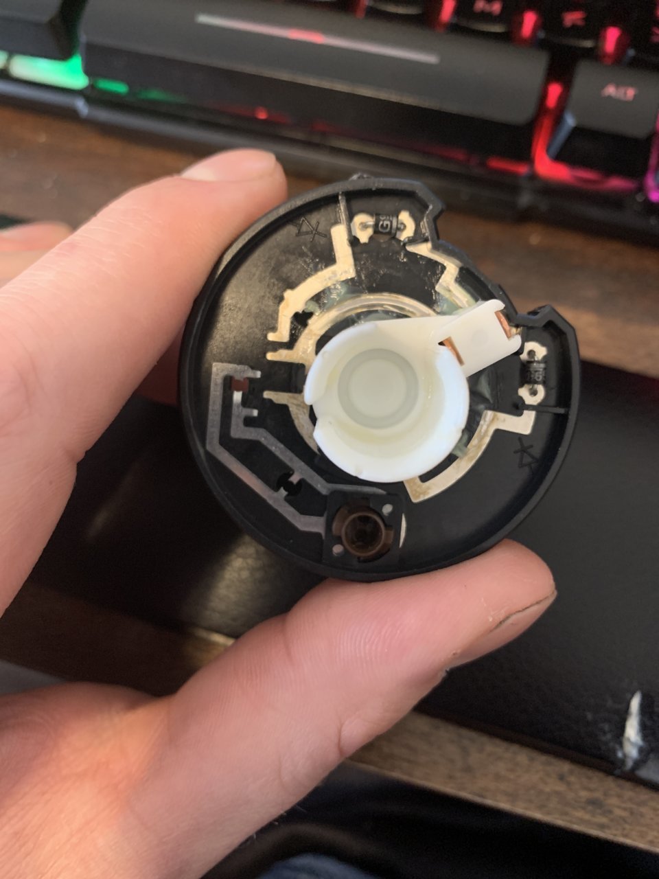

    image.jpg Pulled the 4wd cab switch apart today. I did not assume there was this much electrical in it. Tested continuity and the strips are good, don’t seem too corroded. Will still clean them up and add grease. Across the two diodes there is not continuity. Not sure if that’s expected but I am assuming it’s bad.

    Make sure you're testing the diode with the correct polarity since they only pass current in one direction. Like a check valve for electricity.
    https://www.fluke.com/en-us/learn/blog/digital-multimeters/how-to-test-diodes

    Ah thanks I had it right for one side but backwards on the other both drop about .420-.450 for each
    “ agood forward-based diode displays a voltage drop ranging from 0.5 to 0.8 volts for the most commonly used silicon diodes. “
    Sounds like they’re on the cusp...
    If anyone is feeling brave and could check theirs, that may help me narrow down if this needs replacing.

    Fixed the 4wd again wasn’t the switch the ADD went out after the solder fix worked for one trip lol... oh well it’s working again for now. As for rear axle play, no wheel play but it does sound the the right rear bearing is going dry or brake rubbing. When you guys replace your rear wheel bearings are you doing your axle shafts as well? Pops recommended to do so but doesn’t seem necessary.
