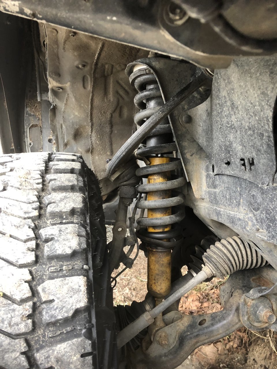

    When I finish up with the rear that whole coil over is going to be blue and chrome.

    limit straps or a uniball setup

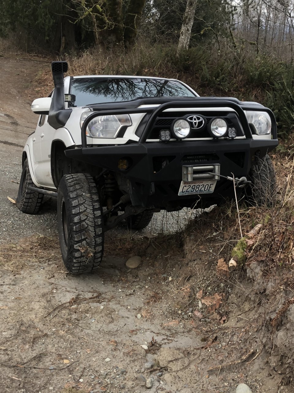

    I noticed something banging in the front end on the WADBR going over baby head hill. I’ve heard that noise before hauling ass across string of pot holes That might be the culprit.

    First thing my kid said was maybe it’s time to step up to total chaos UCA’s.

    stock uppers? you don't want to do that with a lift. ask @bobsuruncle.

    Spc uppers

    ah ok. I've never had aftermarket uppers hit coils. They don't look happy in that second pic though.

    yellow and black is where it’s at ;)

    Isn't ADS black and gray?

    black and white if they are from Headstrong Offroad. They deal in enough volume ADS let them customize the color and valving. black and yellow is direct from ADS or any other dealer.

    Straps. Limit the down travel to eliminate the contact.
    I'm not an expert on ball joints, but that angle looks beyond full retard for what a ball joint can handle...
