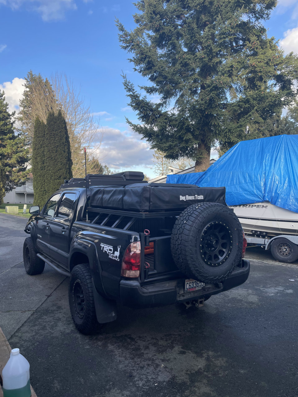

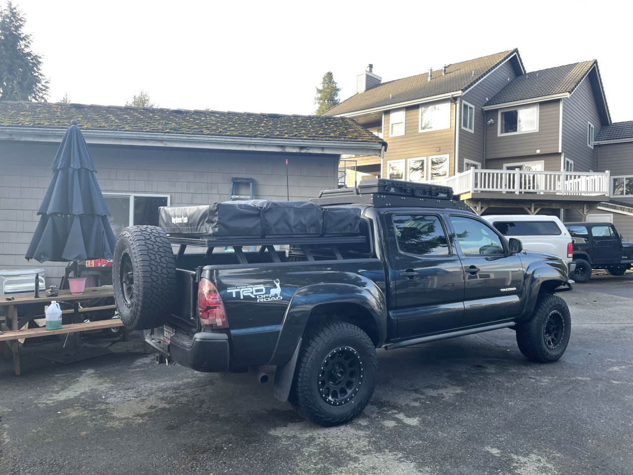

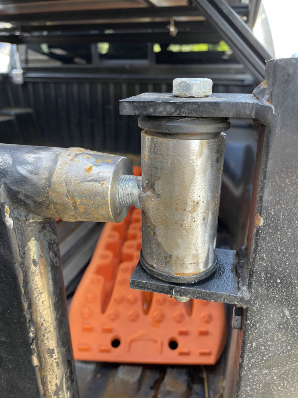

    Made a few changes to the swing out tailgate. I added a threaded bung and a heim joint to the top hinge so as I add weight I can adjust the tailgate up and down. pretty happy with how this turned out especially since it was only about $350 in parts compared the $1800 wilco tries to charge.

    Nice work:thumbsup:

    I like this idea of replacing the tailgate with a swingout. Just one step to get into the bed instead of swingout and then dropping the tailgate. Nice work. You could probably sell these if you felt so inclined.

    Looks good, you might want to get rid of
    the rubber bushing and find something more dense, that one will be chewed up
    In no time
