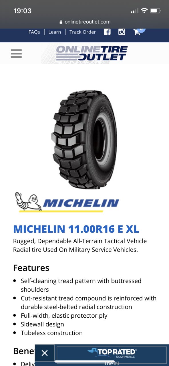

    I hope you find some, I would love to have a set of skinny 36’s for playing around. About the only thing I’ve found is a Michelin XZL 255/100/16

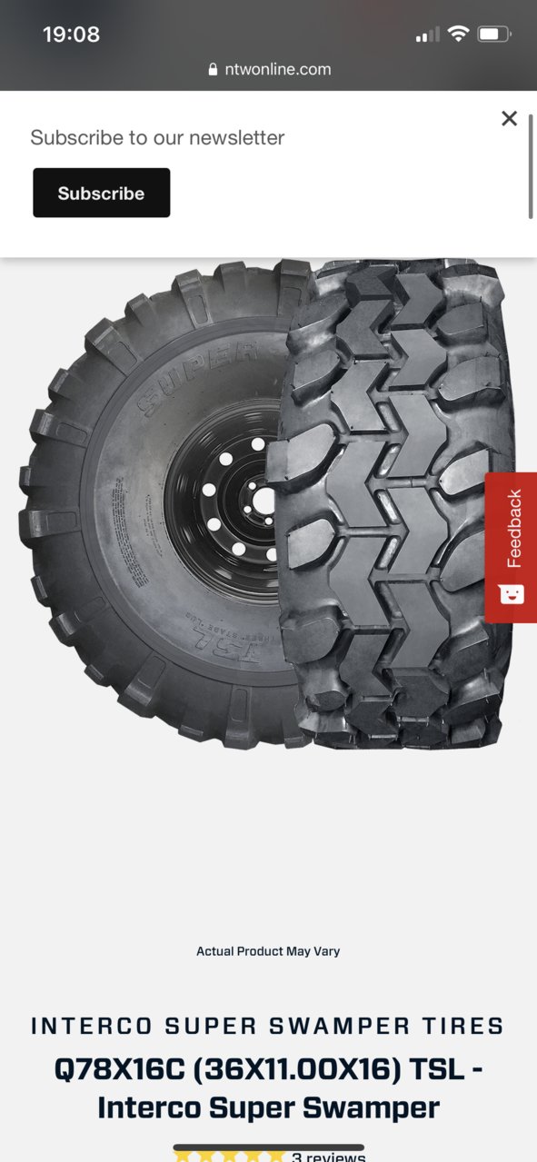

    Super swamper TSL in the size Q78, 36x10 IIRC
    Edit: i quoted the post before i saw someone already mentioned q78's

    Heres some info from the famous Scott Brady. Founder of expeditions west, expeditionportal.com and overland journal magazine.
    Benifits of a skinny tire are:
    "Less rotating mass- Easier to start and stop
    Less reciprocating mass- Easier to dampen
    Less wind resistance- Better economy and range
    Less rolling resistance- Better economy and range
    Easier to fit a taller/narrower tire with less lift
    Lighter spare
    Lighter tire
    Lighter wheel
    Less unsprung weight
    Less weight and leverage on steering components, bearings, etc.
    In terrain:
    1. Less frontal resistance in mud and sand. Where is most of the increased contact patch (for flotation) gained? In the length, not the width. Tall and narrow allows for more length and greater deformation with less resistance.
    It is as simple as understanding the coefficient of friction (COF), which is (Ff = Cf x Fv).
    Ff= Friction Force
    Cf= Coefficient of Friction
    Fv= Force Vertical
    As you make a tire wider, you reduce the Fv over a larger area, but gain Cf. As you make a tire narrower, you increase the Fv, but reduce the area of contact, which lowers the Cf. It is proportional, though there are times when the material interaction (lets say a drag tire on concrete) favors Cf, but those conditions rarely exist on the trail, on a perfectly flat surface. So, if a wide and narrow tires benefits with relationship to Cf and Fv are proportional, than the decision must be made on other factors, like weight, resistance, etc., as listed above.
    Now of course, there are limits at both ends of the spectrum. Too narrow of a tire, and the torque applied to the surface, even with extremely high Fv (which a super narrow tire would have), would exceed the rubbers ability to resist tearing. Literally, burning rubber.
    It is all a balance, with tires for most of the trucks we drive being ideal in the 9-11" wide range."
