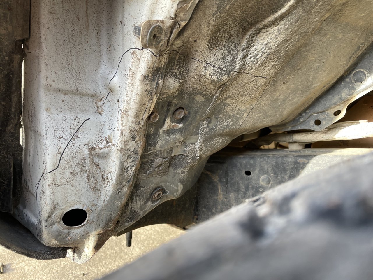

    There’s a very thin line of you look closely

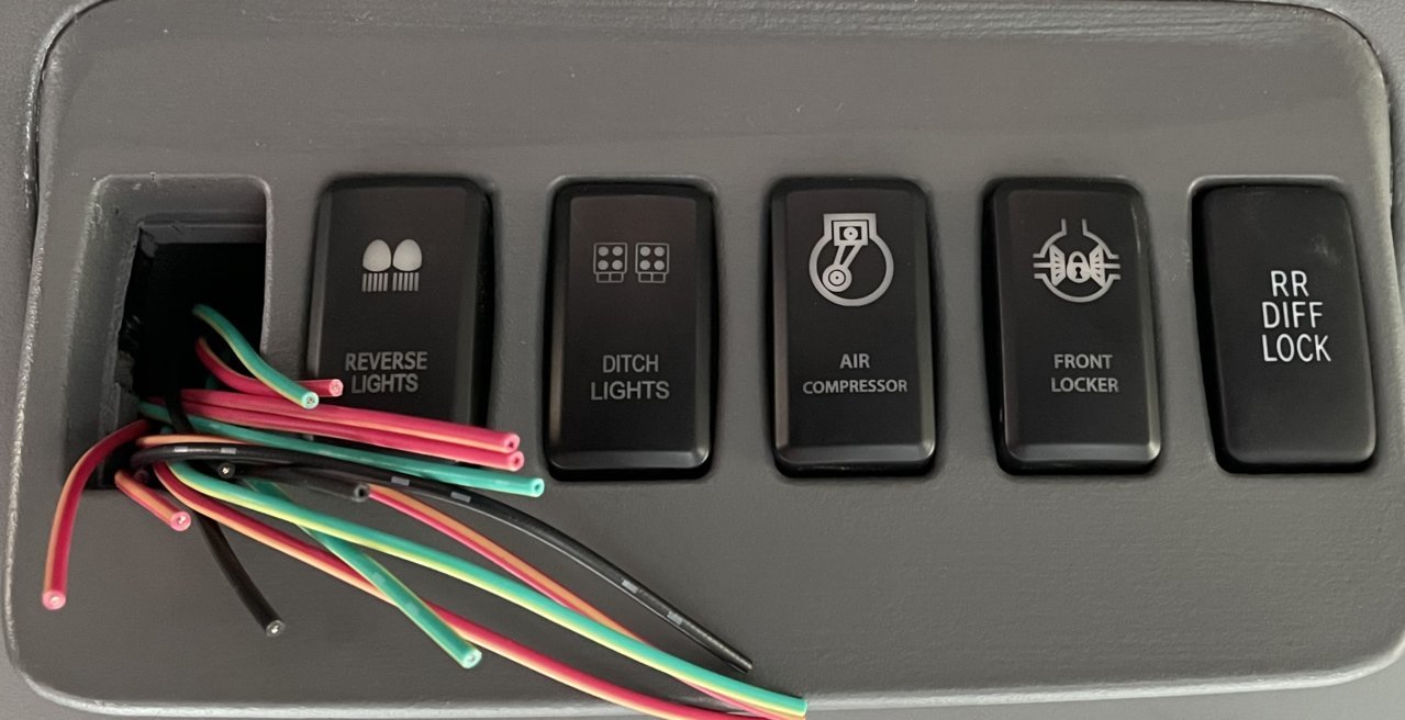

    Finally bought switches, now I’m waiting for the wiring to show up

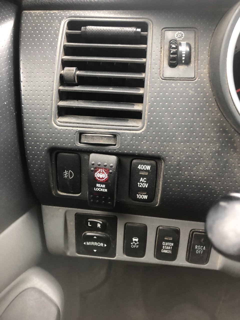

    I would love to have my diff lock on a push and not a rocker. It hasn’t been there 3 months and I’m on my second switch because my dog keeps stepping on it when she’s hanging out in the truck.

    Ya i have mine in the same panel as the cup holders, I’ve activated my front locker and air compressor more by dropping something on the switch or bumping it than actually turning it on on purpose

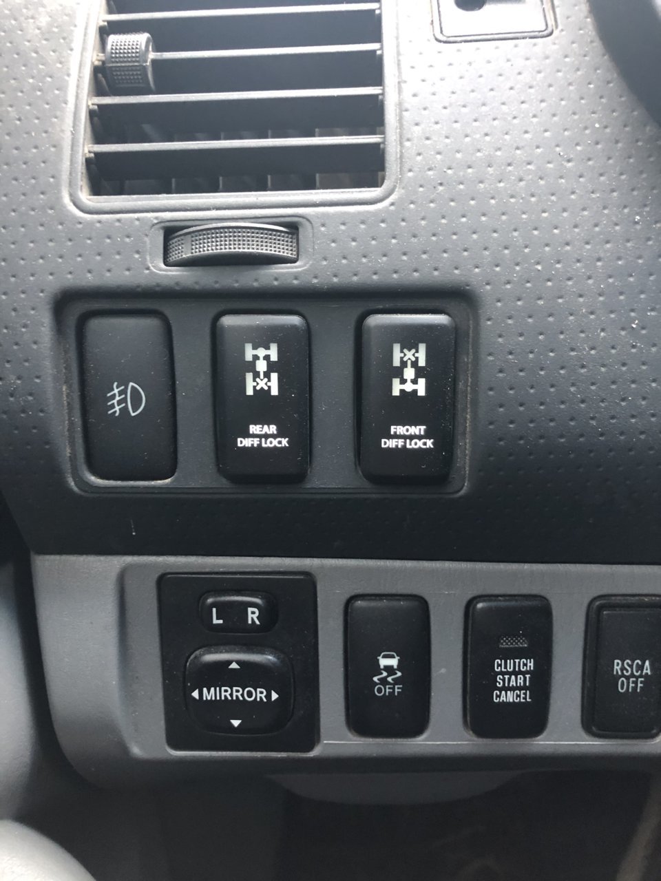

    Hmm... that might be worth ordering and taking a look at. Where would I tap into to make the Diff lock light come on in a Sport. I have the low range off-road wiring harness which uses a DP/DT switch. When I get a chance I’ll dig into it. I’m assuming with your front elocker you taped in somewhere for that front locker to switch the light on but I might not have the wiring.

    After my axle swap I rewired the Harrop locker to the factory RR diff lock switch and ditched the ugly Harrop rocker switch. I have the diagram of the factory switchback somewhere if you want it

    Yellow blue wire in the cluster harness needs ground

    @Shadowhunter you could tap into any of your other backlit switches, for my front locker switch I just tapped into the illumination wire from the factory rear locker switch

    Yeah this works fine, I tapped into the fog light switch since I was putting a new switch next door. Worked fine. I used a test light to verify which was hot with the marker lights on.
