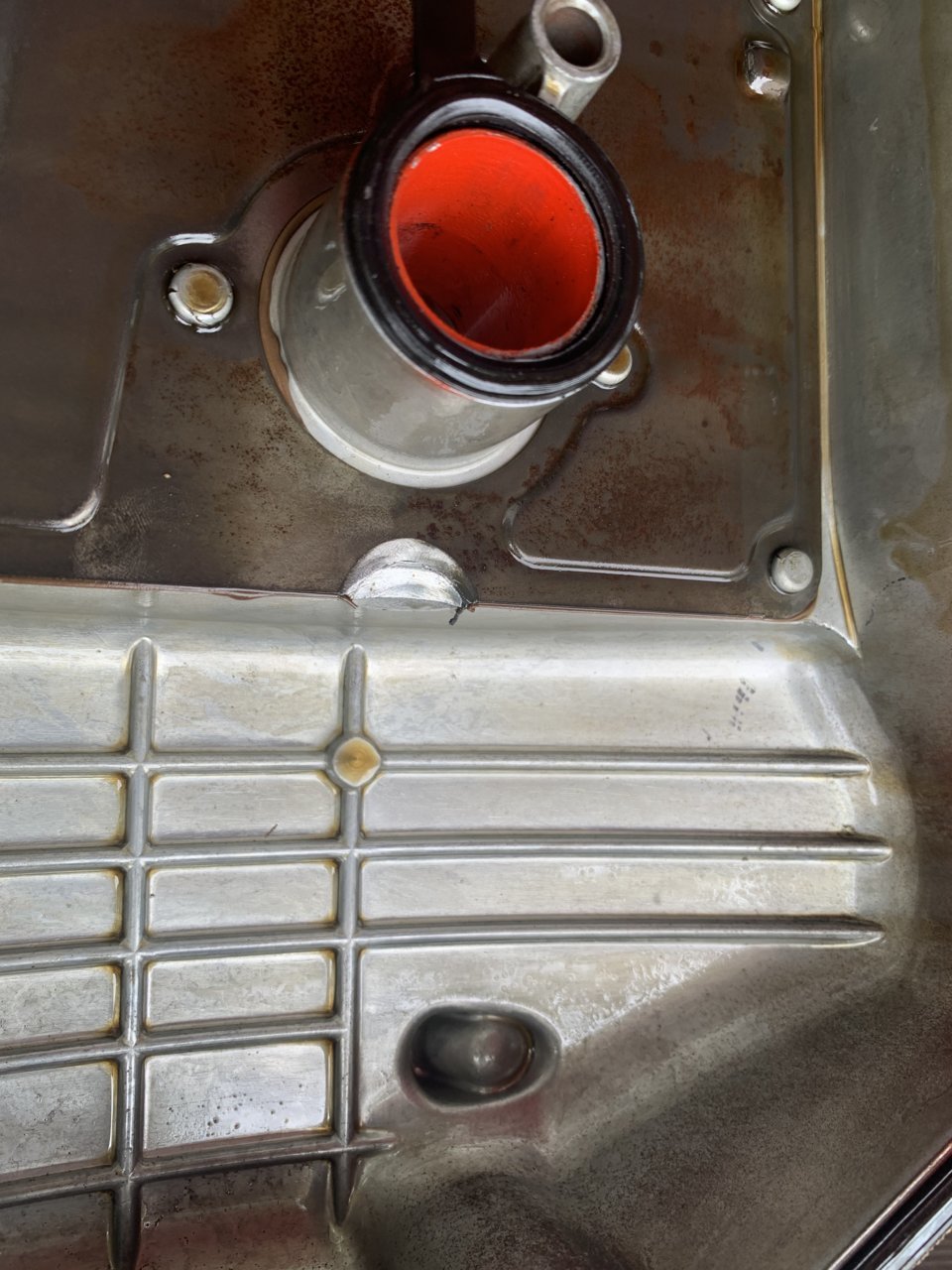

    looks fun, i am actually pulling the motor on sunday. also, make sure you torque down your tensioner bolts. ask me how i know

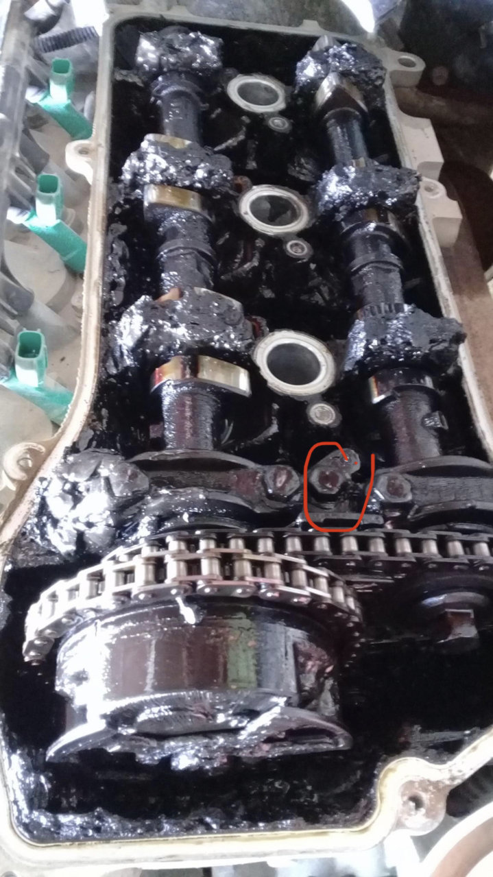

    CF9E0611-0DC1-4828-AC5D-3003F083002F.jpg That one?:anonymous:

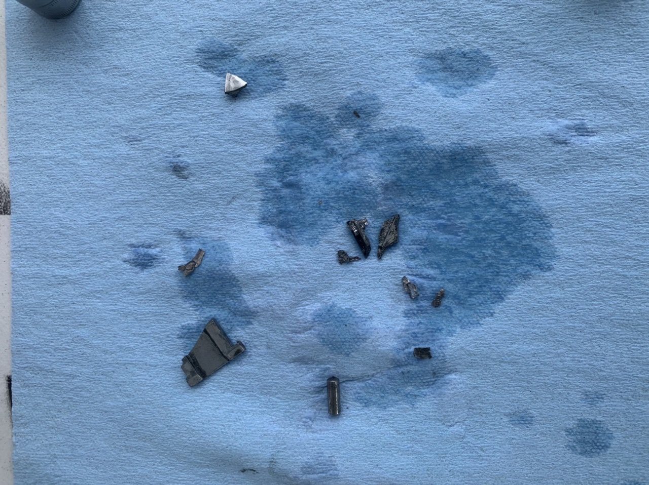

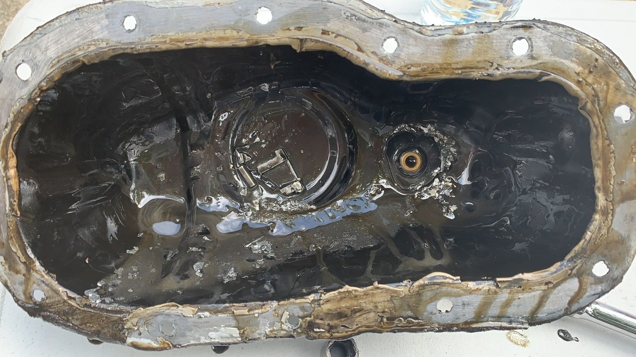

    Yup. This is what it looks like when it backs out and the damage it can cause

    And there was a whole lot more metal than what’s shown

    Feel sorry for the next guy, it’s getting some 202 before I put it back in now. That shit isn’t going to happen. That sucks.

    yeah. it took almost 8 years for it to back out. but it had been making noise for a while now. maybe 2 years? i just thought it was idler noise. think the bolt was just loose and it was flopping around and then last friday, the bolt came completely loose and everything just let go.

    I torqued everything going back together on mine last year:fingerscrossed: Thanks for the heads up this one will gets special attention.

    Damn that bolt is only 14# I went 16# and some 262 loctite.

    mine also made the dowel pin wiggle itself out of its hole too
