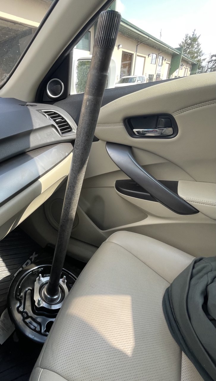

    I really just would need the driver side axle shaft with the wheel bearing and drum backer plate!

    lol you’re in the same boat as I am. I ended up buying the parts and taking the axle to auburn off road since apparently no one has he special tool to pop it off.

    Thats what i'm seeing too, i have a toyota guru friend who works at a machine shop and we found the FSM for doing the job but i see you need the special SST tool or whatever its called

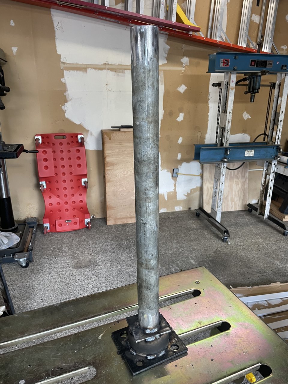

    if u can get an old axle housing, you can cut it down and basically make the tool. pretty sure there is a youtube vid somewhere showing how to do it

    that's good to know, makes sense... but i think @Shadowhunter has what i need

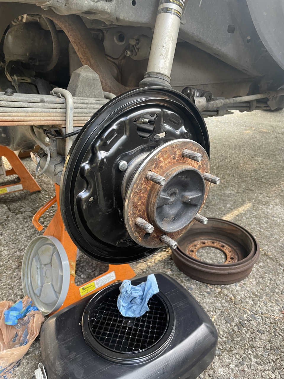

    Dorman has these prebuilt axles with backing plates and everything assembled but only for 4runners
    we didn’t have an old axle housing so we welded one together and it failed spectacularly lol. Ended up making the welds strong enough but wound up bending 2 of the studs. Dorman makes preassembled axles/hub/backing plates but only for the 4Runner I think. No idea why they don’t have one for the Tacoma.

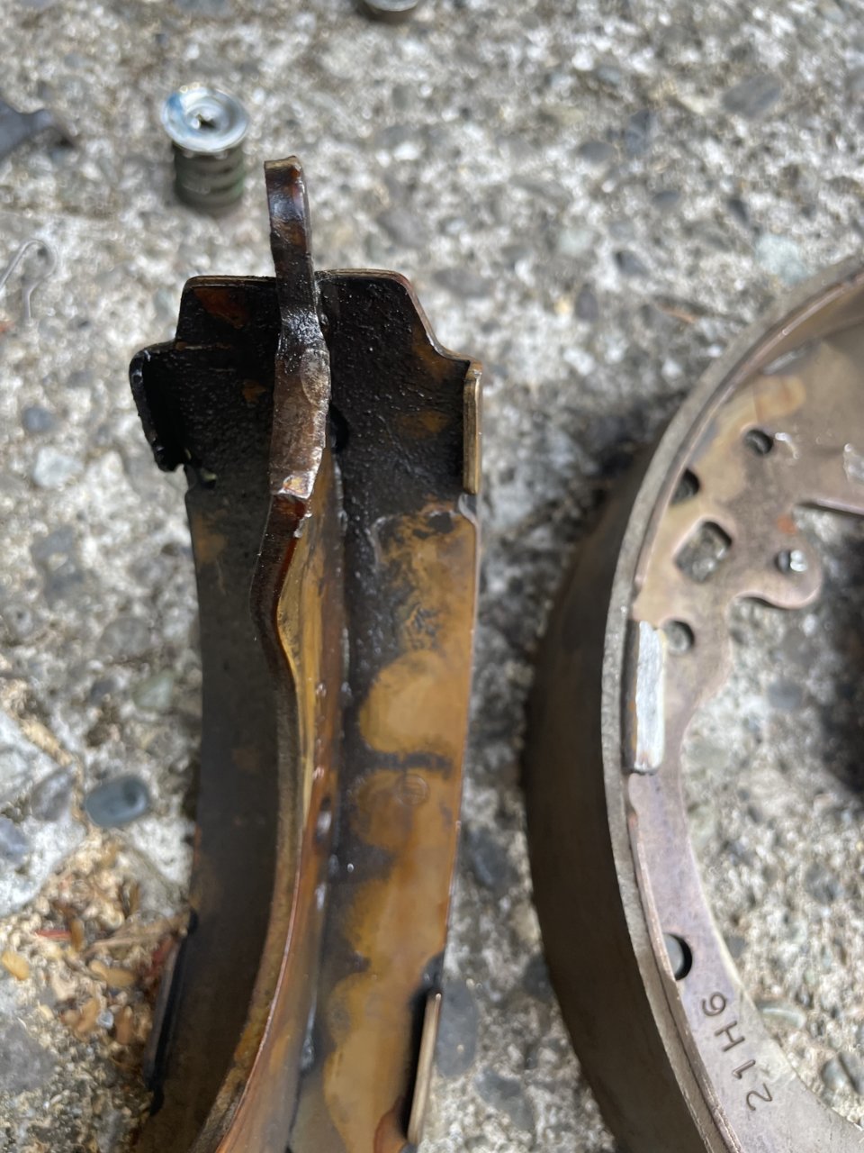

    Both my brake shoes are twisted up at the bottom too, bigger problem is the bracket at the bottom pulled through the backing plate

    yeah you can see in my video my bracket is super loose, almost falling out as well. Stupid drum brakes…

    I swear I’ve seen some Russian You Tube video where that tool was the star of the show:rofl:
