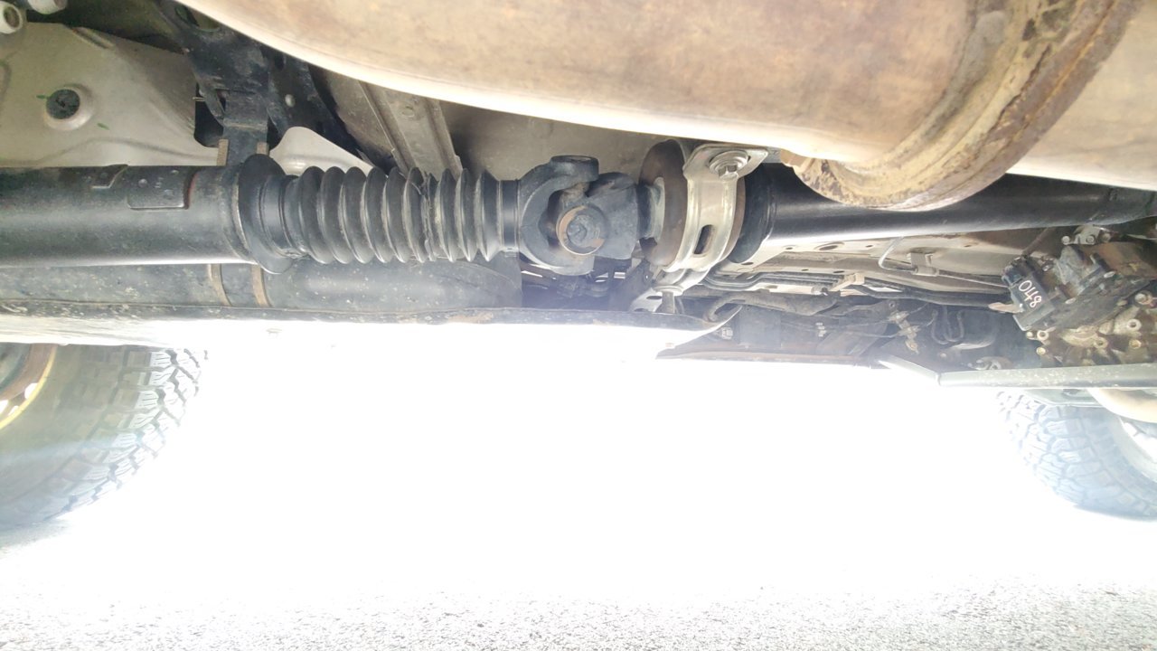

    Yeah I just put some new leafs on and I vibrate at 25 with shims and doubled up shims and I vibrate at take off without any shims. I’m very close to just getting a 1 piece driveshaft

    With my truck the way it sits at ride height and the pinion angle it has, the carrier bearing is actually lower than the direct tcase to pinion line. So with a 1 piece, it actually sits higher up, especially if the rear sees any compression and when it also sees axle wrap which points the pinion further up. I had to cut the center of the carrier bearing crossmember out since the 1 piece tucks up almost to the cab

    Well no wonder it’s so smooth it’s practically straight. My angle is pretty bad with a 3 inch lift in the back and 2 inch in the front. 59235387-EDCF-490A-BE24-F9B93C995561.jpg
