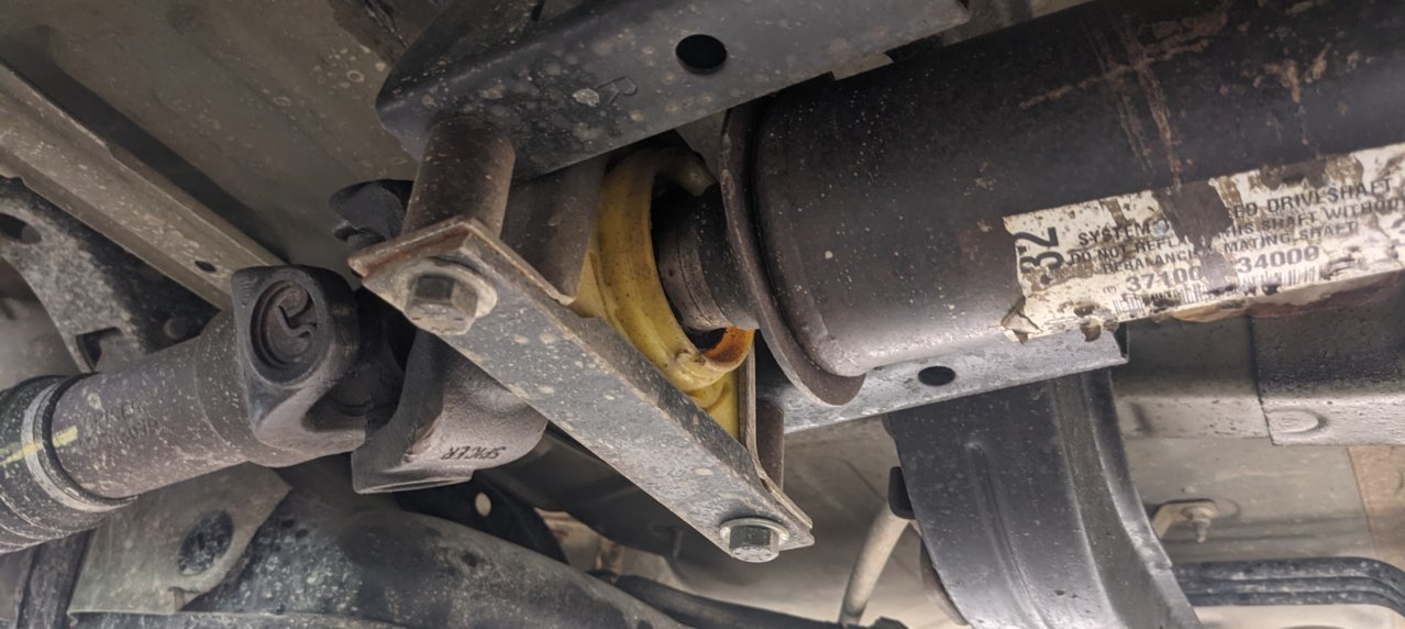

    Does this get you a better angle somehow? It looks like it’s in the same spot but just flipped.

    It does help with angle, but it's also housed in a poly bushing vs the factory bearing that has limited angle and disintegrates at angles that it doesn't like.
    I had to make a mount for this, but it honestly wasn't hard and I used the factory bolt holes but with the spacer you see included to get the clearance from the frame. Just longer bolts with a couple pieces of pipe for spacers and a piece of flat bar on the bottom. That's as high up as I could get it. Before this I was running a drop kit with the factory carrier bearing.

    yes, and if you throw the iedls center bearing in you should have zero driveline vibration

    Yeah it's the IEDLS poly bearing. I had to come up with a way to mount it, but the bearing comes already housed in the polyurethane bushing and installs on the driveshaft just like factory unit.

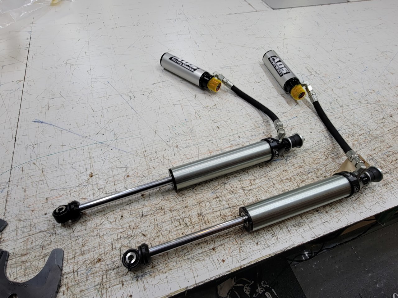

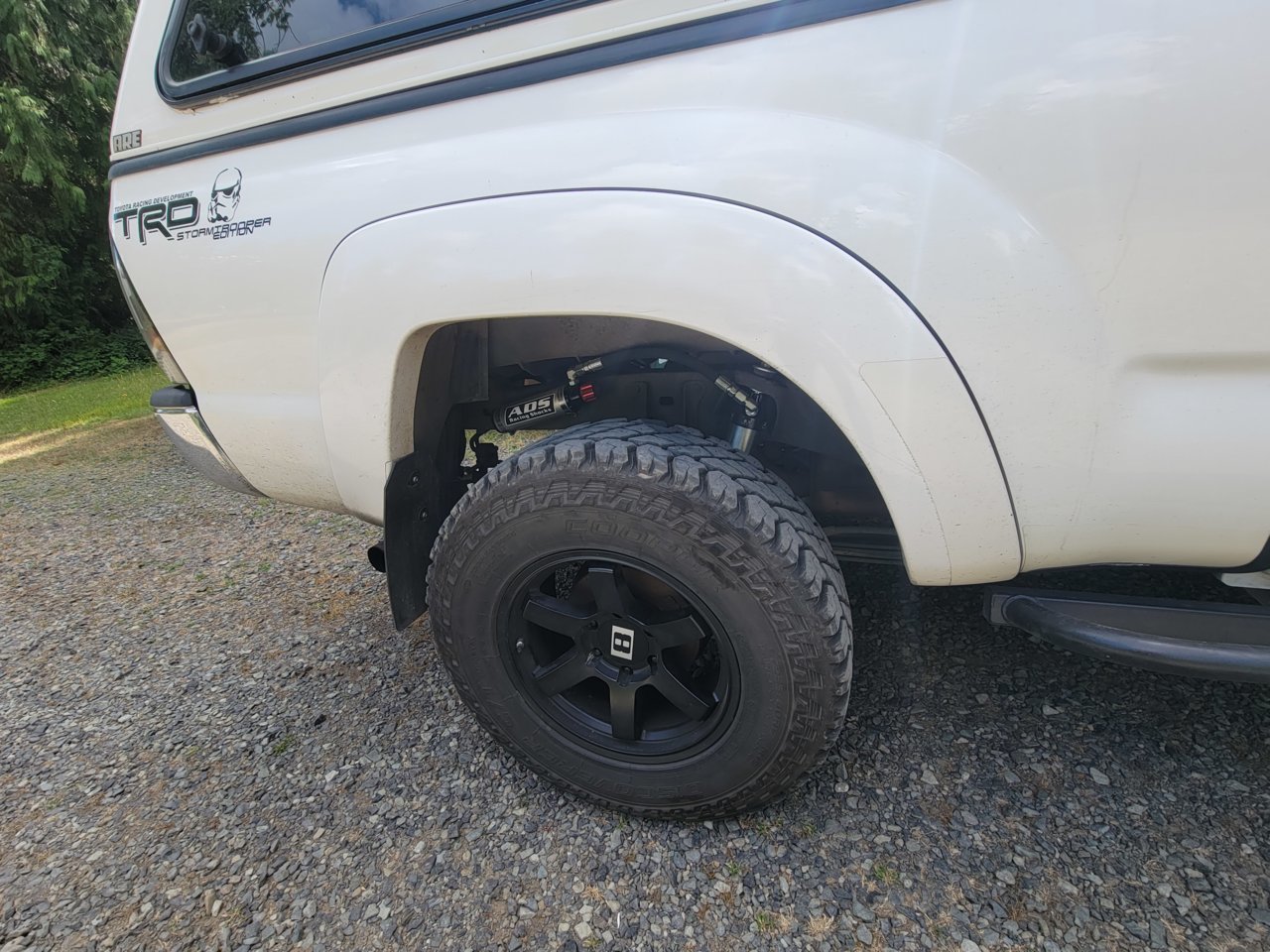

    I just mounted one upside-down. Drilled and tapped the axle housing to mount the reservoir

    Shocks went in fine, bit of a struggle compressing them enough but nothing an extra jack couldn't fix. If I could do it anyone could do it

    What are the compressed and extended specs on those?

    16.5 and 26.5
