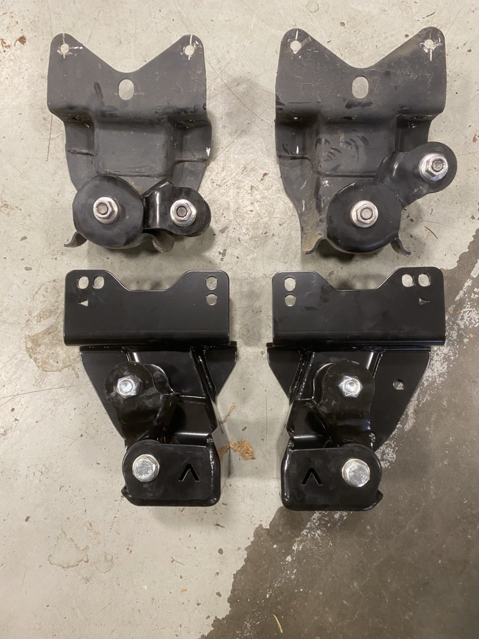

    Tomorrow may suck.

    I'm a bit clueless, what do these do?

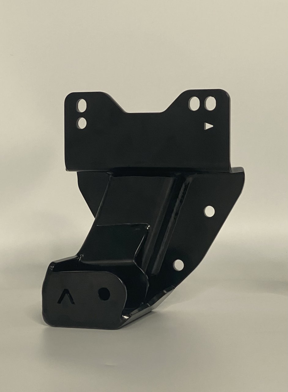

    Hammer Hangers?

    Stronger rear leaf perches. The stock rivets can be a pain if you don't have the right tools

    Watched a couple vids on swapping them out. I'd rather do those than my LCAs for sure. Grind the heads off, beat to a pulp with a pneumatic hammer, shouldn't be too bad

    Little under 2 hours and the hangers and rivets are out. Just need to drill the holes bigger and reinstall. I used a cutoff wheel to cut an x in the rivet heads. Air hammer to cut them flush. Bfh and a couple chisels to break them free from the frame and then a ball joint press to pop the rivets out.
