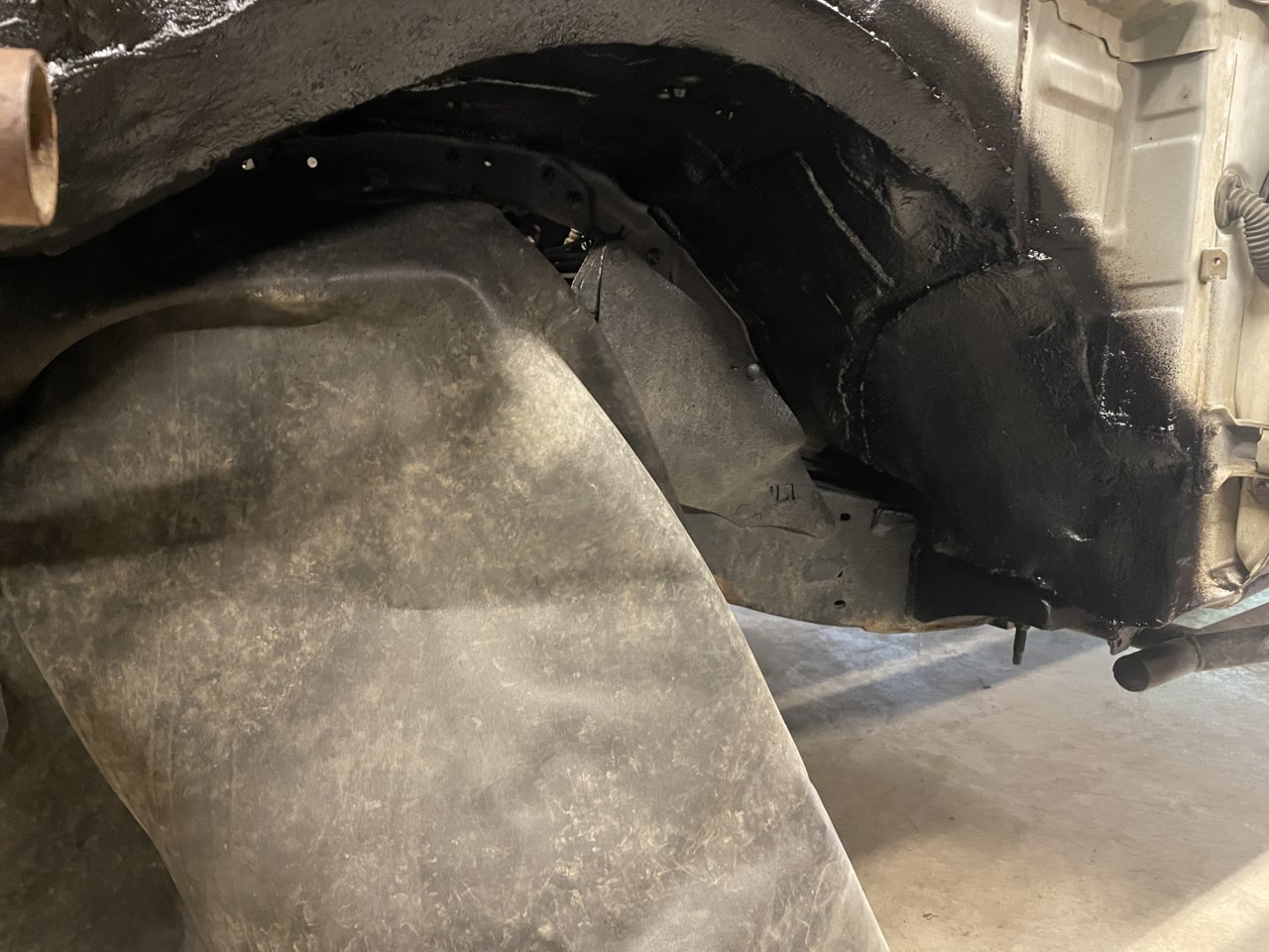

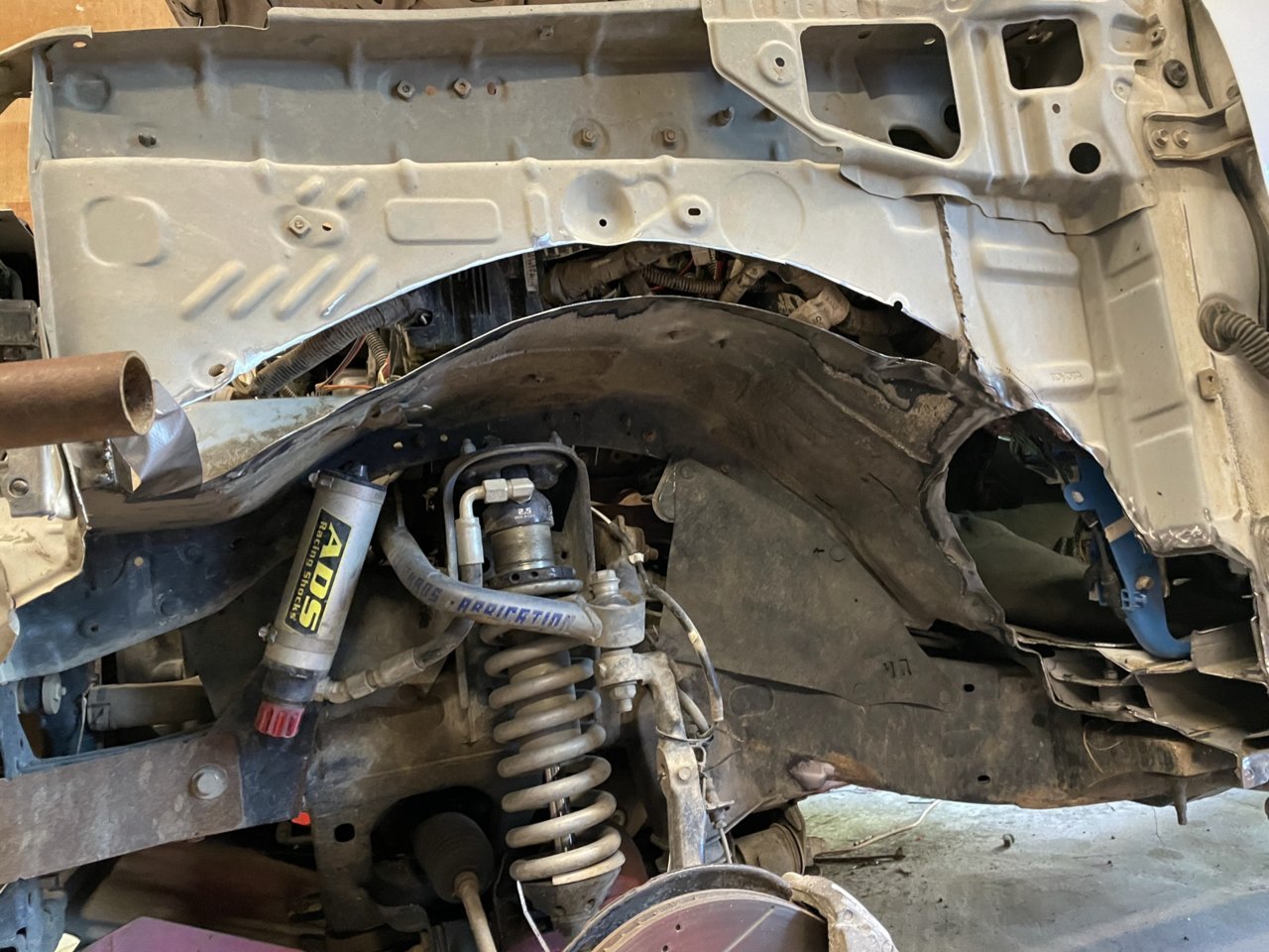

    Cut, test fit, cut, test fit, cut…still not done.

    I need to find some nice DIY fender liners now though. That gap in the fender where the styrofoam used to be looks wonky and dont want to clean out all the mud/dirt that will find its way in there...

    pics?

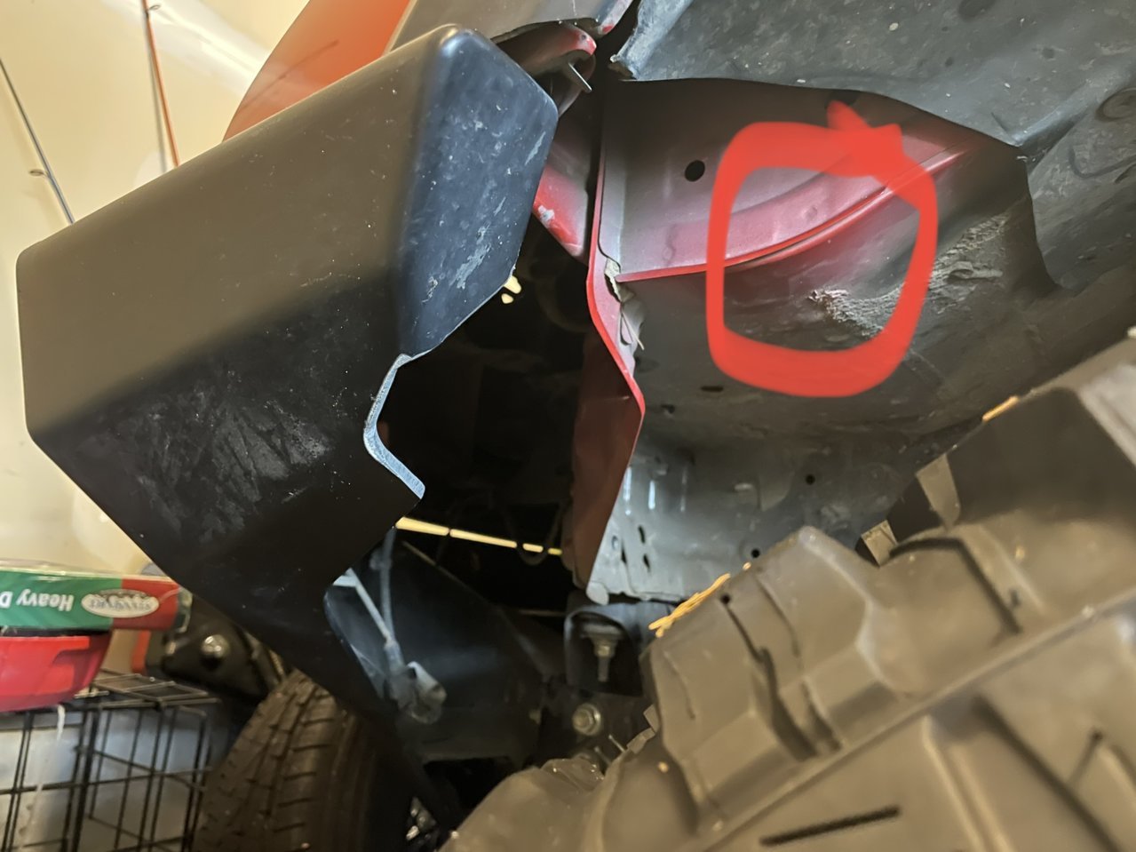

    I looked at the pivot subframe and it looks like a good solution but I pushed my LCAs completely forward and it helped me clear the rear of the fender and now I'm rubbing on this corner in the picture. I'd have to tub that section as well. JD Fab sells a replacement inner fender that eliminates that too but I don't want to spend like 3k just to not have rub at full stuff...that's halfway to a LT kit lol.
    I'm most likely going to lengthen my bumpstops by maybe 1/3" inch to barely limit the uptravel.
