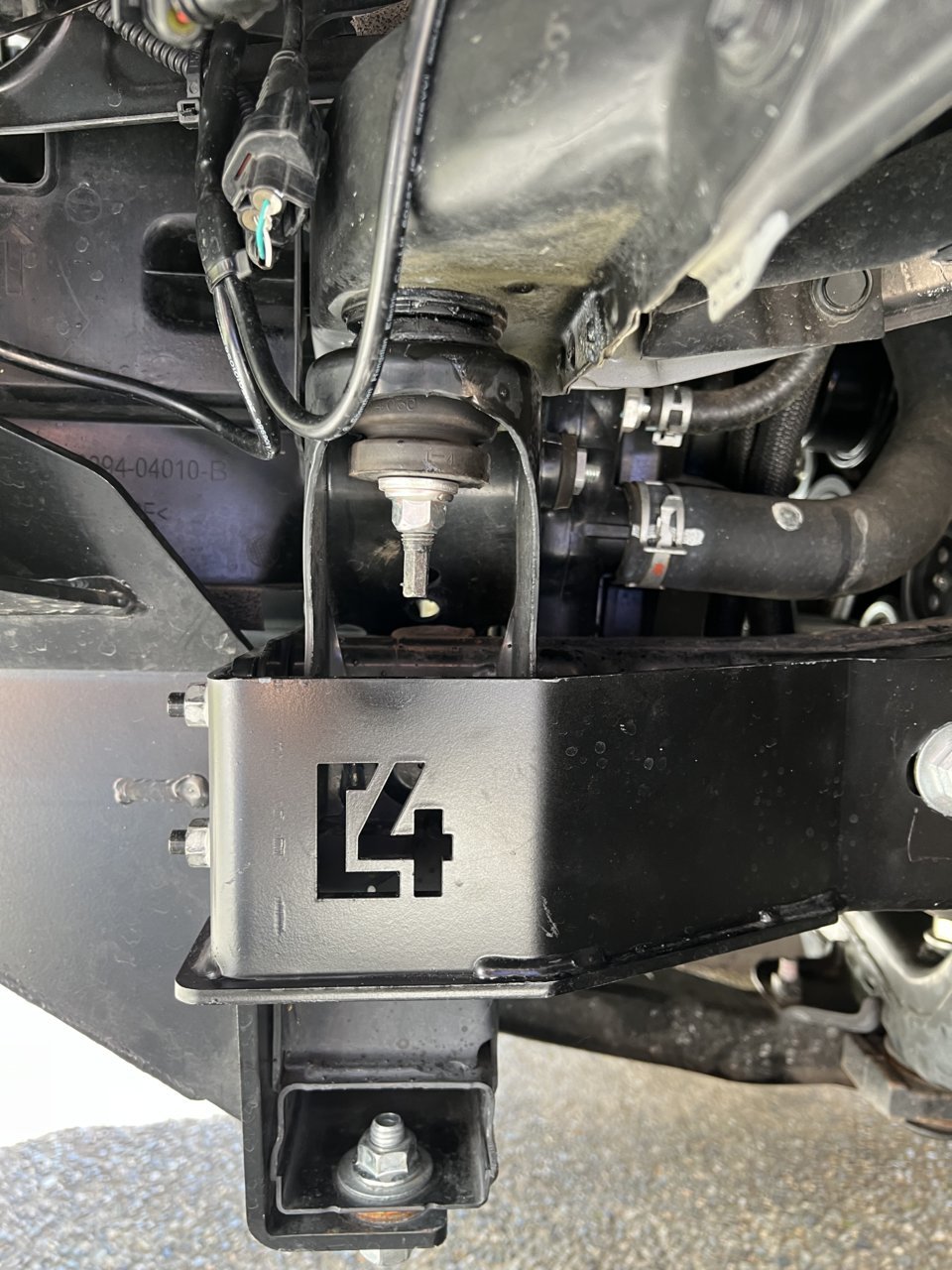

    So who is good at tracking down squeaks in suspension? Don’t know if it’s a shock ,bushings or something serious. Need some help.

    Can be tricky to track down but one way ive done in the past is to get a can of silicon lube spray and go component by component spraying them. Then drive around and see if the squeak changed at all. Hopefully you'll spray something and the squeak will lessen or go away and you'll know it's that. Won't fix it long term but has worked to figure it out at least

    Is this the front cab mount bushing?

    Yep. And it's probably dead (from being misaligned at the factory) and causing the noise.

    Looks like I’m going to have fun next weekend.

    Did you already track it down? I'd start with if it squeaks when you stand on your sliders and rock your truck back and forth

    Yes. Front rubber bushing. Above bumper mounting points. Ordered the set from Amazon and will replace this weekend. Hopefully not in the rain. Lol

    On my 1st gen and now again on my 2nd gen it was the spherical bearing of the lower strut mount on the driver side both times.

    I just did the poly bushings and it cured a ton of noise! I had some noise developing and swore it was just the lower uniballs on the shocks again, did the bushings for fun and trucks pretty silent now.
