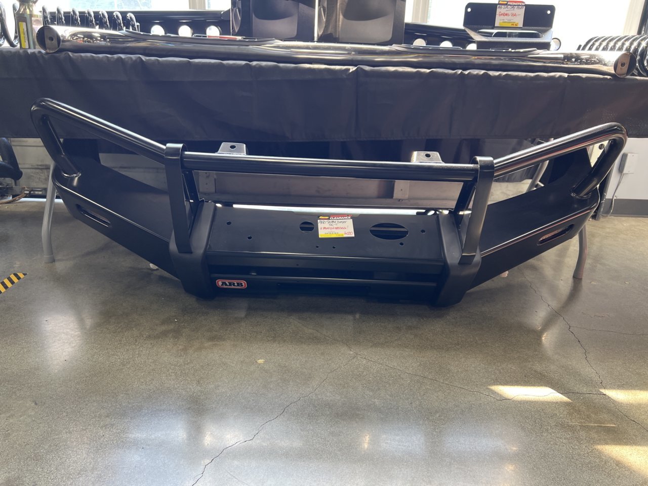

    ARb bumper at 4wp in lynnwood. 900$ brand new

    Does an 06-11 bumper fit a '15?
  20. Aug 25, 2022 at 4:20 PM
    Wyckedan
    Wyckedan Well-Known Member
    Oct 23, 2017
    #233922
    5,491
    Dan
    Woodinville WA
    2014 Stormtrooper AC 2009 Ducati Hypermotard 1100s.
    1 fully operational Death Star
    Mine is a 06-11, the mounting is the same, but the later years have a little bump under the headlights. However, I believe the design of the arb is different, one generation sticks out more. You'd have to figure out which
