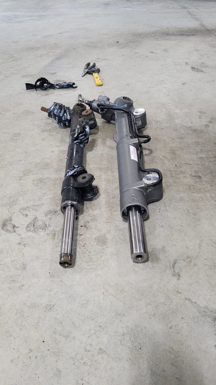

    You vs the guy she says not to worry about :rofl:
    Oem rack vs Tundra rack

    Curious how much work is required to install - my rack is leaking a tiny bit and I’ve been looking at this upgrade.

    That one looks to have offset bushings so it should be a relatively bolt in affair.

    Technically with these new ecentric bushings its all bolt in besides the steering column and some frame clearencing, which I think someone found a factory replacement thats shorter.
    The ecentrics are nice since I could swap in a factory rack if absolutely needed, yet I might have some pretty good jitters/vibration in the steering wheel since the rack will be solid mounted.

    Is this a 3rd gen mod only or would this fit 1st/2nd gen?
    Require a new P/S pump?
