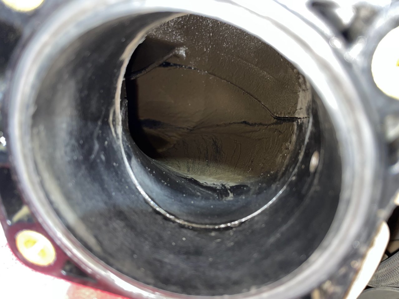

    You all think it's fine if past my throttle body looks like the mud pits at Tahuya?
    On0WAFChG_pXphUzhNXAW-cQ_INn8eR9-Jnl6bVp_966db615cfe66ecd7f564c971265debf5384b78d.jpg
    I can't reach any further in to clean it.

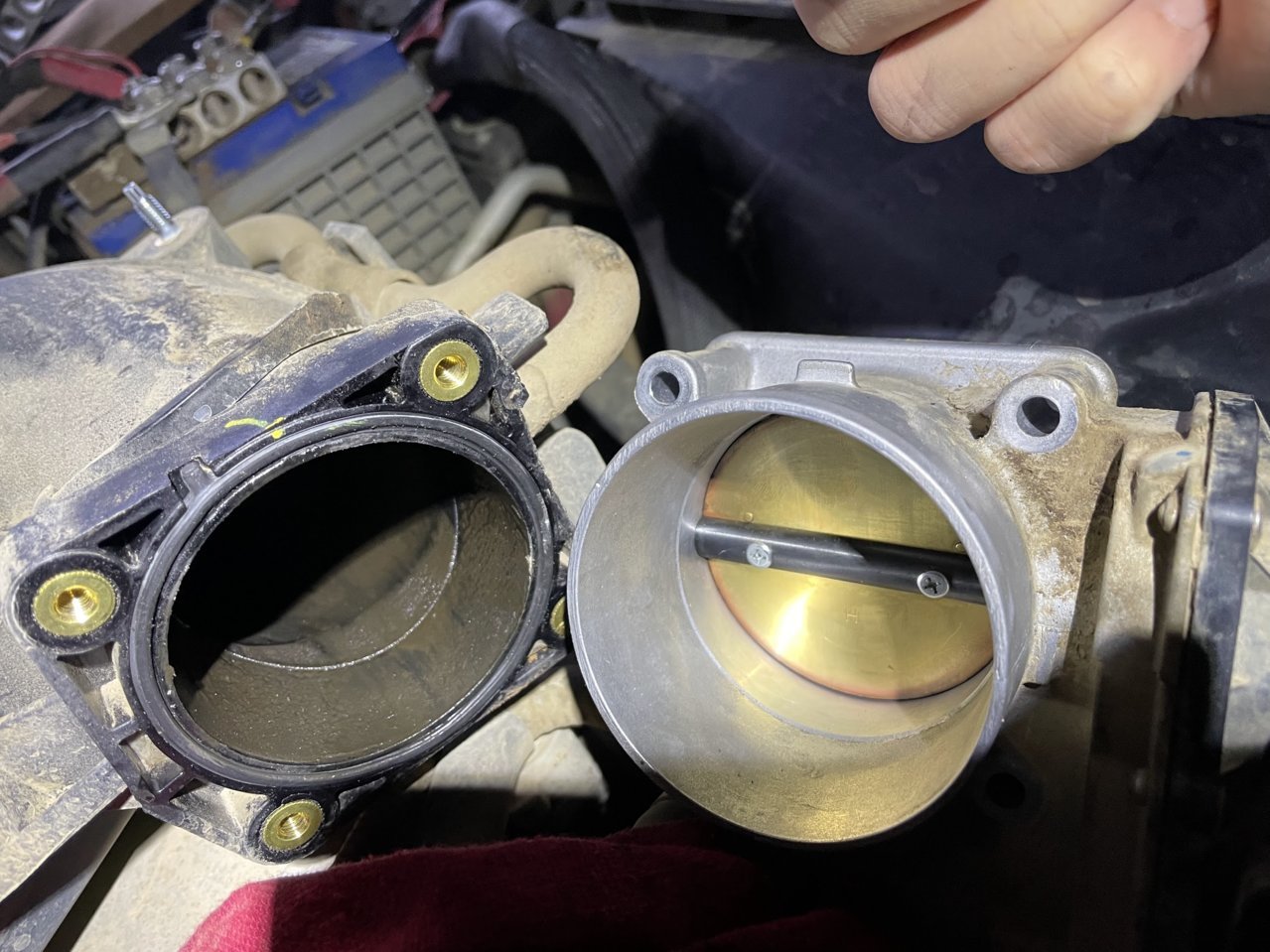

    Pic of it before (throttle body was cleaned):

    You should be asking how is mud getting to that point. Since it should be more or less "sealed" past the air filter
    If you have the TB off its only a couple more bolts to take the whole intake off and then you can clean it.

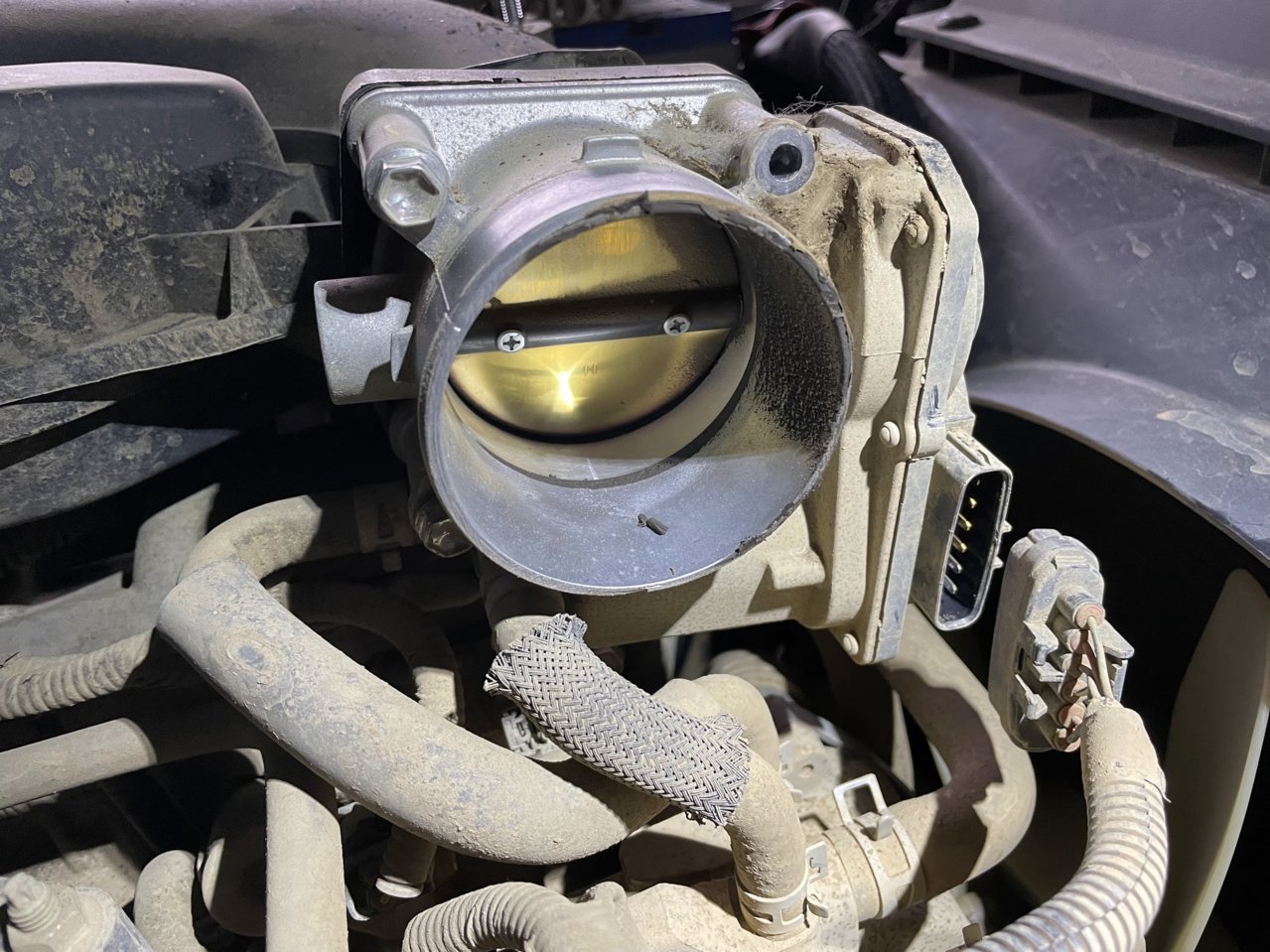

    Suprisingly not that dirty. I doused it in cleaner and didn't get a pic.
    This was throttle body before cleaning it:

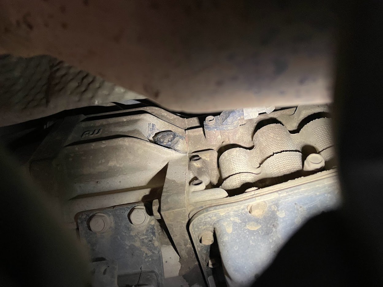

    @stonylaroux did you get that transmission plug fixed yet?

    It is probably not mud. It’s carbon from the PCV. That’s how it looks on black plastic with camera flash.

    Lol that's what I get for replying after a few drinks :) thought he said it was after mudding at tayuha

    This reminded me to actually go and check to see how it's doing. It's not exactly 'fixed' but it's good enough for me. The RTV silicone around the plug head is working! No signs of leaks. This is after multiple offroading trips and a road trip to Kansas and back.

    I was hoping it was something like this and not mud. I should have mentioned that wiping out that area was black soot and not mud.

    It’s hardly worth the effort to clean up. This is just what happens due to the PCV system. If you use good quality fuel and good synthetic oils, and change it frequently, you get less buildup, but it really doesn’t affect performance in a measurable way given port injection.
