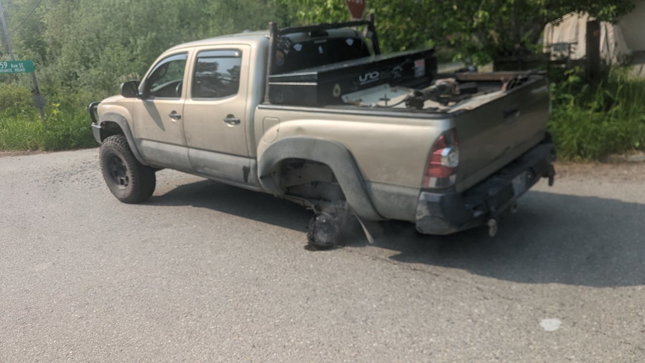

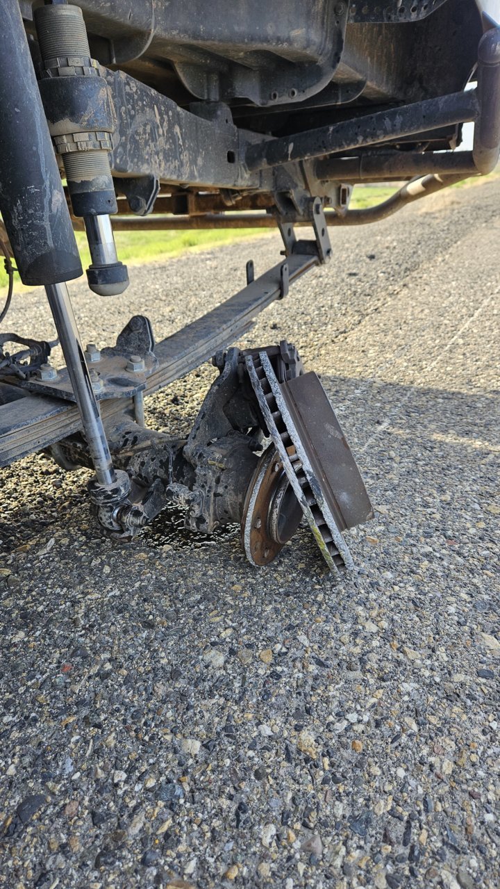

    IMG_6327.jpg How fucked are you? I have these.

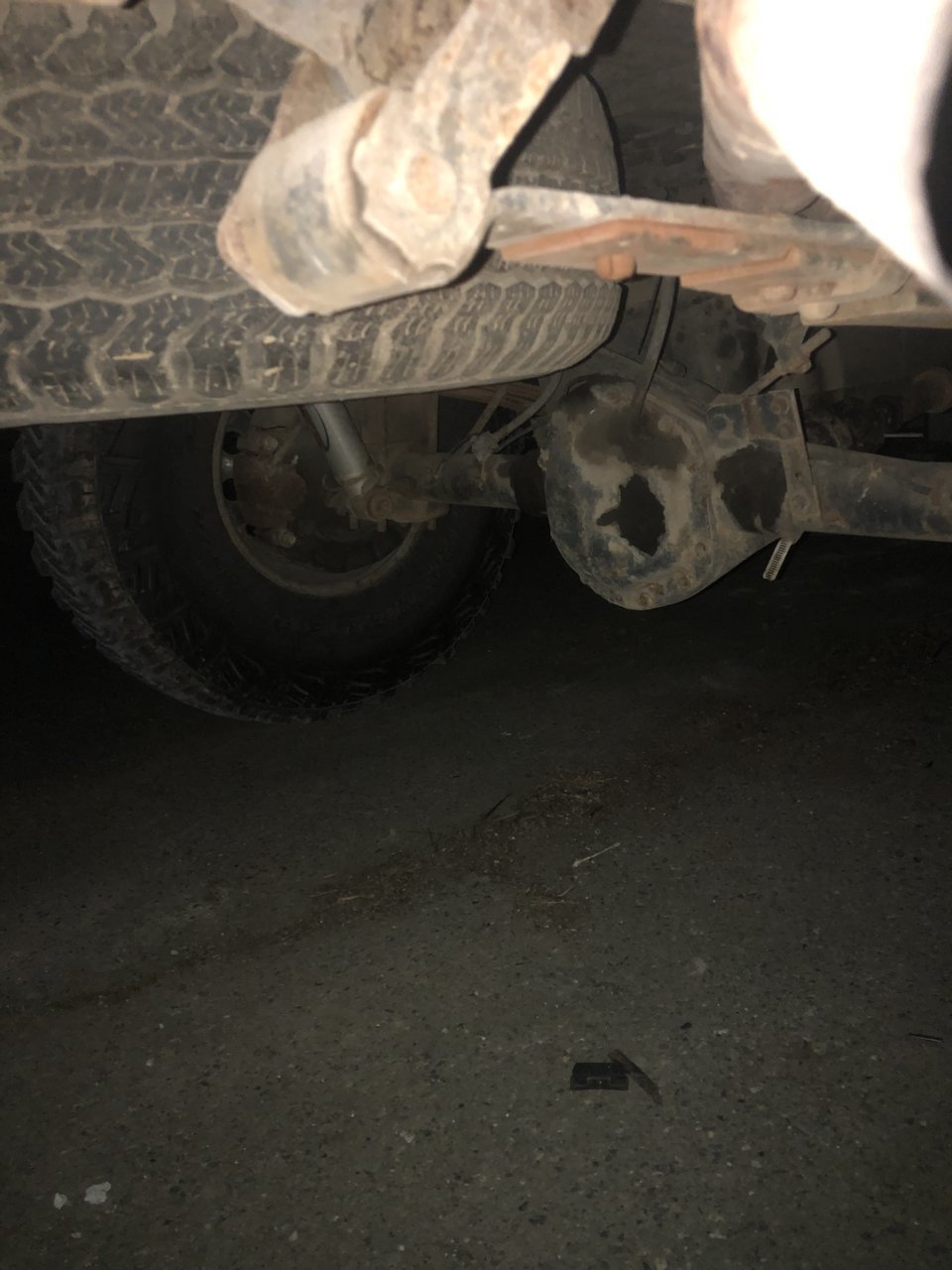

    Yes, it initially tried to pass me in the on coming lane, and headed right towards a 3rd gen Tacoma, when at the last second it caught some death wobble and veered directly behind me and into the ditch.

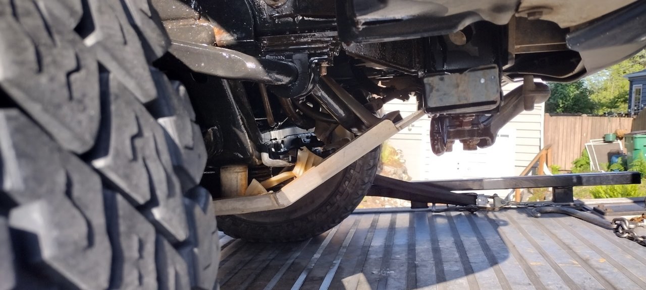

    Well at a minimum, I need new brake shoes, brake cylinder and backing plate. If you're not too attached to one of those half shafts, I'd be bout it. Just need to figure out what you want for it and a shipping/twexpress route.

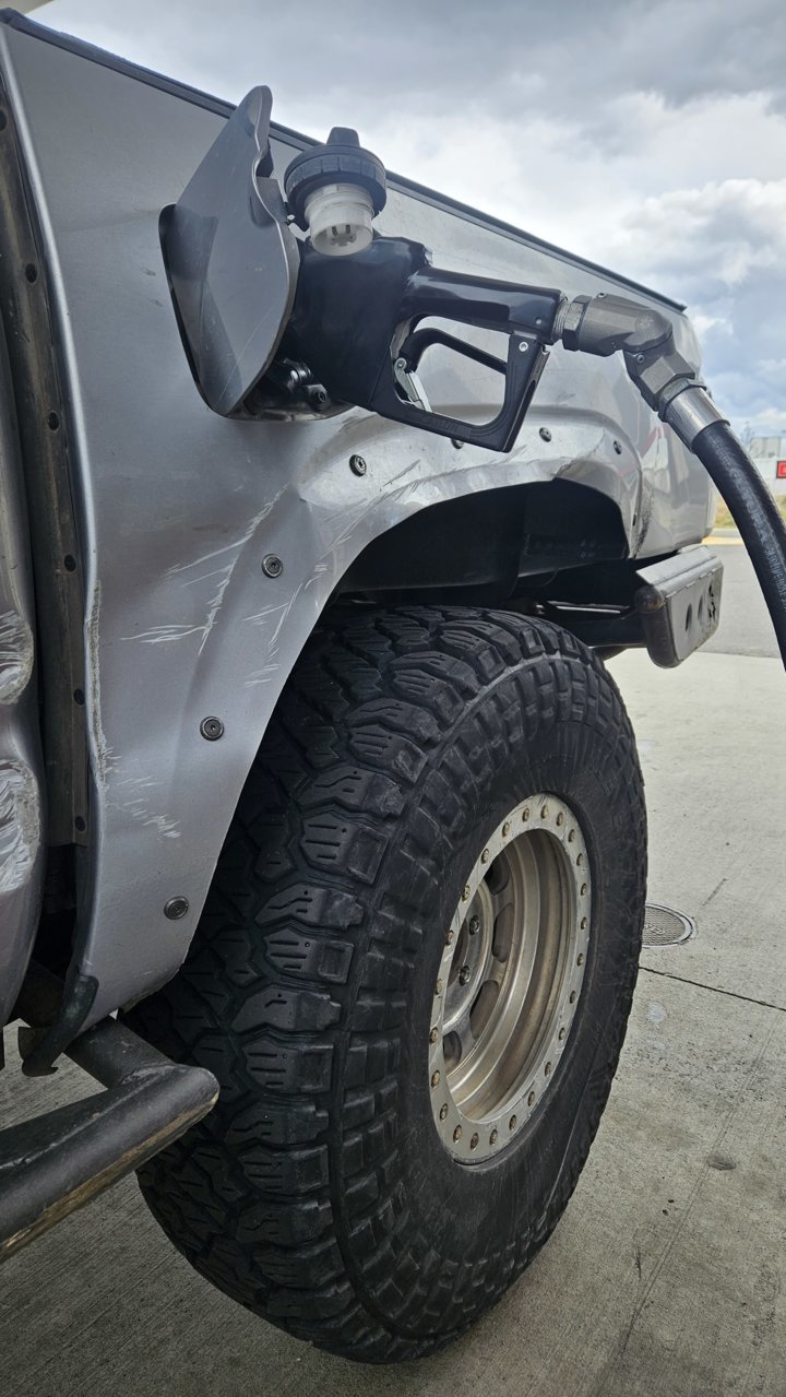

    #youarenotalone did the same thing on my way back from Colorado a couple weeks ago.
    User error, swapped in some of those extended thread lug nuts right before the trip, not checking to see if they were the right length.
    The extended thread bottomed out on the flange before tightening on the lug taper.
    Lasted a week of abuse on the trip there/trails there, finally gave out on the way home. Road side fixed it, and found the same issue on the other side so wasn't too far away from the other side letting go. Pretty wild ride, tire got sucked up into the bedside at 80mph, launched the rear of the truck in the air sideways and sent the tire into the oncoming lane. Thankfully it was 6am so there was no traffic on the road.
    Peeled the bedside up pretty good, but just kicked the bedside back in since i already toasted it wheeling haha

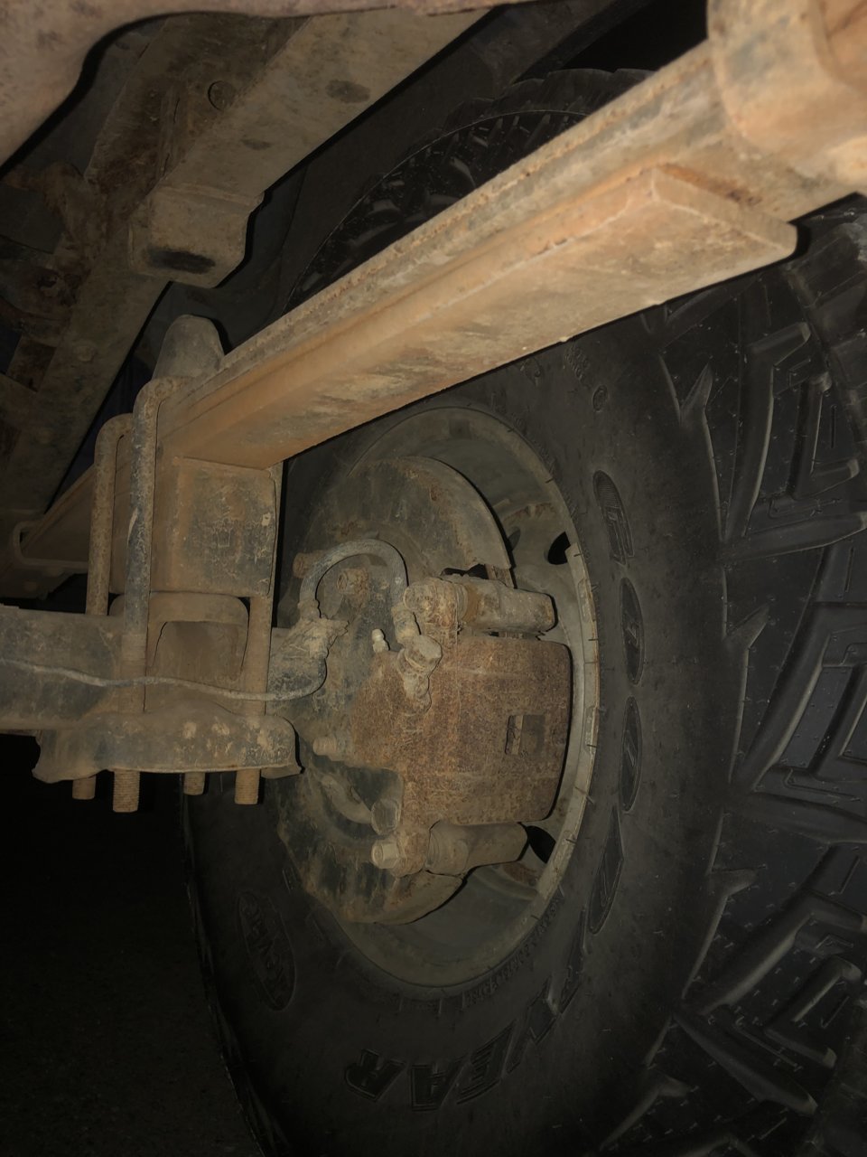

    Oh daaaaamn!
    What rear disc conversion is that? :anonymous:

    Its a trailgear disk brake kit

    Ordered the TG kit yesterday. I took one look at my gear oil soaked and mangled drum back plate and said "nope, not today, not tomorrow, never again."
    Then I went down a rabbit hole of what it would take to convert to a t4r tube end, press on a t4r hub, and then run t4r calipers and rotors. :sawzall::welder::spy:

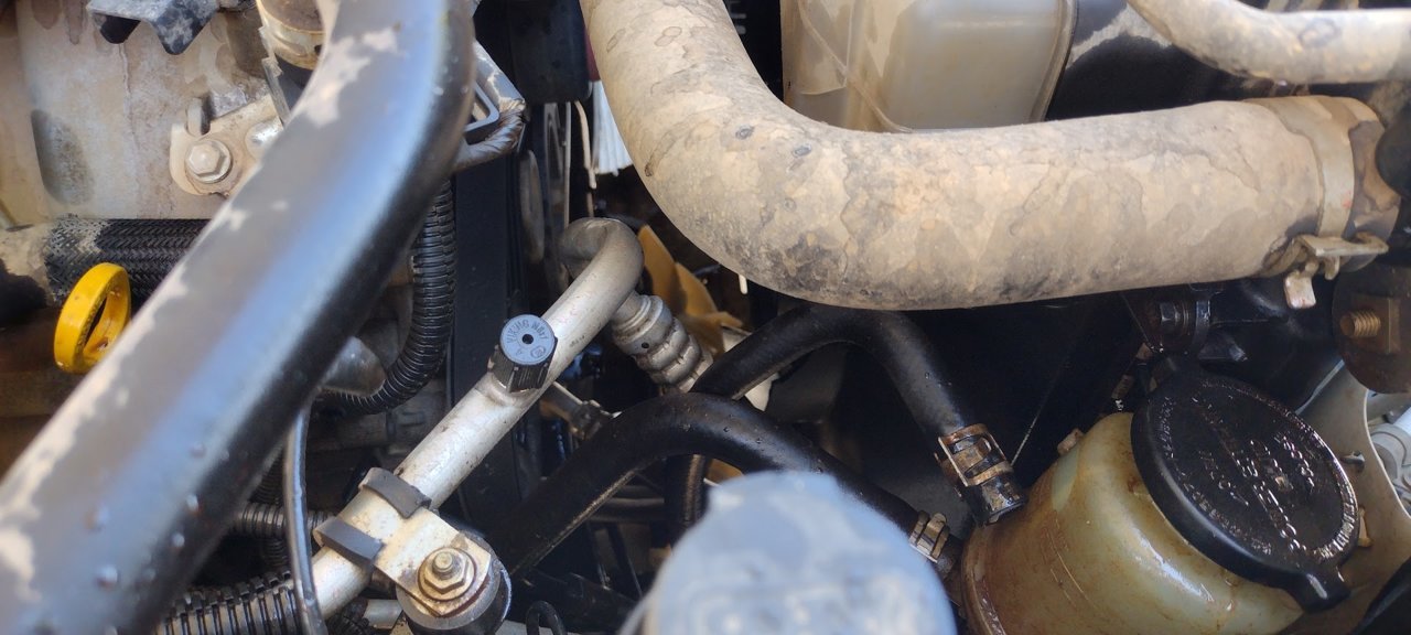

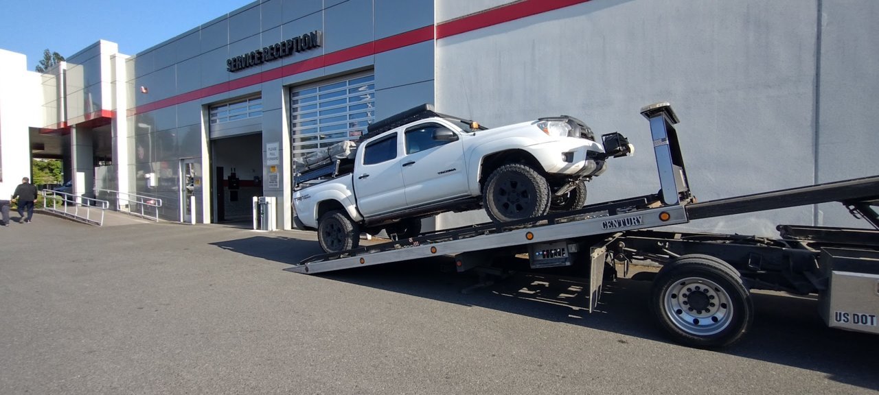

    Bad day yesterday, as I was getting onto I-5 near downtown Seattle, heard a loud noise in the engine compartment. Had to make it another 3-4 miles to get off the interstate.
    Pieces of my radiator fan...
    AJFCJaU3P6WuTh5B4s7e8-SNj0PGfChSkIoI70E9_1ec93edeed3490b883666f184990f3a338543a43.jpg
    AJFCJaXwE09PYu2ewBuut-W94AwSJjJo0MYAt8ve_3329bf9e79c35cd46feeb7457f81fb4712a80f21.jpg
    Radiator fan decided to disintegrate then wrecked the radiator plus some power steering lines. I'm getting an all-new radiator installed plus fixing the power steering reservoir and connections.
