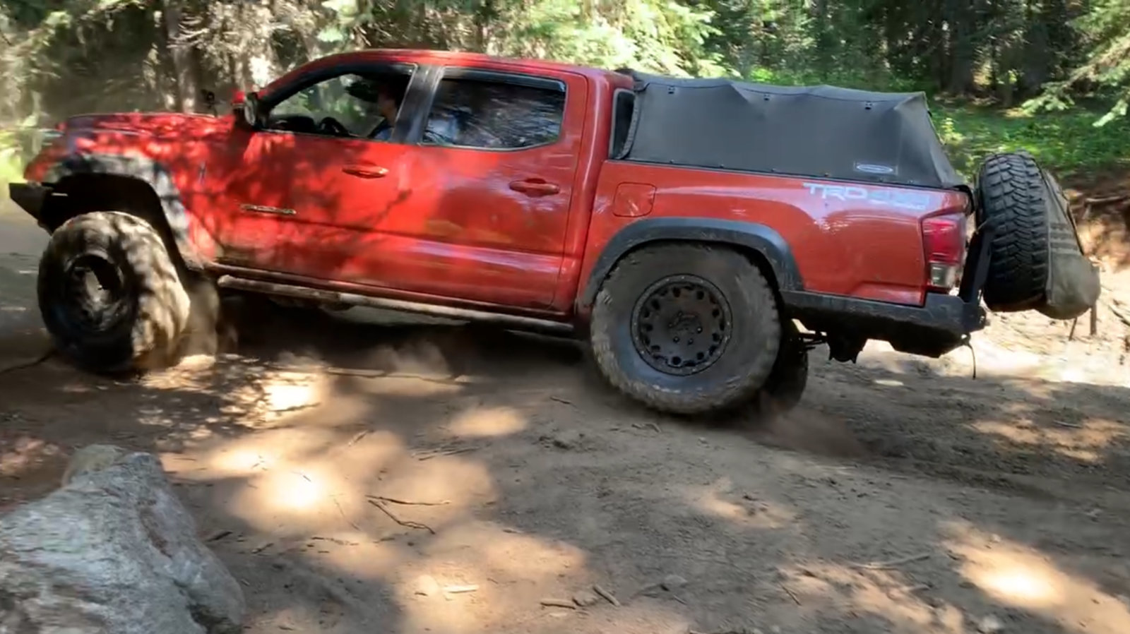

    Ah, makes sense. I think with 34s you might need to do minimal clearancing. On my buddy’s 2nd gen he had to do the pinch welds (which you should with 33s anyway), cmc, trim a little of the front fender and rear fenders.
    For the 35s, on top of what I did for 33s I had to do a much bigger cut of the rear fenders and get rid of the bedside supports. I still rub reversing in full lock and up front I rub the inner sheet metal at full stuff…need to tub it.
    Rears at almost full stuff here.
