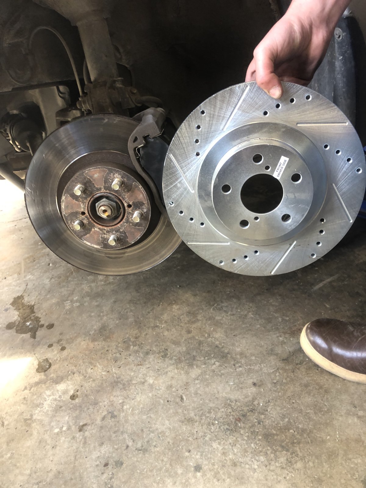

    Do we have a Subaru guru amongst us? I have a 04’ Legacy that came with a set of Power Brakes pads and rotors in the trunk Part # JBR957L and JBR957R. Problem is these brakes are 11.5” and stock are close to 10.5”. Not sure if there is some mod where a different model’s caliber will clear or the previous owner fucked the dog ordering parts. IMG_7804.jpg

    I'm new to Subaru. Not sure if this helps but the compatible list for that part number includes 04 Legacy GT.
    https://www.buybrakes.com/powerstop-jbr957-autospecialty-uncoated-brake-rotor
    edit: how is the caliper going to fit over that though? If it's not a GT then maybe GT calipers? if you want to go that far. meh dunno

    From the little bit of digging I’ve found out 16” wheels can clear and the car has 16’s. We bought the car from an estate sale just down the road from us. It belonged to a little old lady that was a farmers wife. It has every gas receipt and maintenance receipt in the glove box. Its entire life it was serviced by Skagit Subaru. Even receipts for headlight bulbs installed at the dealership. It’s kinda crazy to me it came with a set of WRX pads and rotors from stop brakes. I’m not 100% sure if the wheels came at 16” stock. We bought it for $2k and 130k miles. It’s a great little car. The receipt trail stoped 3 months before we bought it.

    I have it sorted out now. I know way too much about Subarus now and feel icky. 06-07 WRX brakes are 4 pot and fit the early gen Subarus. They need a 17” wheel to clear but 06-07 wheels don’t fit because the lug spacing is different. I put on a 02 WRX 2 pot caliber and it cleared the stock 16” wheels. Hopefully tomorrow after I’m done I can meet the MIB and have them flash my memory back to an innocence Toyota enthusiast.

    Almost forgot to update. Everything went together easy peasy. Zero issues and the car stops on a dime. Not exactly what I thought I signed up for yesterday, but WRX brake conversion is done. Lol wish I had known two years ago it was the “wrong rotors” and was a little more prepared. Not after I beat the shit outta the old rotors breaking them free at 4:00 on a Saturday.

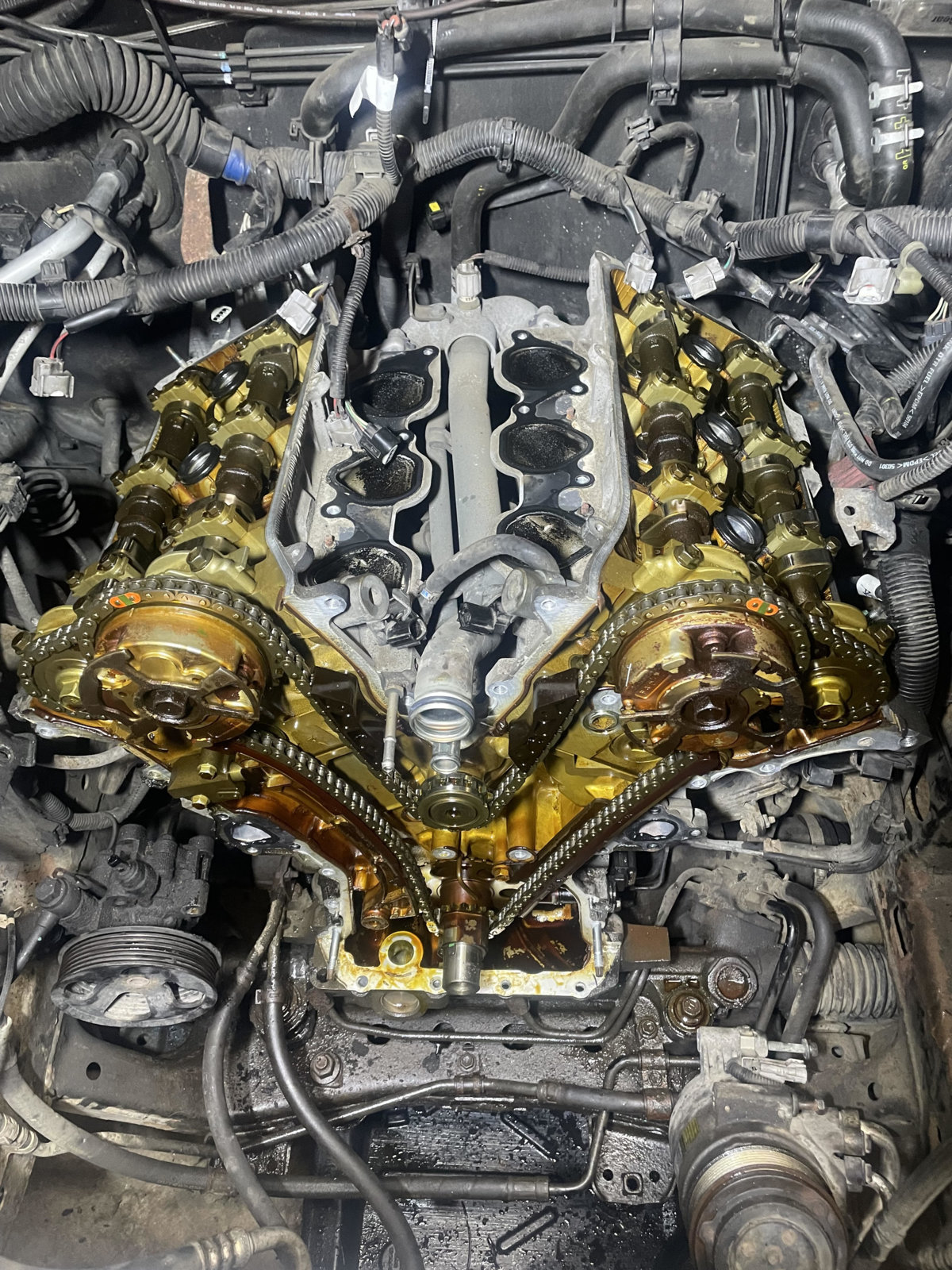

    well im about 90% torn down to get to the head gaskets, just have to get the head bolts out then reassembly. Also putting in new urd cam gears, water pump, plugs, filters etc.
    fun stuff

    How did it take to get to that point?

    8 hours maybe? the only thing that has fought me so far was a ac compressor. I also took the cams and timing chain stuff off after I took this picture.

    Must not have the little smog pump on the passenger side. Those are kinda special to get apart.
